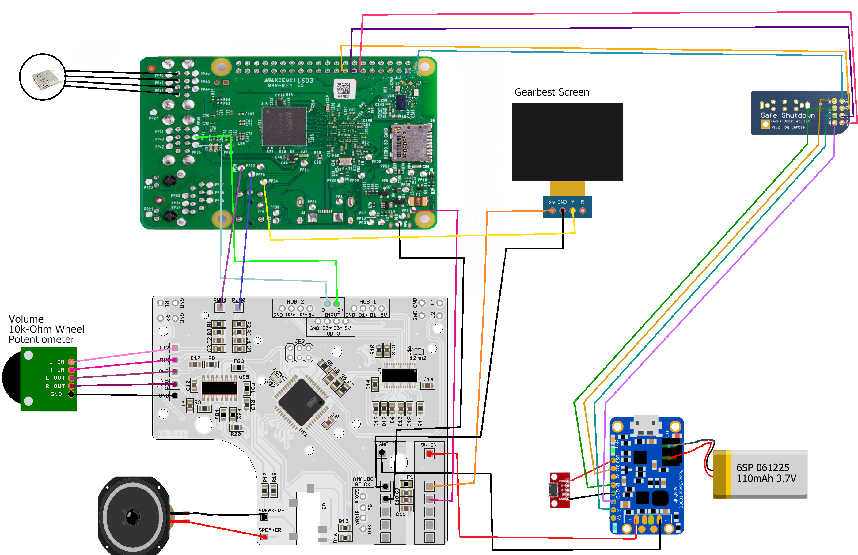

Hi everyone I've been seeing so much another people builds and finally I have convince my shelf to make it my own.But I have a few questions of that and i was thankful if you can help me.
First of all i have seen a lot diagrams and i have made my own.I think that all is good but i prefer to have another opinion about that.
Then i was wondering what screen should i use. I have seen one of gearbest (that was used for @rodocop in one of his builds https://www.gearbest.com/development-bo ... 29447.html ) that dont need any modification or use the ones that use @wermy and @Chedda(https://www.amazon.es/gp/product/B0056W ... bw_c_x_2_w) .What do you recomend me?

I like the gearbest screen, since you need no modification for it to work out of the box, while the amazon screens, are random, once you open up the screen you'll see what kind of board you will get.
As for the wiring diagram, it looks good, i've never used a pi3, but from a quick glance I think it's good. I assume you have double checked the test pads for the pi3.
If you're using a pi3 it will for sure getting hotter than a pi zero. I would put a heatsink on it for sure, and if you can find a small fan, similar to what kite uses in the CM3 boards that would be helpful too.

I will surely use the one you have recommended.
About the pins I have reviewed them and I do not think they are wrong.
And about the heatsink i'm looking for one in aliexpress that convinces me.
Thank so much for the help and for answering so fast
