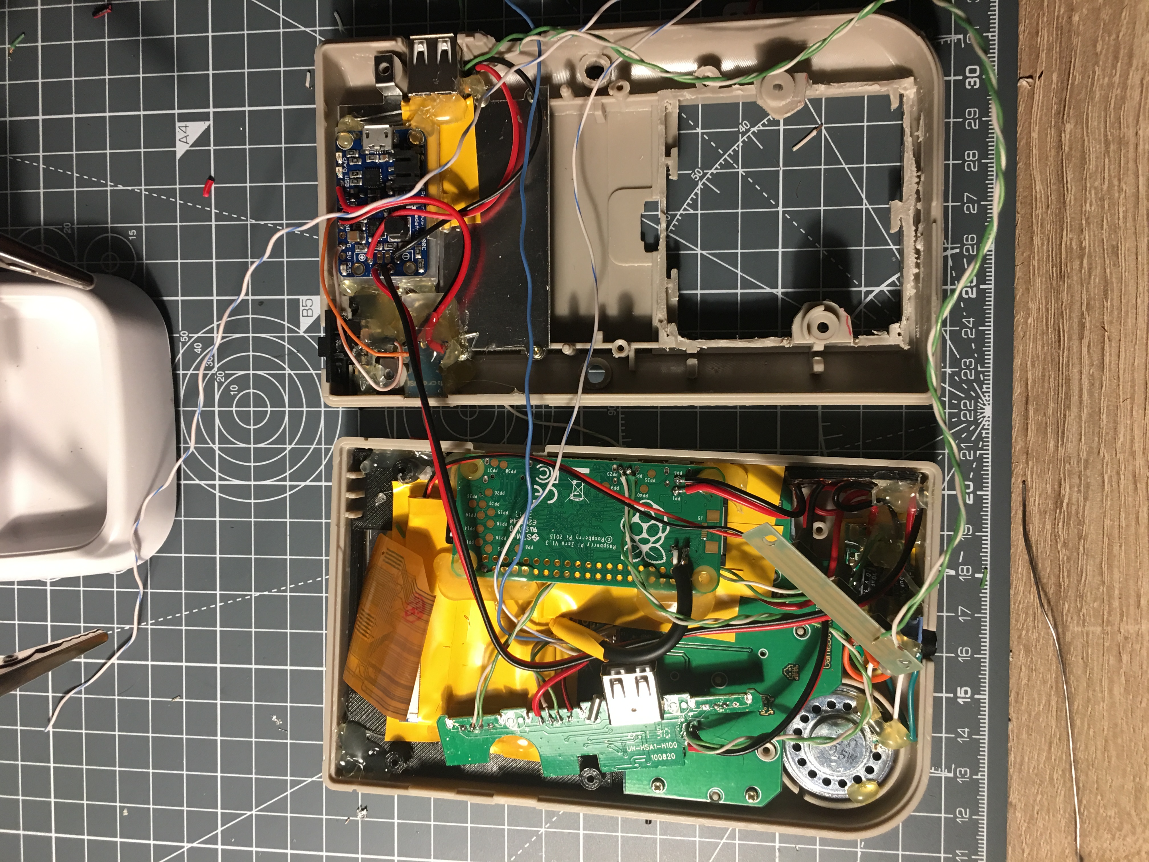

Picture attached.
Sorry for the mess, the external USB and the L/R buttons not connected on the picture.
