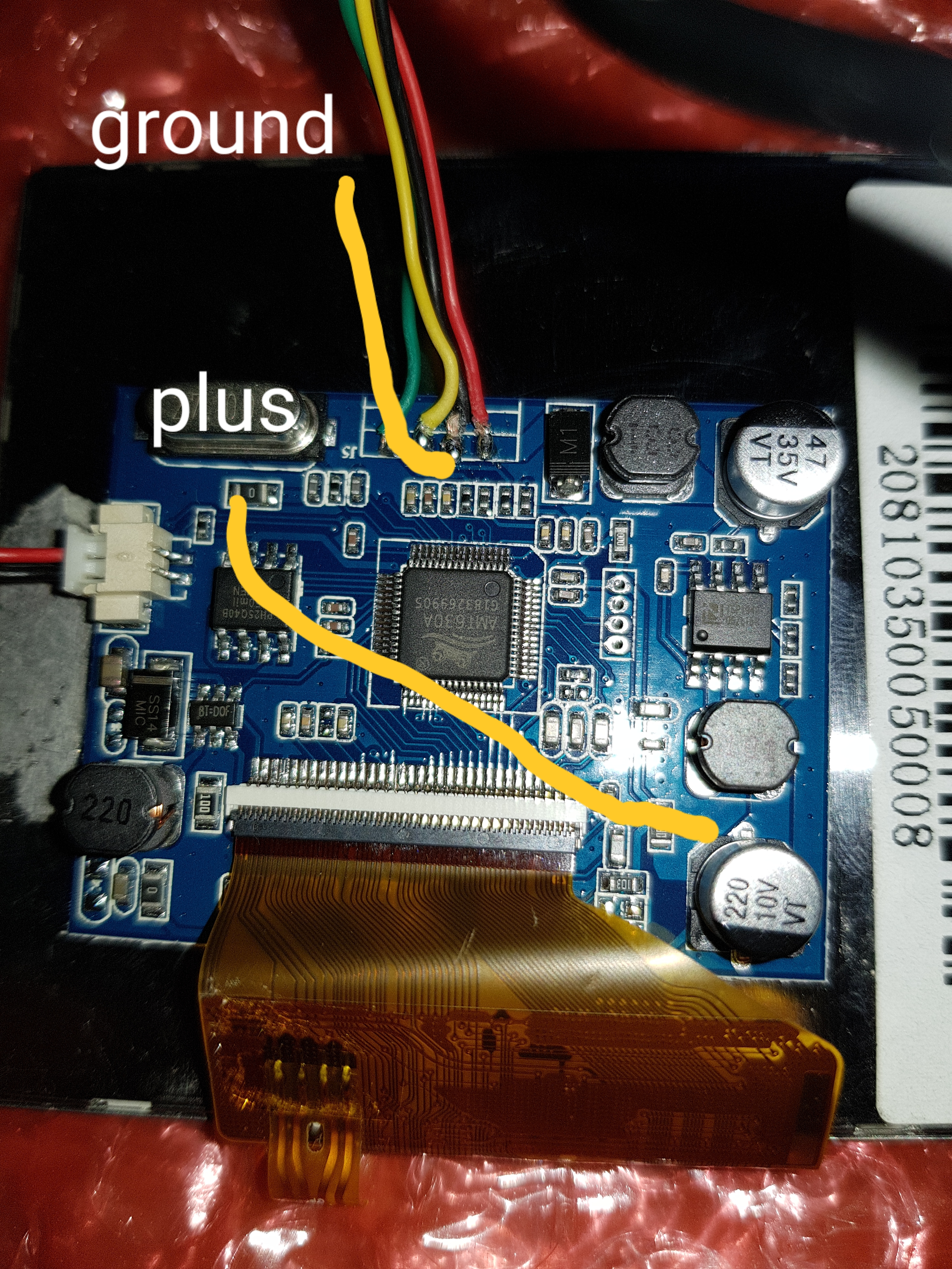

What you measure on the chip output could be some rest of AC ripple. Try to measure on the big capacitor on the picture bottom. There you should get something closure to 5V. You can inject your 5V as well on this cap. Take care: if you measure something close to 3.3V DO NOT inject 5V there!

Thanks for your Reply. Im a Newby with this. But i will Try this today and give Feedback. I have just one question left: with wich voltage do i have to test this? I guess i must try this with 12v and when i get 5v on the cap i must solder the output to the plus on the board and Switch to 5v input with(hopefully) nice picture in the screen whitout flickering correct?
Thanks again!
EDIT: Ive quickly checked this.with 12v input there are 4.01V on the cap output. Dont know if this a good or bad value. I will wait for an answer till i Continue.
Thanks again!
Re: BW 3.5 TFT LCD - 5V modification
Hi,
Ive put the ground on the board ground.was this wrong?
I measure anywhere on the board either 12v or 4v. It looks to me as if this board runs with 4v. Is that possible? If so, can the screen operate with the 5v from Rasperry?

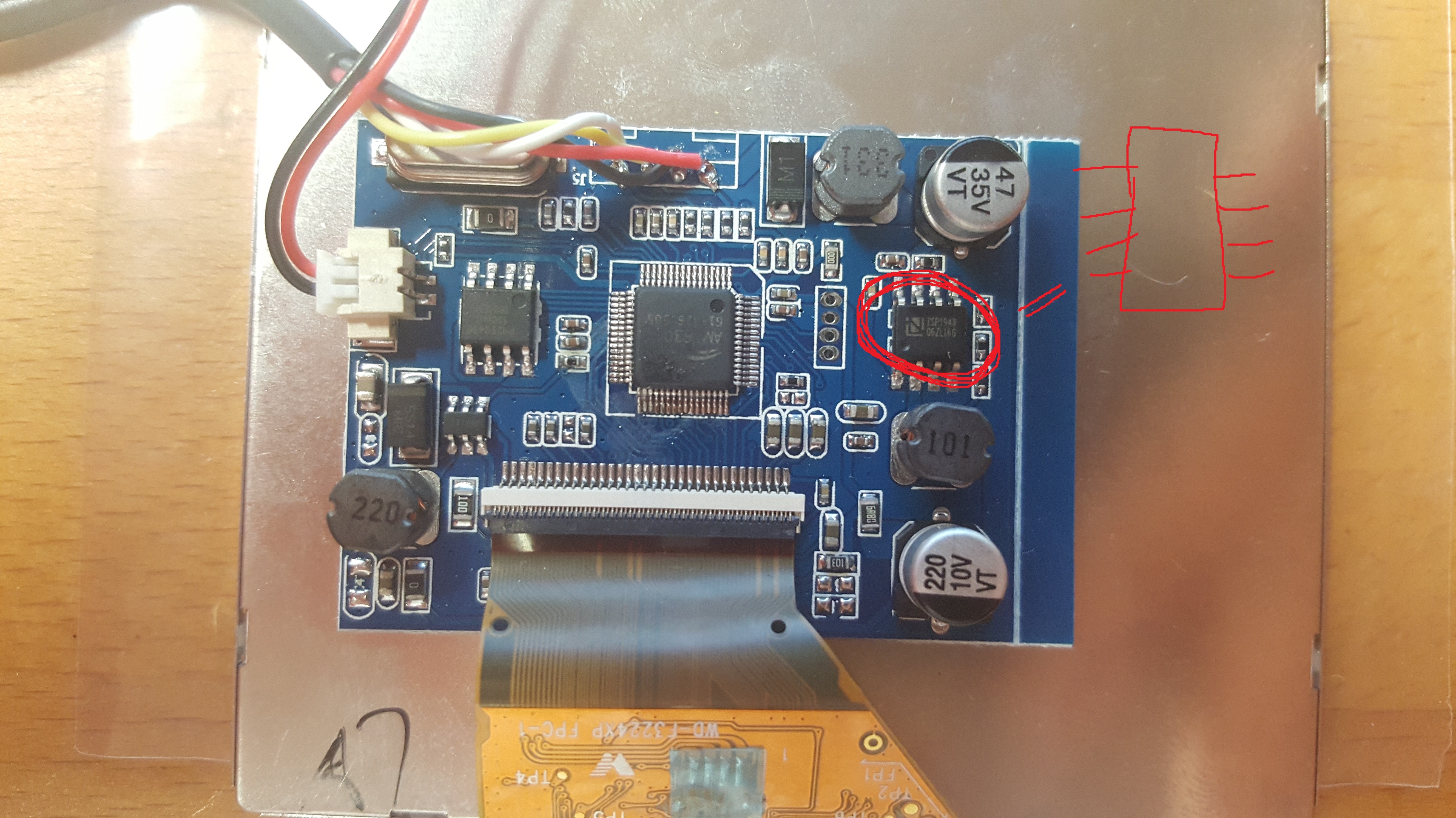

Sometimes voltage drops if there is load on the line -- I wouldn't be surprised if the 4v you're measuring is really 5v, but there is a load on it (e.g. it's driving the screen, so it drops a volt). -- You could try running the screen directly off of 5v -- and if it's dim, try temporarily bridging to one of the 4v spots and seeing if it gets bright (e.g. with an alligator clip or something).
Note 1: if it doesn't fix the dimness issue, disconnect it immediately, those are not the traces you're looking for!
Note 2: Beware, that could totally let the magic smoke out of the device, especially if you're not careful, so do it at your own risk...
Note 3: the little 8-pin DIL chip (two components above the big tin can cap that you're probing) looks a lot like the voltage regulator from some of the mod guides -- I would probe some of those pins to see if any of those are 5v... / there's also that 35v filter cap above (probably just a buffer for the input voltage, but it's worth probing).
