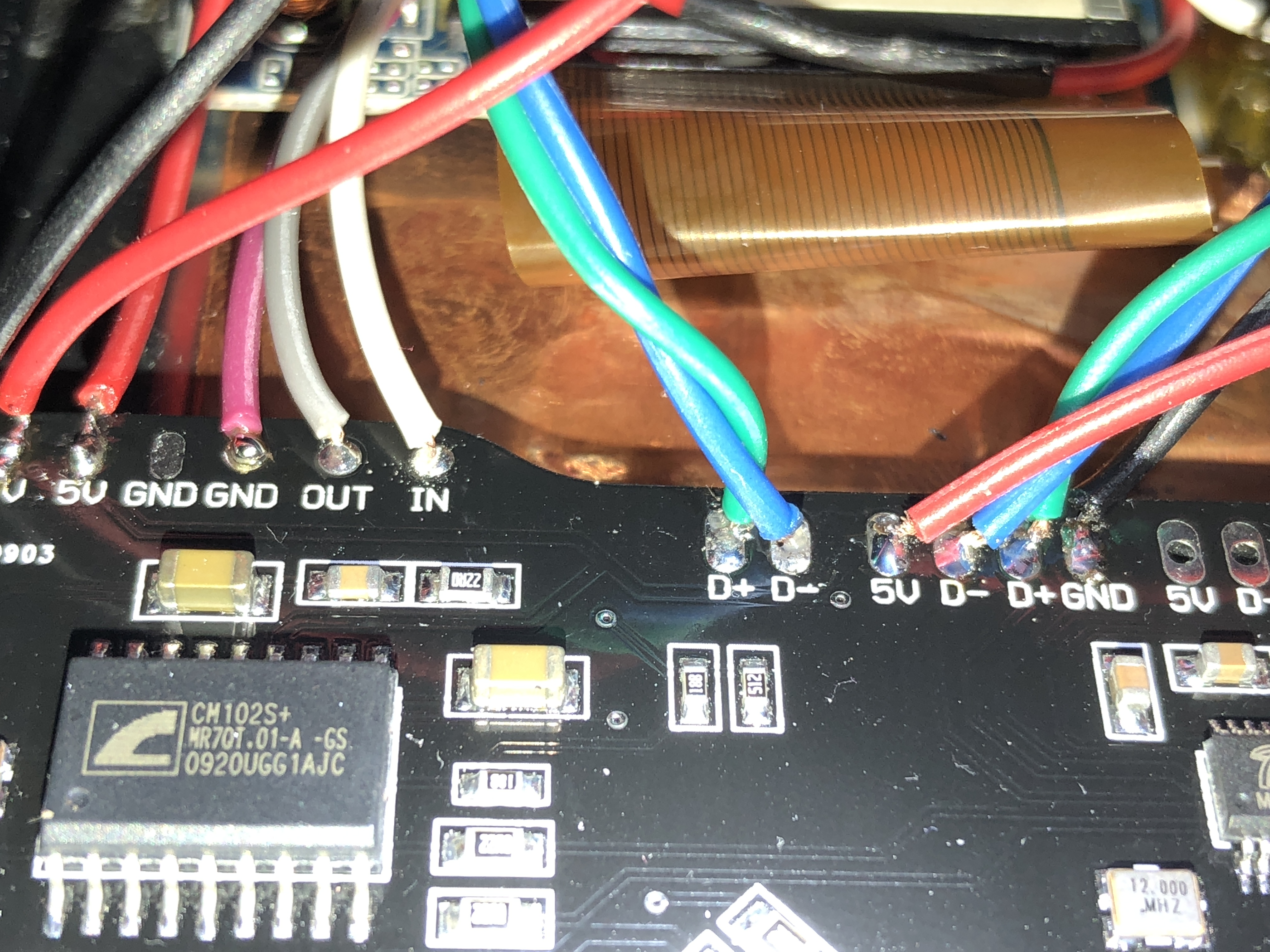

I got nothing. If anyone can help, I'd appreciate it. Here's a picture if it helps. Thanks again for any direction you guys can provide!

Also. Let's see some nice clear pics of the D+ and D- on the pi and pcb. Do you have a multimeter? Check to see if there is continuity between D+ and D-.

Also. The IN/OUT/GND to the volume wheel, the GND wire does not look like it is soldered at all. Is it?

Thanks for the reply! I removed the addition to my config.txt, and the volume wheel GND was soldered, but it didn't come through the hole. I added some solder there.rodocop wrote: ↑Sat Dec 22, 2018 2:29 pmRemove this from the config.txt
That is ONLY used for pwm audio. Tinkerboy uses USB so it is not necessary.
Here are some pictures of the D+ and D-. Tested for continuity, and it seems fine.
