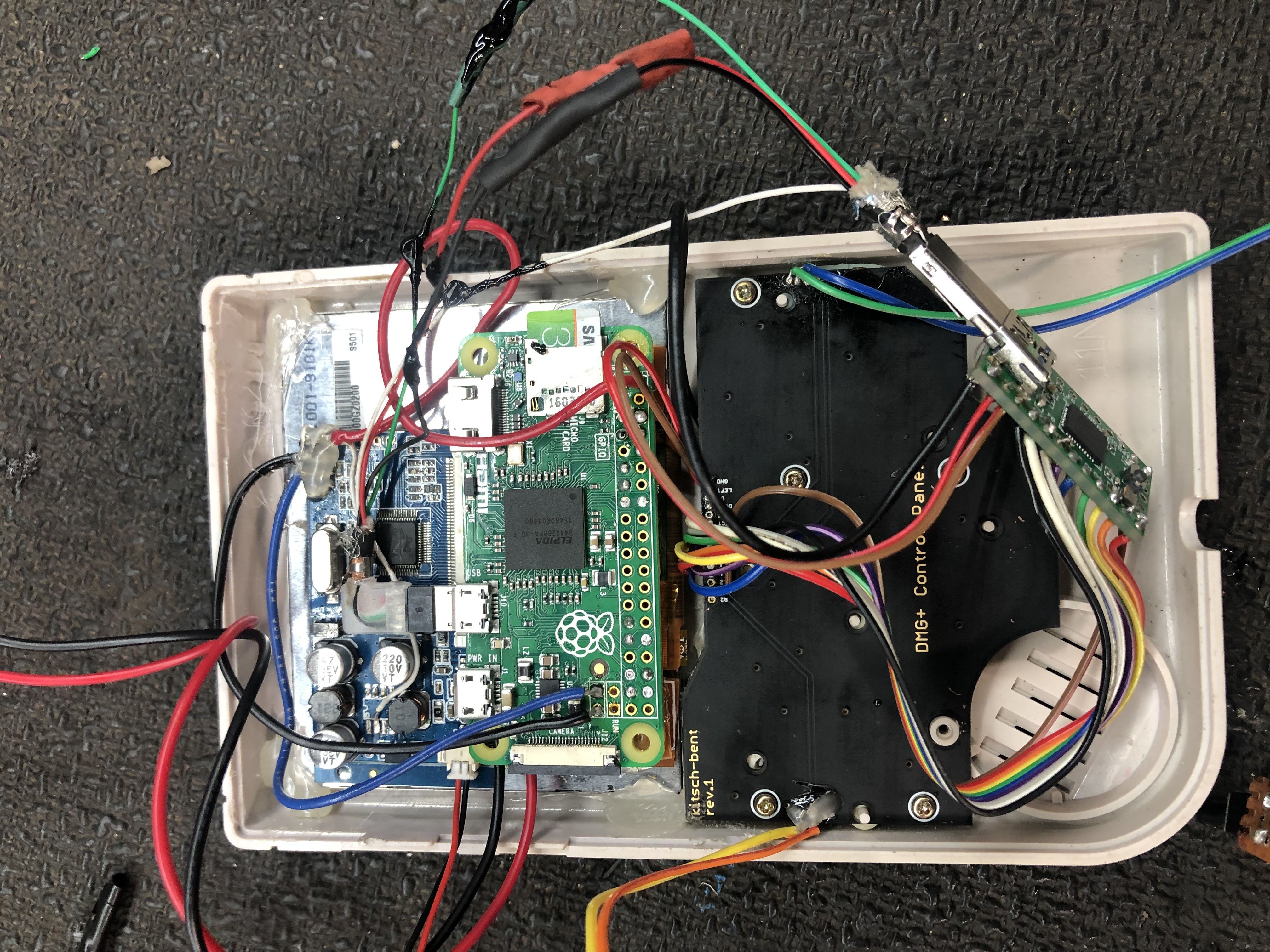

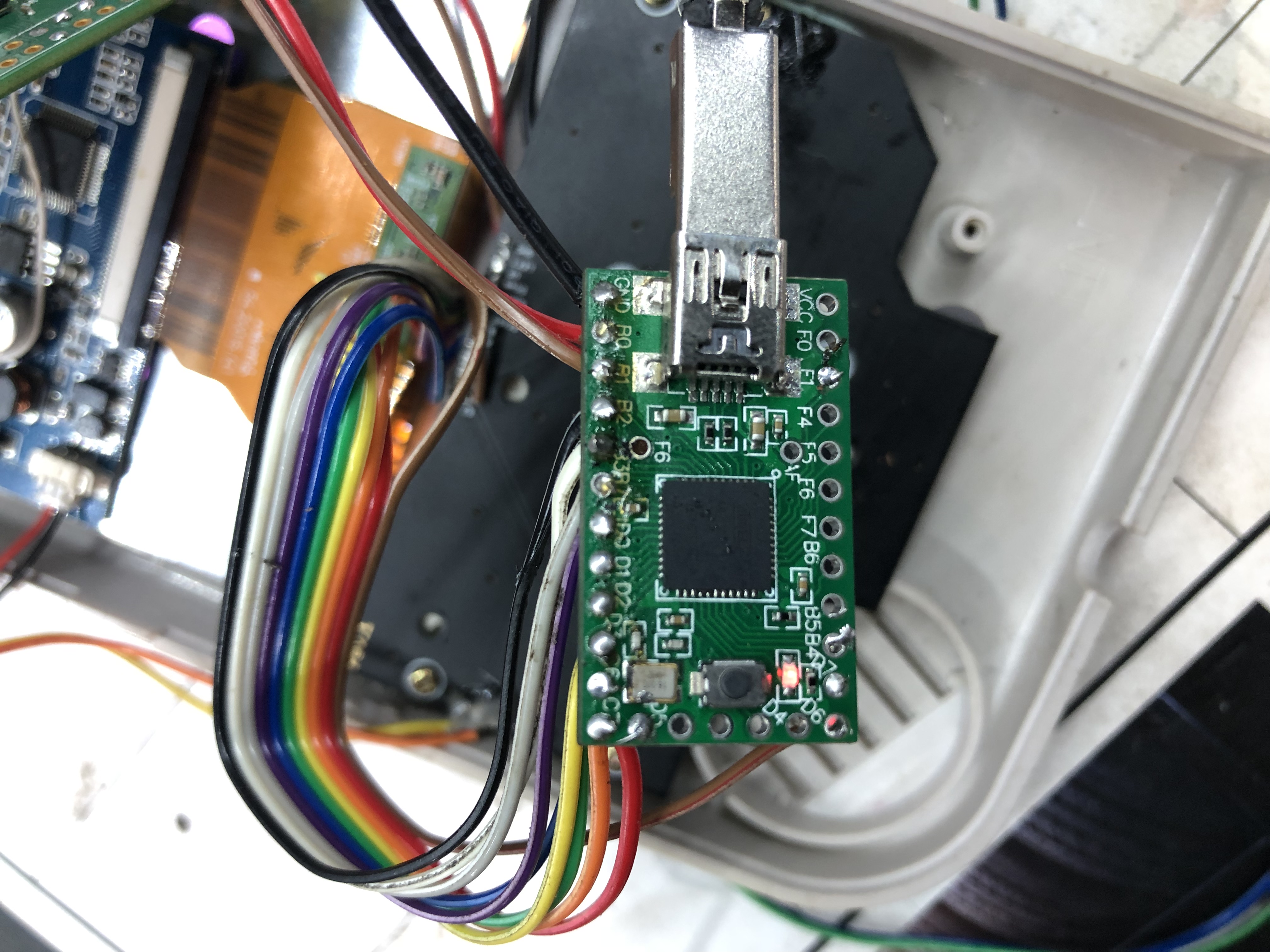

My fault, I thought u loaded pictures. I know I have wires everywhere, I haven’t had a chance to clean it all up but I have it getting power and sending it’s input to the micro usb.

Post by VeteranGamer » Thu Feb 28, 2019 11:35 am
How are you powering the whole thing.....
it looks like that the screen is powered from the Pi Zero
as well as the Teensy 2.0
providing you have a good power source, these shouldn't really be an issue....
but it is always best to to have power going to the individual items separately....
and this could be the reason the Teensy cuts out after a bit (just not getting enough power)
also some would say...
twisting the USB wires may also help
(a tip would be to use an old USB cable for these type of connections, as they twist a lot easier)
also
this whole section doesn't look that great....
one tip for an easy DIY micro usb connection would be one of these....
https://www.aliexpress.com/item/5PCS-LO ... 4c4dM94t83

you dont really need to buy a better one....
(I just use old mobile phone charge/sync cables that I have lying around.... there free... well kind of)
just make sure the connections are solid from point A to B
this just looks bad... and could be your issue, the signal could be breaking/dropping...
Connection 1 on Micro USB (point A)
Connection 2 on Mini USB (point B)
no other connections in between
