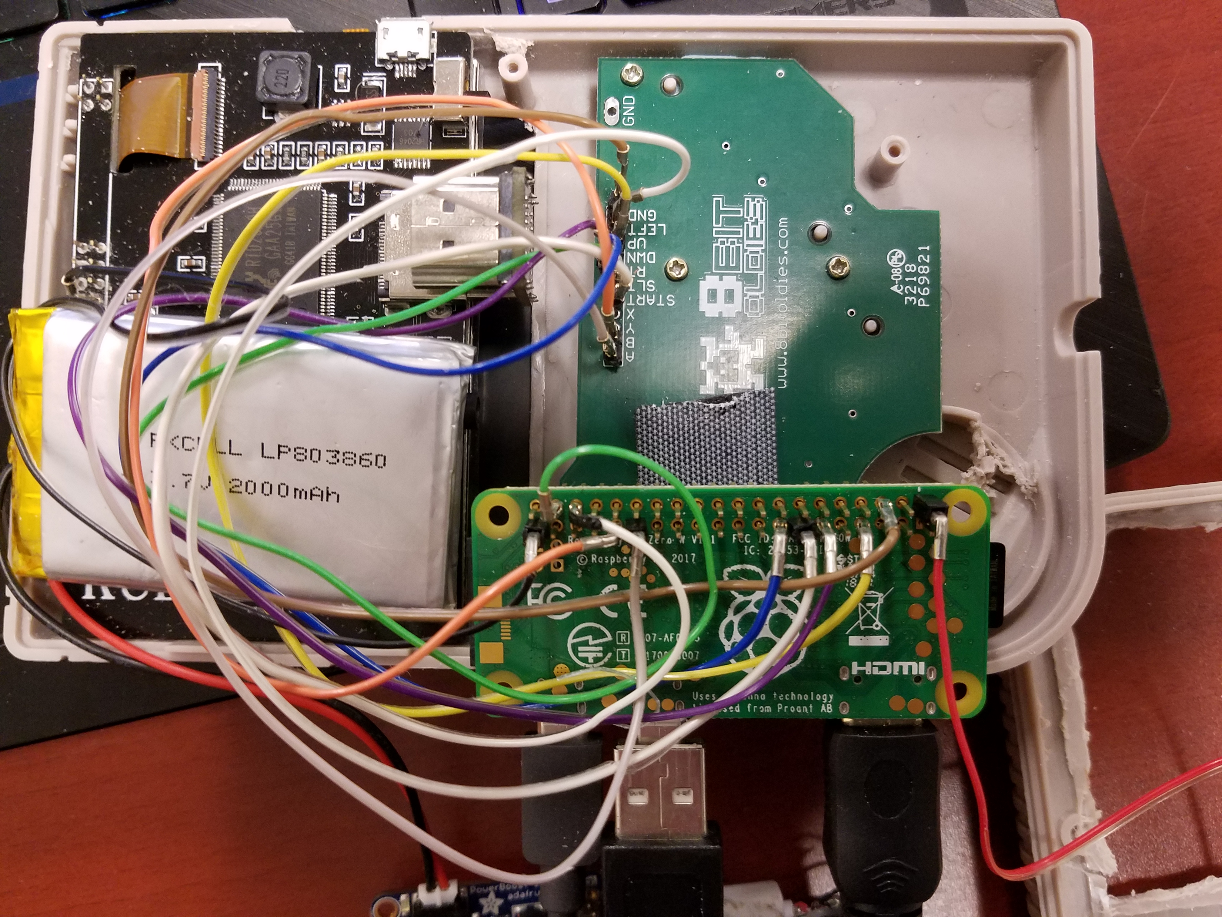

So I have tried every darn diddly darn thing I could think of to get my controller buttons to work but they are stubborn buggers. So far I have tried using mk_joystick and retrogame. Most recently the premade retropie image from tinkerboy with retrogame already installed - all to no avail. I have used a meter to ensure all wiring is connected, which they are.
This leads me to believe I am robably missing something very simple. So does anybody see something I am missing?? Totally new to this world so I am pretty clueless but excited!
Thanks for any help!

Your wiring looks good important thing is ground pin ..
I recommend you install a fresh image and try this tutorial
viewtopic.php?t=57

maybe a dumb question, but did you un-comment the retrogame config in the startup? tinkerboy's image has it disabled by default.

Is that header on the pi soldered on there? What about the button pcb?
I assume those connectors are not getting a great connection.

Rodocop...I initially had the headers just tacked on at an angle for testing and it seemed to have connection, however, to make sure I have since soldered them like you said. Still no change. What's strange though is, I have tried using GPIOnext and SOMETIMES one of the pins will register during config. But sometimes not. I dont get it, but I will give the suggestions a shot.

Also, not sure about GPIOnext, but with retrogame, make sure you use the GPIO/BCM number, not the physical pin number.
