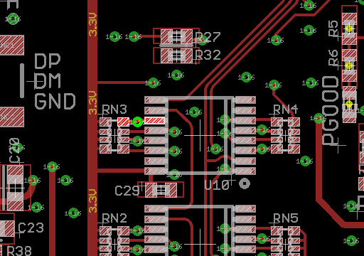

Hi, can you inspect the board here and see if the highlighted pin (the brighter red one) looks correctly soldered? Perhaps if you could also measure the resistance of this pin in relation to GND (with the CSL turned off).

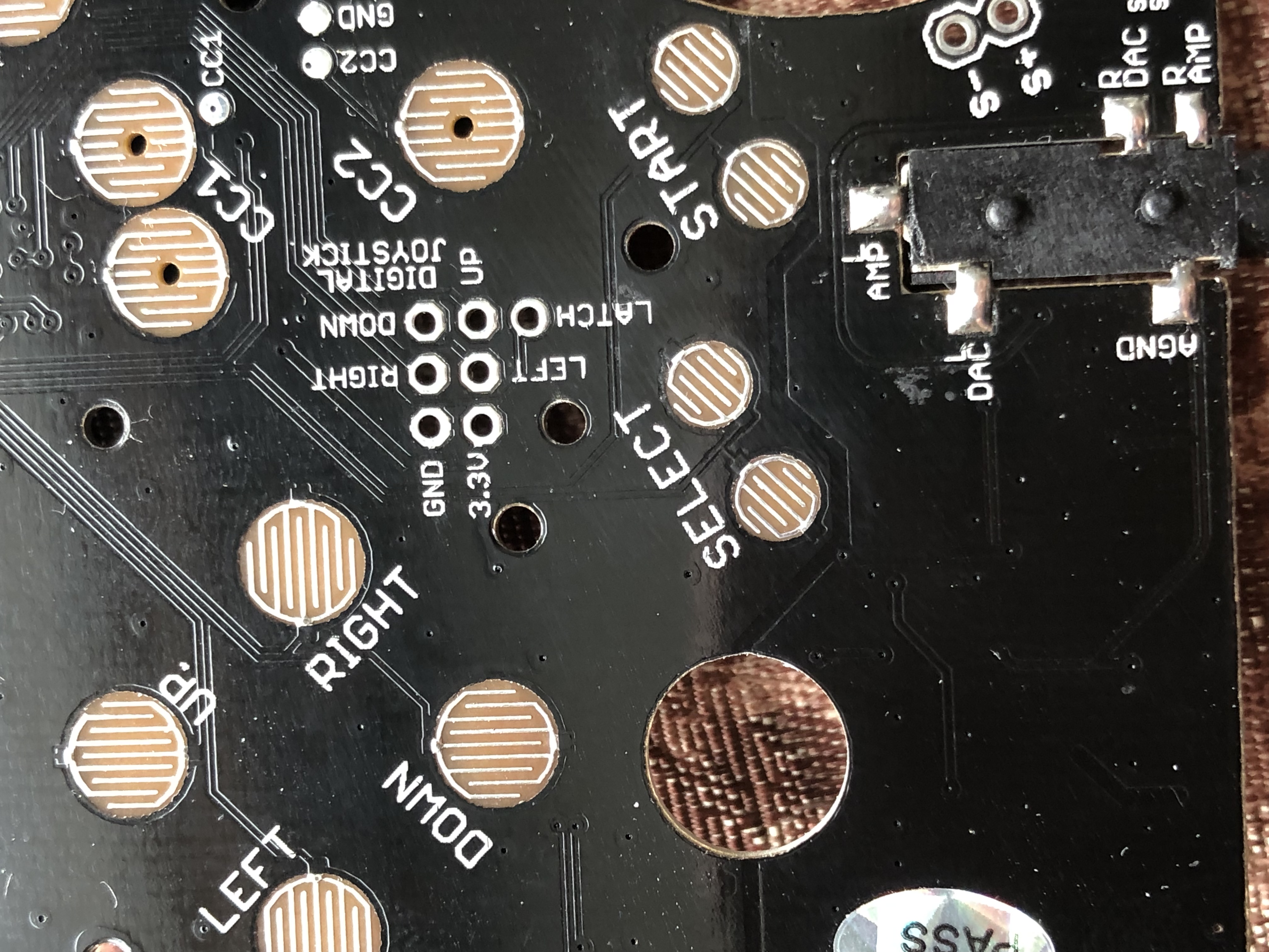

Also, inspect the other side of the board around the select button, is there any stray solder on it?

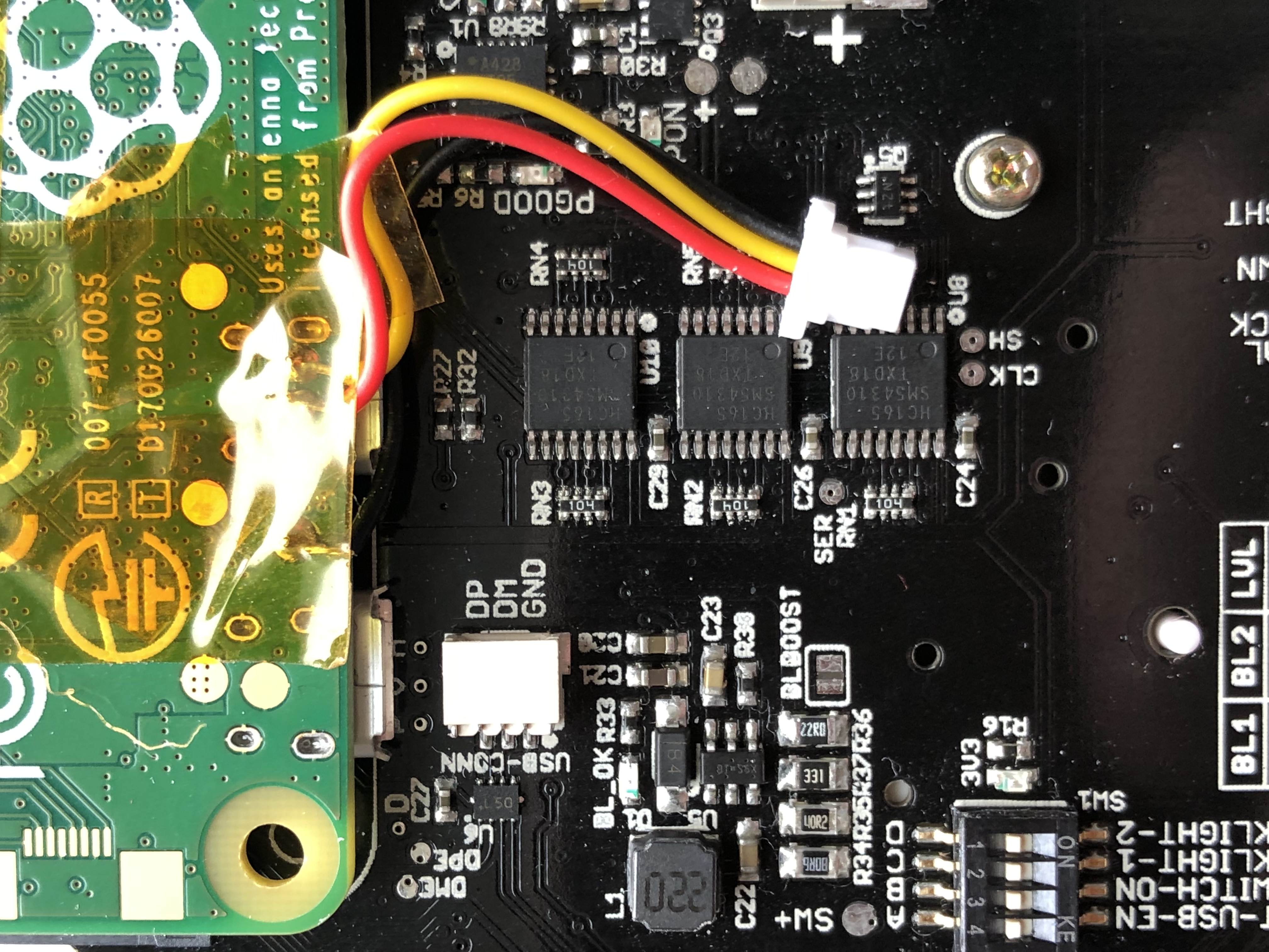

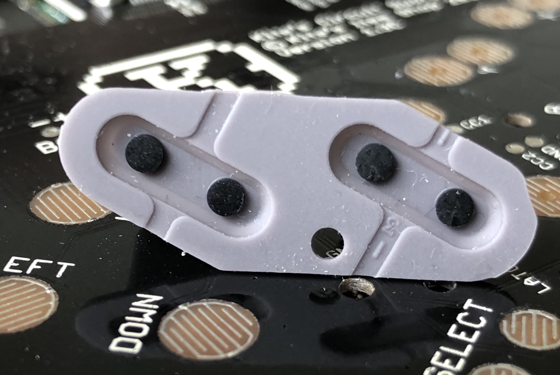

I checked for stray solder on the select pad. Nothing. I checked the pin you mentioned, I can’t see anything. I included pics. I was unsure how to check the resistance. (I have a multi meter but am not well versed with it).

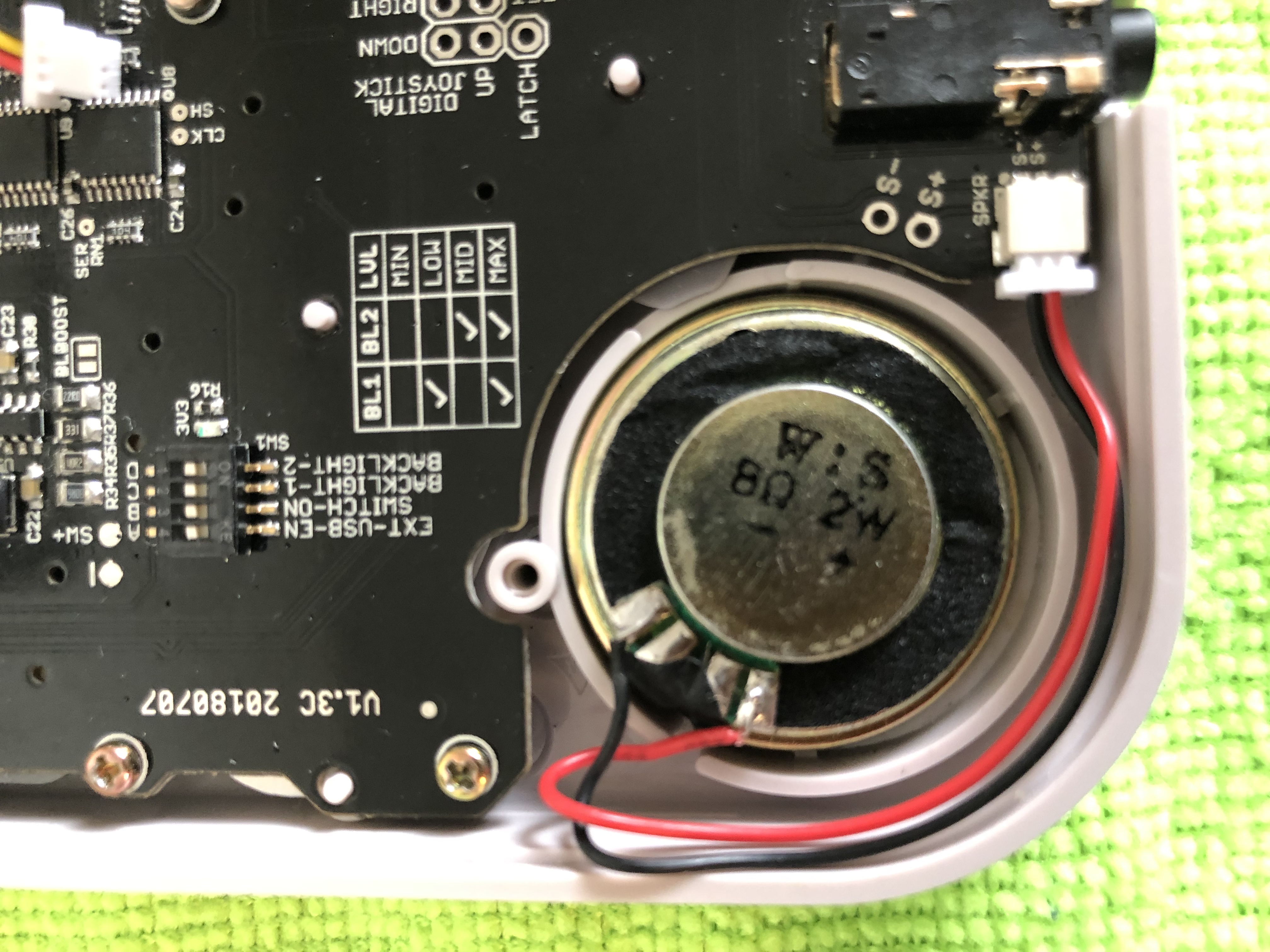

Also, not sure if it is related or not. But the speaker doesn’t seem to work. The headphones work fine, but the speaker doesn’t make any sound. I included a shot of that too. It seemed to work the first time i tried it, but not after that.

That resistor "RN3" the top right corner of it looks a bit suspicious to me.. how good is your soldering?
would you be able to try and tin the top of that resistor? That is a 4 parallel resistor device, and that top corner looks like it's not fully soldered. It would be worth giving it a go, and if you fail that's fine I'll accept return and repair for you
so nothing to lose, only to gain!
Also, the speaker, can you unplug it and measure the resistance from the + to - (on speaker itself). And also when powered on the voltage with one probe on the CSL GND (e.g. the USB port or anything metal on the pi like the HDMI port) and then the other probe on either the - or + of the speaker, and get the reading for both?

I tried to see if I could solder it this weekend. I tried a little but it seemed to be a failure. I don’t think i have a fine tipped enough soldering iron or solder. I’m pretty sure i would solder the whole resistor together if I did tried any further. Sorry. Let me know how to proceed.
