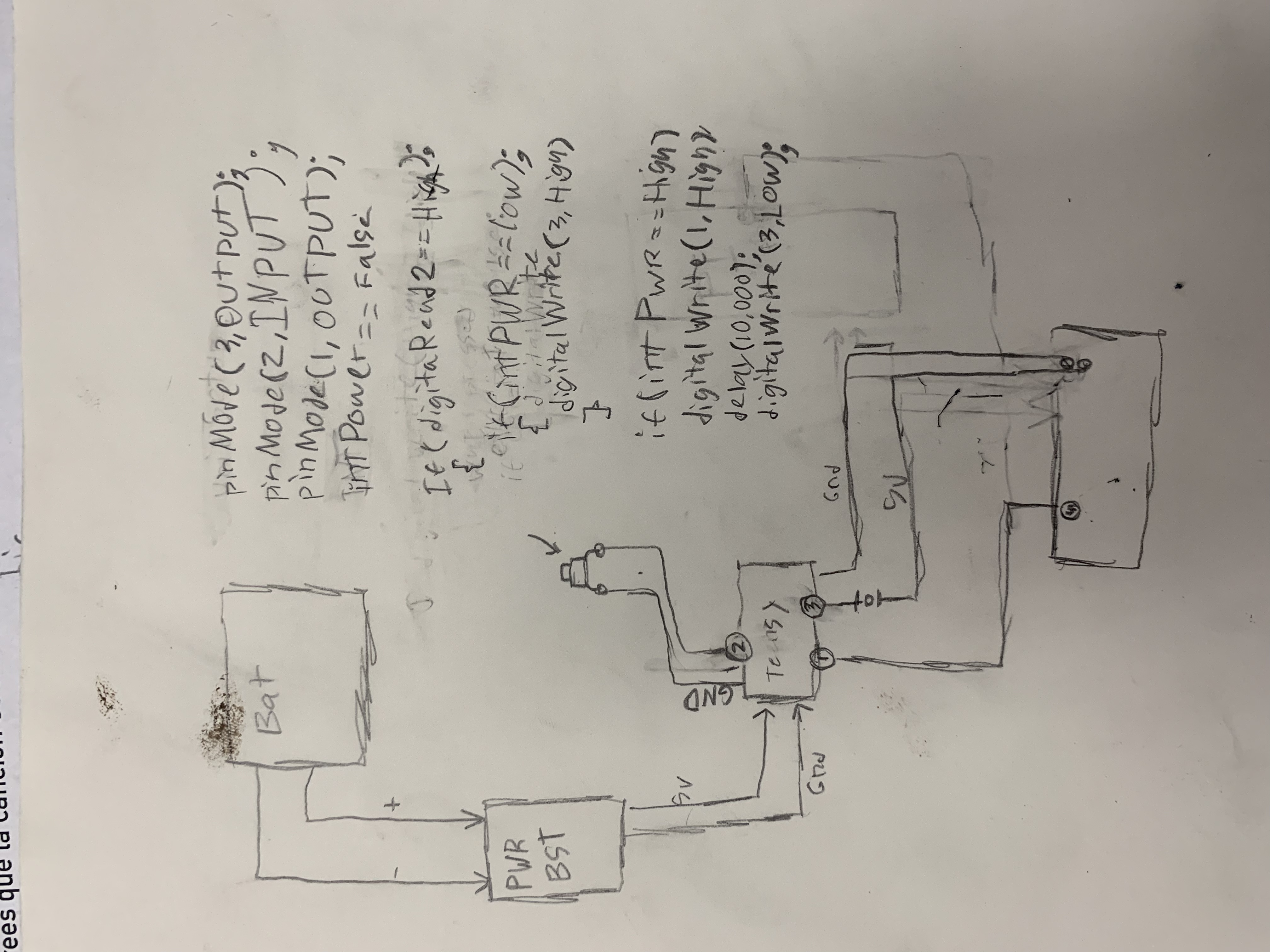

Doc105
Posts: 32
Joined: Tue May 02, 2017 12:00 pm
Re: Where can I find a safe shutdown script?
Post by Doc105 » Wed Apr 03, 2019 2:14 pm
Here’s what I was thinking
UPDATE: just remembered shutting down and powering off are two separate things forget all of this
infinitLoop
Posts: 536
Location: Portland, OR
Has thanked: 222 times
Been thanked: 199 times
Post by infinitLoop » Wed Apr 03, 2019 2:56 pm
right - if you want shutdown + power off, then that's something people have used gates for, or at least some kind of circuit. depending on the power supply you want to use, you might have some options around utilizing the "engage" pin too. the ones i've seen/used still use just the gpio for control though, and basically have one pin call "shut down" then another pin that stays active til the power down, and then that triggers it to cut the power.
