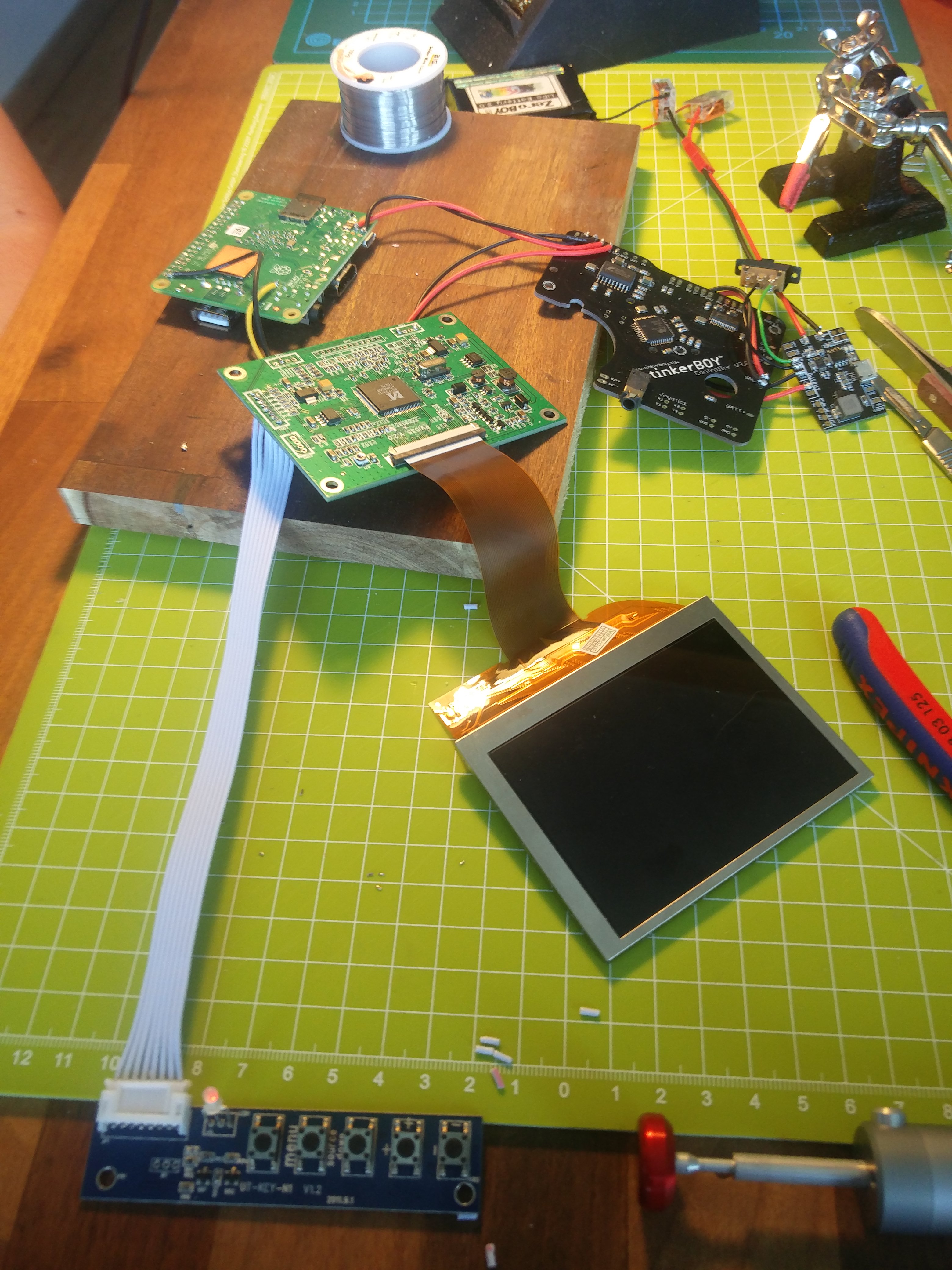

Hi I bought a screen PD035VX2 from Aliexpress.
Was kind of a mess because the vga board they sent me was 12V and for a 7inch display (https://de.aliexpress.com/item/32845064 ... 4c4dOE3KqO). Ordered another Controller for the display (https://www.ebay.de/itm/VGA-AV-LCD-Driv ... 1438.l2649).
Now I wired it all up but get no picture on the display. After they really got it wrong the first time I do not know if the display is really a PD035VX2 (only think strange is the ribbon cable which seems to be longer than normal).
What can I do?
The wiring seems fine to me.

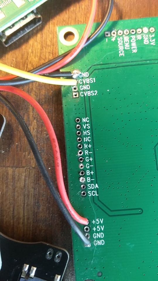

There are 5V on the VGA Controller. So it is not a power problem.

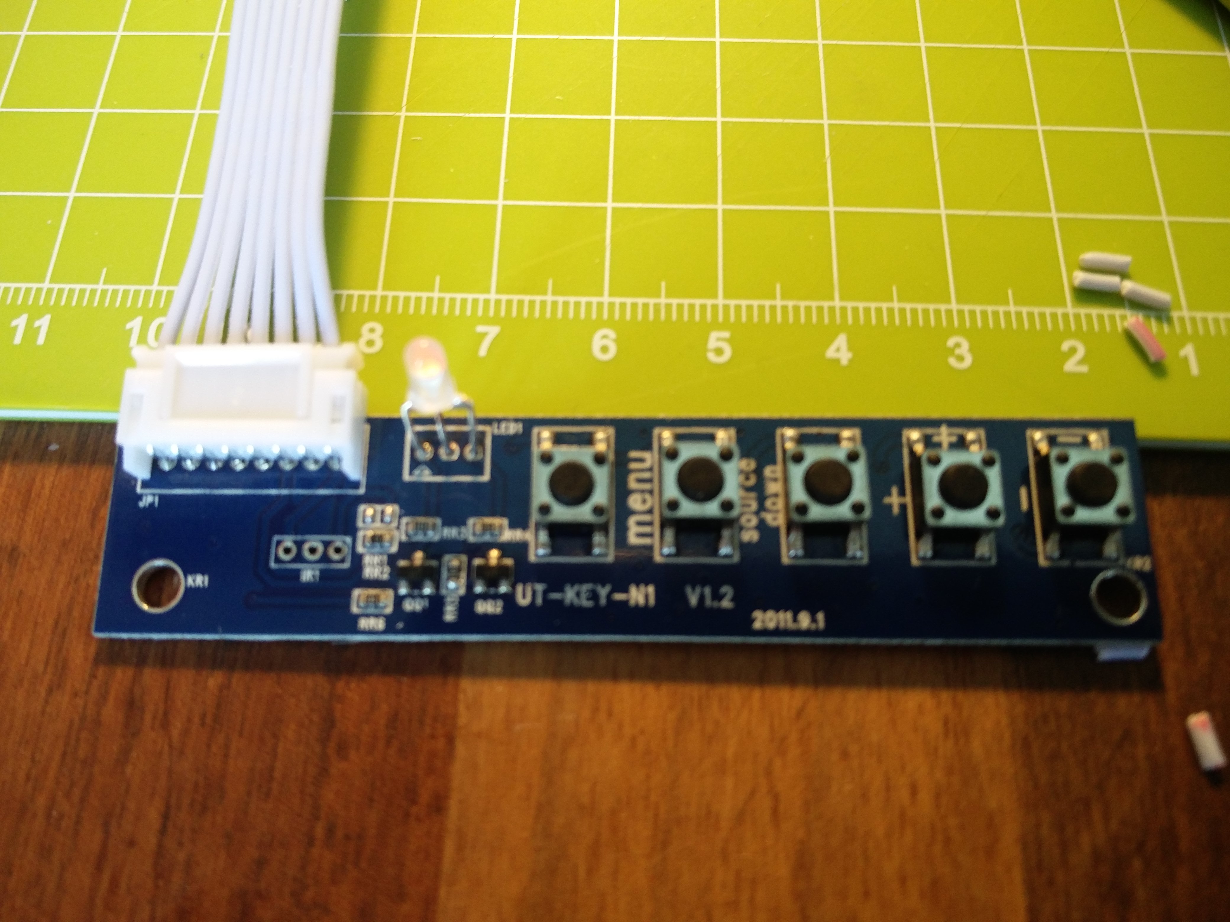

As a note: I removed the on and off buttons (separate board). Maybe the screen just does not turn on. Can I jumpwire this 3,3V->power on last picture)?

first off.....
I would try attaching/connecting a battery to Helder PSU (it needs a battery connected to run/function properly)
also
Helder PSU has two (2) separate power (5v/GND) output connections....
these can both be used....
one for the RPi and the second for the LCD....
you also just need to connect the one composite connection (either CBSV1 or CBSv2)
there is also NO need to GND it (you already have a GND connection for the power)
and most importanly
(this is where you've tripped up)
you need to set it to composite using the button board
more info can be found here about this.....
https://www.sudomod.com/forum/viewtopic ... t=80#p5710
NB: all the info is already present on this forum.... if people would only use the search functions.....

Hi thanks a lot. We removed the plug for the button board. Does this setting have to be done only once? then we will solder it again to the button board. Or do I have to let the Button board be in the build

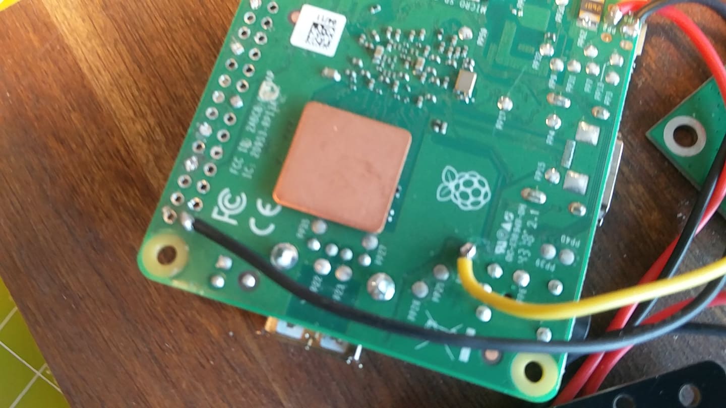

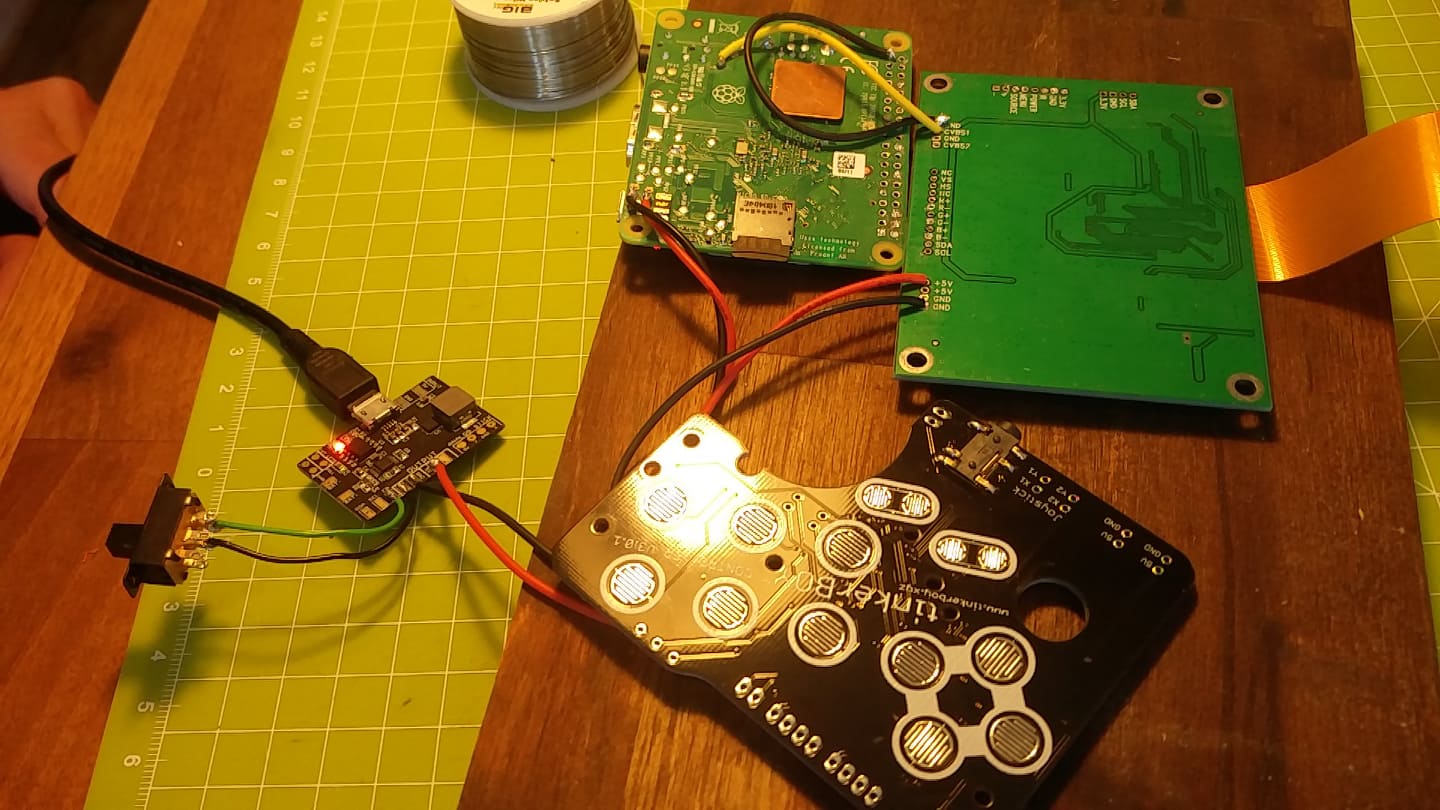

I Used the Powerdistribution of Tinkerboy V3. Do not think I have to do it via helder -> Helder PSU to Tinker -> Tinker to Display and PI
The battery not visible on the picture was soldered afterwards and 5V was available on the VGA Board.

Is it possible to connect the 3,3 V of the VGA board with a own button in between to power and to source on the VGA Board so you do not need the Button board.

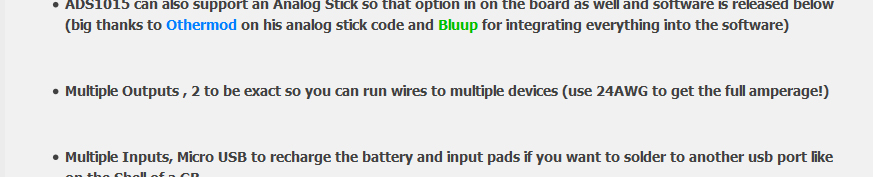

Helder PSU has two out puts......
there is NO reason NOT to use them.....
to get the most out of what you have....
I would recommend/suggest to use the both (as Helder as specified..... 24AWG)
as far as I can see....
once you've set it to the composite you should be able to remove the button board.....

Thanks...but turning the Screen on seems to bei a Button I will still need. Will Take a Look into the threat

What does the controller board actually do? 3,3V on the other pins for + - source and so on ?
Re: Screen does not work
So I wired the controllboard but the screen does not react to anything I do (Voltage is ok everywhere)... Source, Power On - Just does not care.
