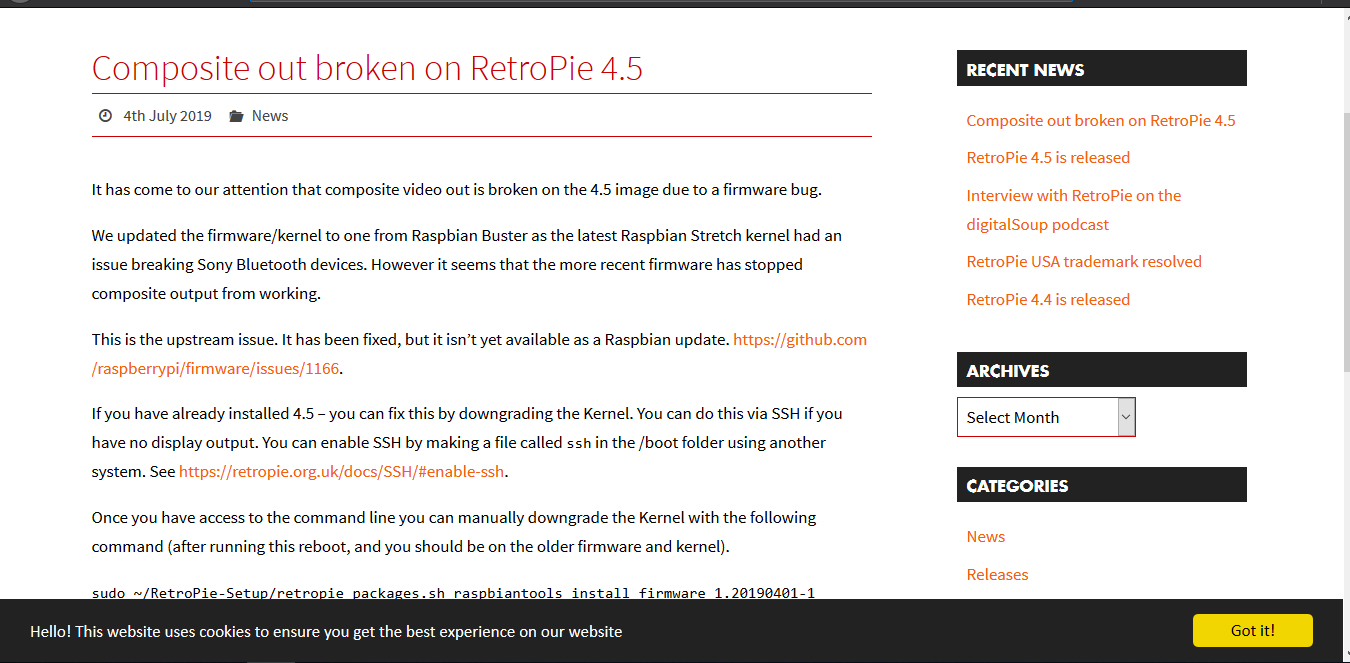

https://retropie.org.uk/download/
https://retropie.org.uk/2019/07/composi ... ropie-4-5/
they have work arounds on there

Personally I’d scrap version 4.5 for now
And just stick to 4.4
Your gonna be using a Pi0, it’s not gonna matter much which version it is....
(Apart from one that isn’t providing a reliable composite output)
