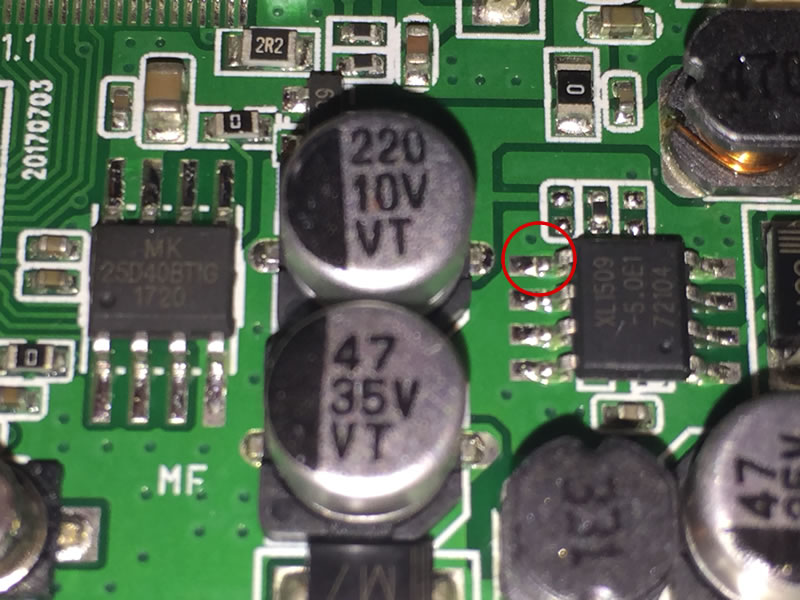

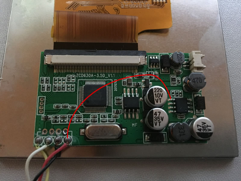

From my research (https://www.sudomod.com/forum/viewtopic.php?f=44&t=8266 and https://www.youtube.com/watch?v=_MtN_s4 ... u.be&t=230) I believe I need to bridge the input wire to pin 1 of the XL1509 chip as shown in the images.
Proposed routing of bridge wire from input to pin 1 of XL1509 chip
XL1509 chip on the right. Pin 1 (I think) is circled
Do i have this right?
If not what would be the correct wiring?

Check my post about GearBest Screen 5v Mod which uses the same XL1509 chip.
Re: Variant Screen Wiring
Post by rodocop » Mon Oct 14, 2019 7:06 pm
Tinker boy is right, check out his link too.
I also just posted in another thread, but you want pin 2, not pin 1.
Pin 1 is for VIN, while pin 2 is the output.
https://imgur.com/a/9nZzwLx
Where the little divot on the chip is should be leg 1. Someone correct me if I am wrong.
