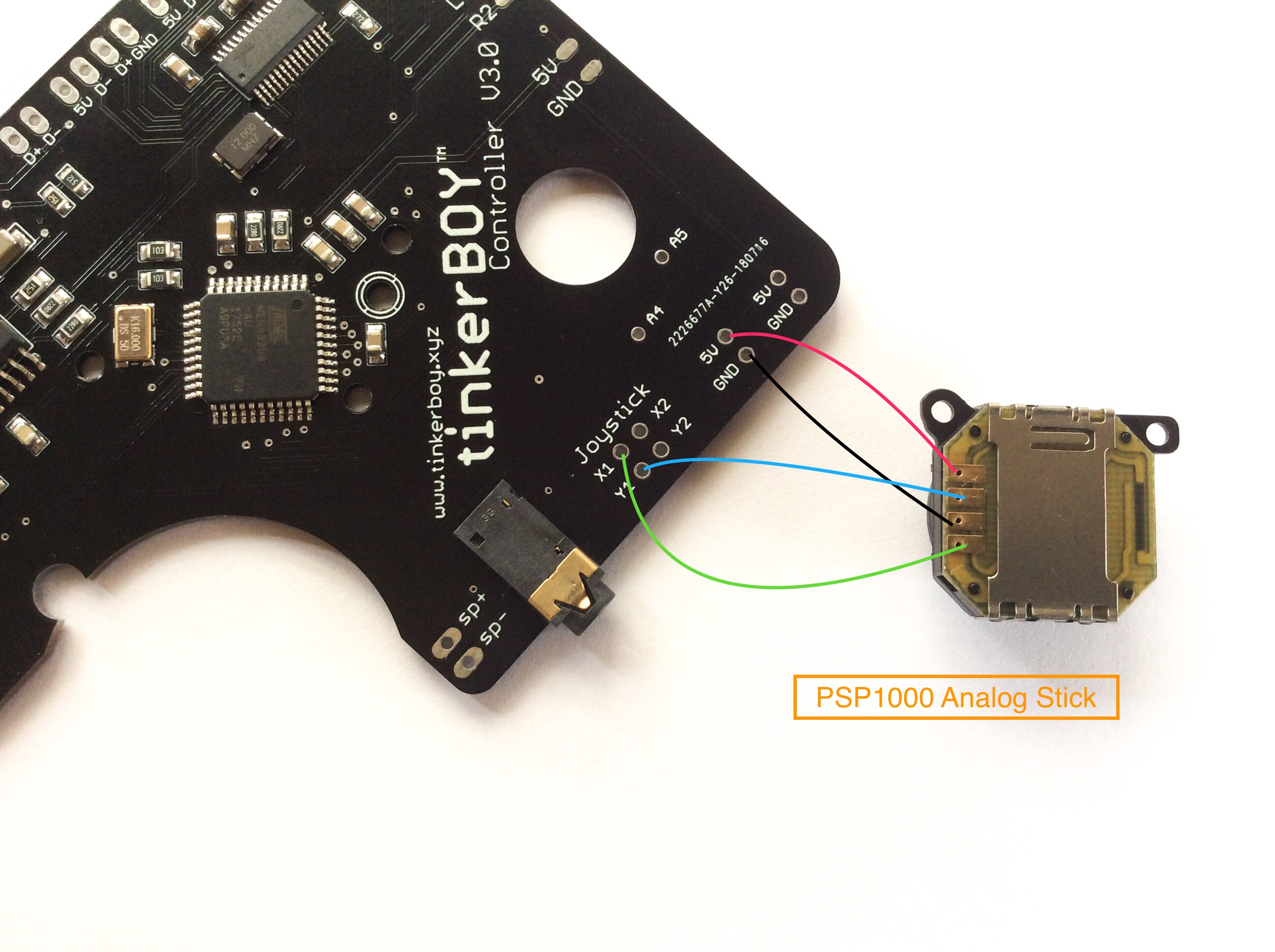

Hey all i have completed my project and cannot get the joystick to work.

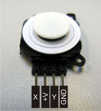

I have a PSP 2000 joystick by accident and hav managed to get it in the case easily enough i wired in a similar manner to the PSP 1000 instruction on Tinkerboys website as i am using his board and his retropie image. I read in a thread on here that it has the same pin out but then i found a conflicting image which suggests a different configuration.
Can anyone help in which is right?
