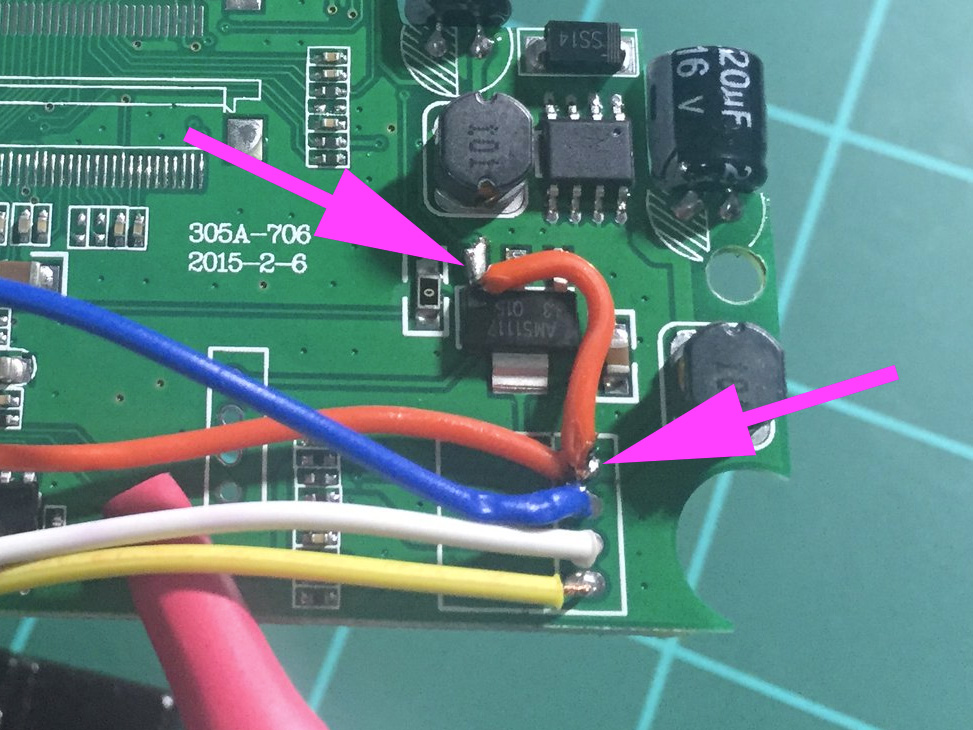

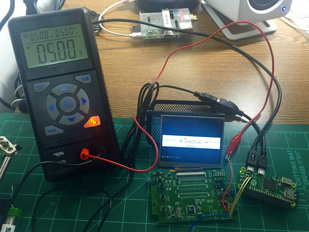

I had the bad luck and received the same screen (from ATian Direct), it doesn't work for me because I'm using the original DMG101 case, but while I wait for the screen from GearBest I wanted to start testing the buttons and everything else, so I modified the same screen you have to work, here is what I did:
Proof that it works on 5v:
Brett82
Posts: 52
Joined: Fri Jul 08, 2016 8:12 am
Been thanked: 23 times
Re: Modifying screen to 5v
Post by Brett82 » Fri Aug 05, 2016 1:34 pm
yeah you can do it as above it just skips out some of the filtering.
