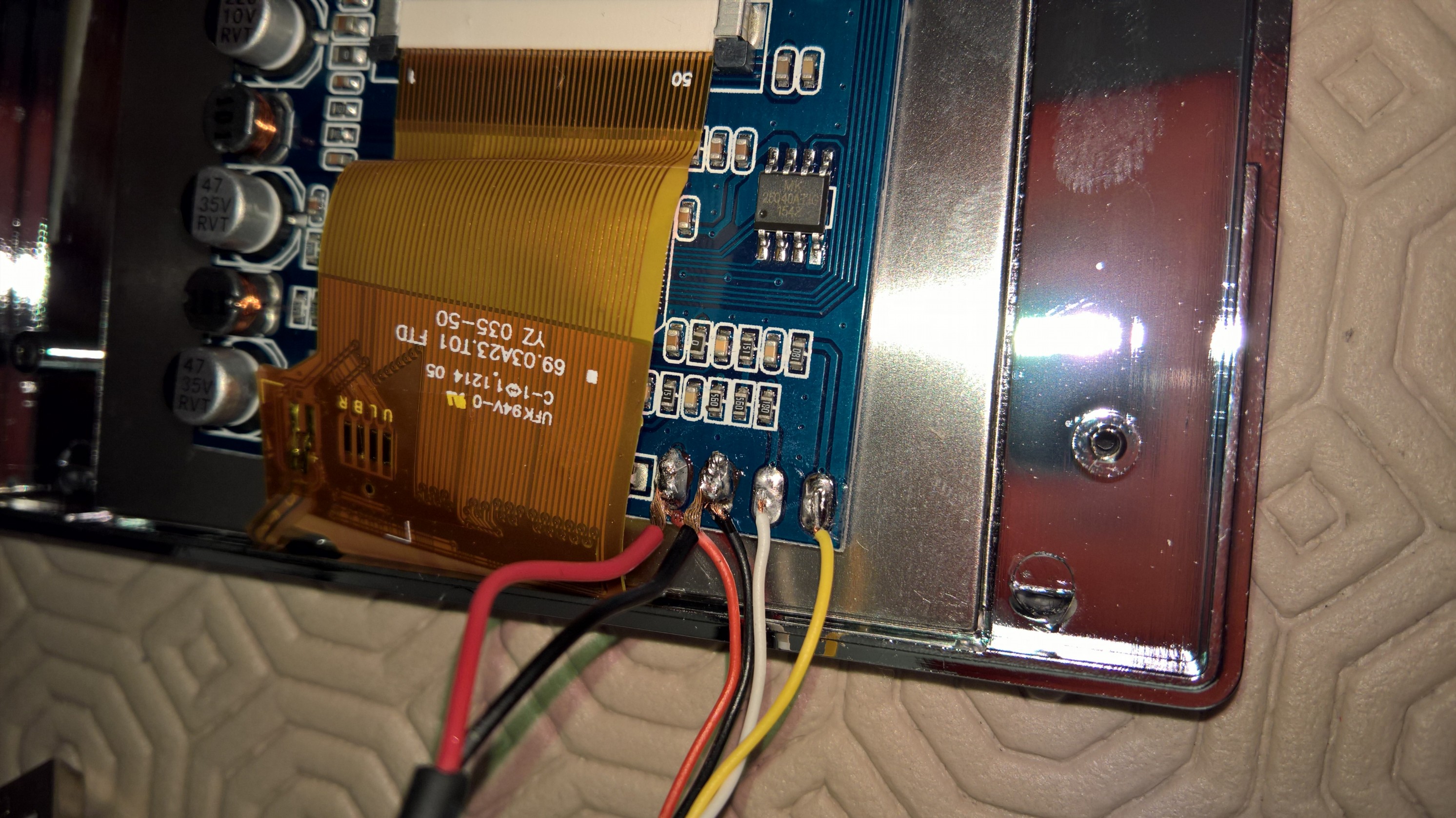

Robots86 wrote:yeah looks like the one on that link. was hoping no mod required
You can always try out to have it powered only by 5v, but then you have to solder.
But you can do as i did and solder them onto those:
http://www.tracepartsonline.net/PartsDe ... 84438L.gif
I broke a off 1x1 and 1x2, soldered the display on those and just inserted those in the "holes" on the RPi0,

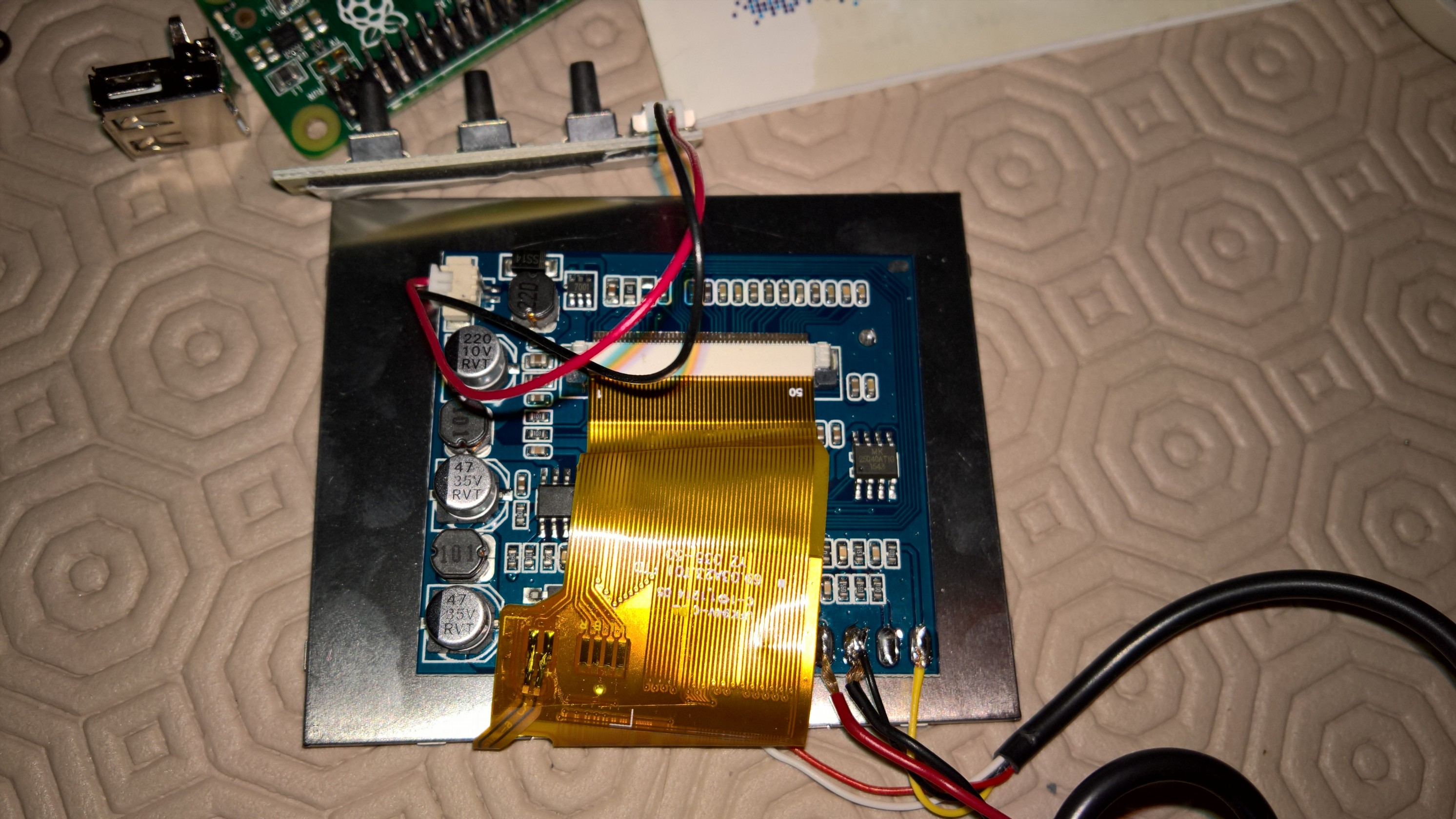

Robots86 wrote:is there any easy way of testing without soldering it all together?
Yes, there is, but it would help t see the whole board.
It looks like this one: https://s20.postimg.org/6jvbxrfml/mamo_board_2.jpg
As you can see on my spreadsheet.
But i am not sure, so you should use a multimeter before getting started,
or you will end up like poor 1461748123 here.
Compare the ICs names with the one from my picture guide here,
if those are the same and everything else is in the same place,
you should be fine with following it.

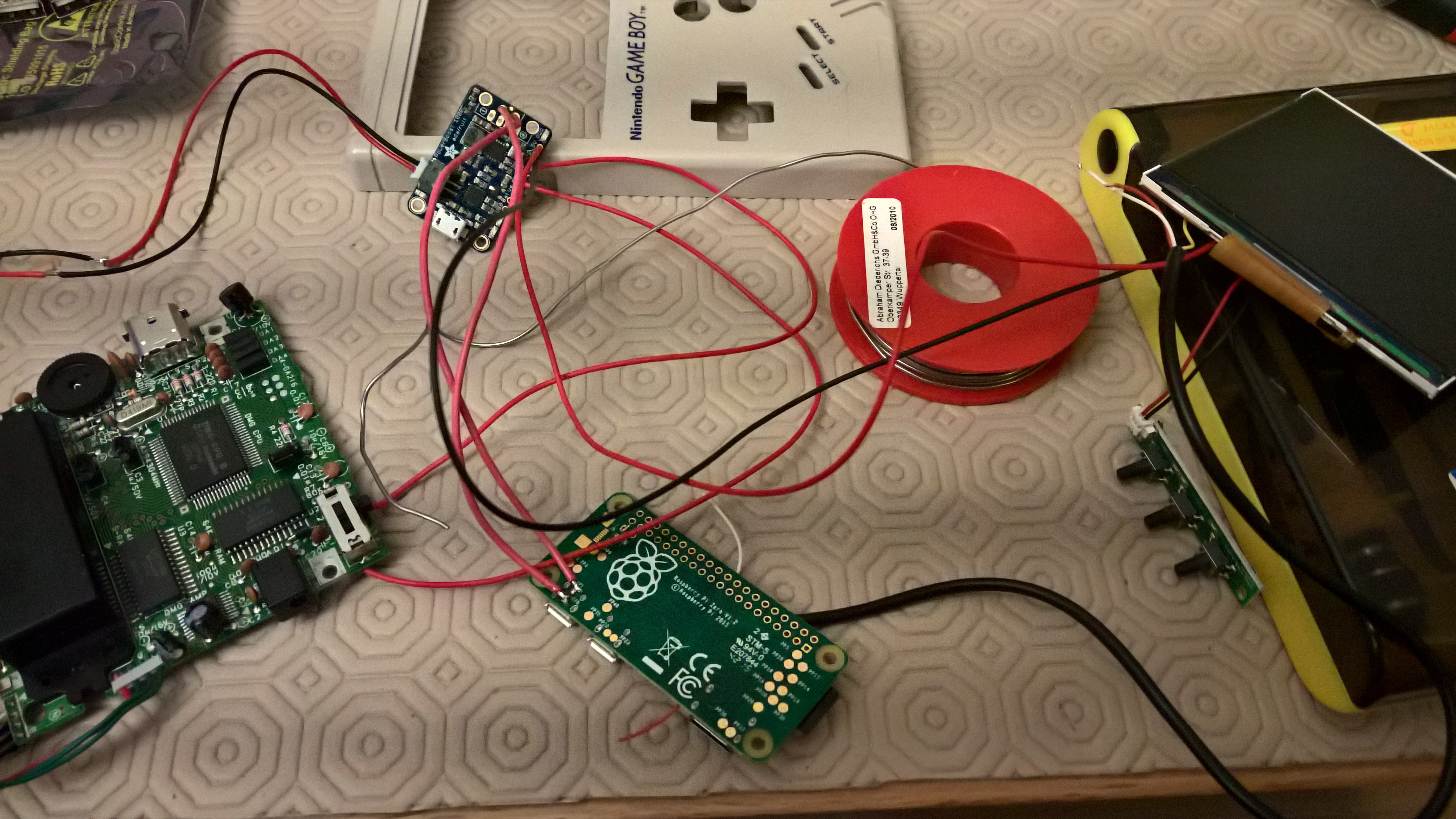

I've got the same board as you, I soldered a usb to the first 2 points out of the 4 and worked fine off the mains usb. Now I'm trying out my powerboost and now the screen flickers. Here a picture of my setup. I haven't modded the screen. Does it need doing??
from what I've found i think it does. But I've not been sucessful powering it up yet. Was you running 5v from the mains? can you post a pic of your board

Robots86 wrote:from what I've found i think it does. But I've not been sucessful powering it up yet. Was you running 5v from the mains? can you post a pic of your board
You know that when you connect it to the RPi0, you have to connect the power to it, too, or at least have the same GND, right?
Yes I was running off a 5v phone charger plug. The board looks the same as yours.
First picture it works off a 5v and plugged into my pitendo
These are the only pictures I have on me of the back of the board.

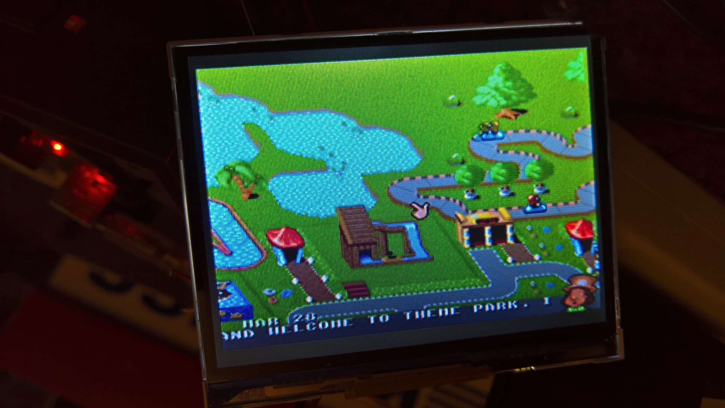

Mine is now working off battery without any mods done. After my partner wiggled some of the wires, the screen went funny colours and now it works. Must be my dodge soldering lol.

grenade44 wrote:Mine is now working off battery without any mods done. After my partner wiggled some of the wires, the screen went funny colours and now it works. Must be my dodge soldering lol.
I got my screen working today. What battery are you using?
