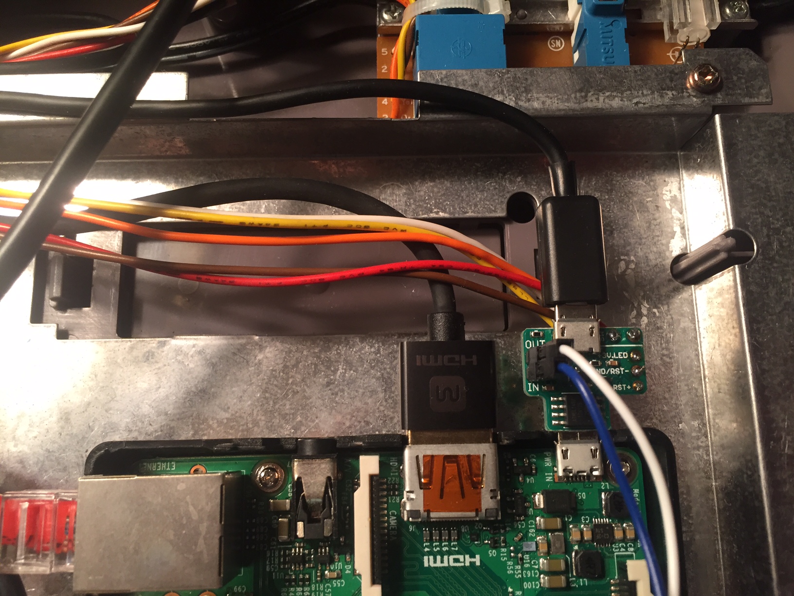

- Point of connection to RaspPi
- IMG_8171.JPG (641.65 KiB) Viewed 5005 times

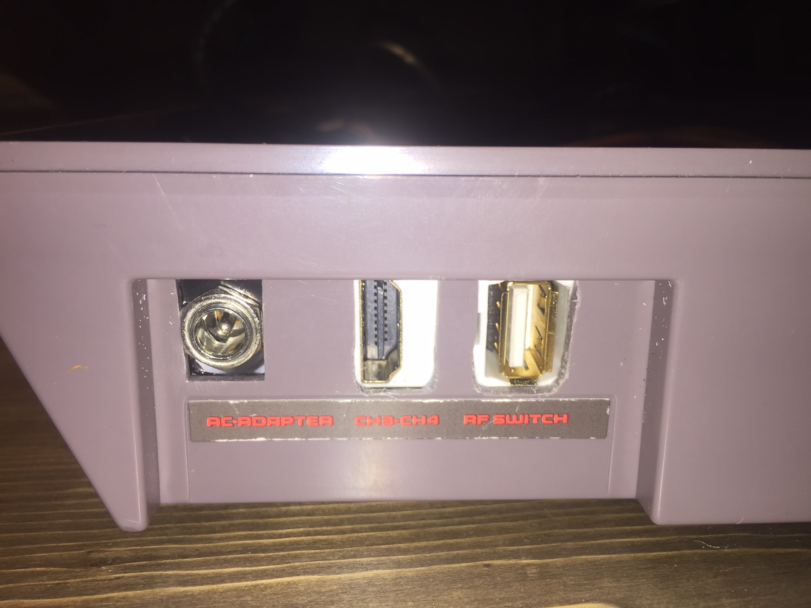

- Rear Shot of Barrel Jack
- IMG_8165.JPG (419.89 KiB) Viewed 5005 times

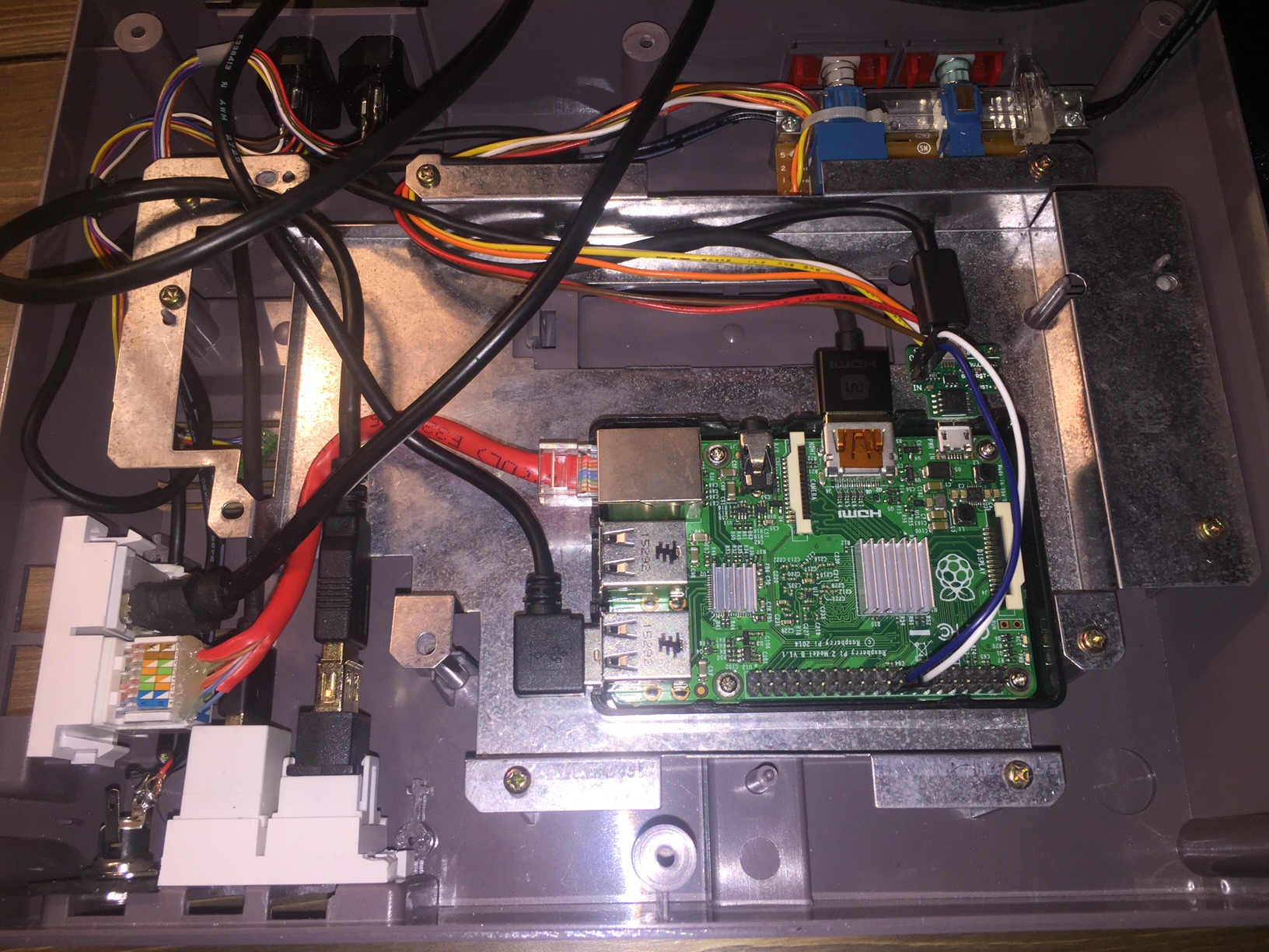

- Overview of layout (minus USB Hub)
- IMG_8163.JPG (782.16 KiB) Viewed 5005 times

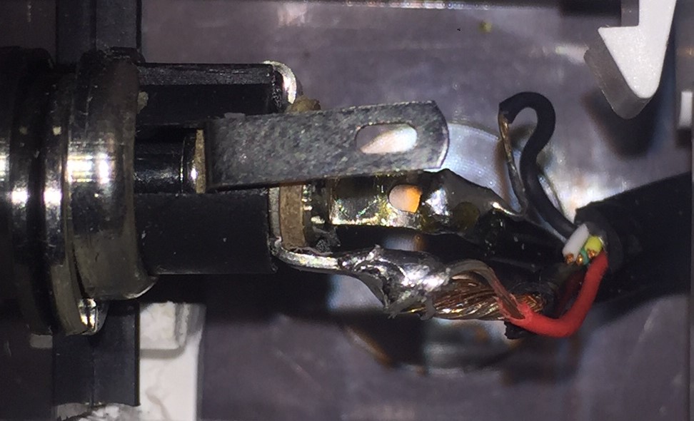

- Close up of soldered wires to the Barrel Jack - 2 positive and 2 negative wires
- IMG_8160.JPG (134.03 KiB) Viewed 5005 times

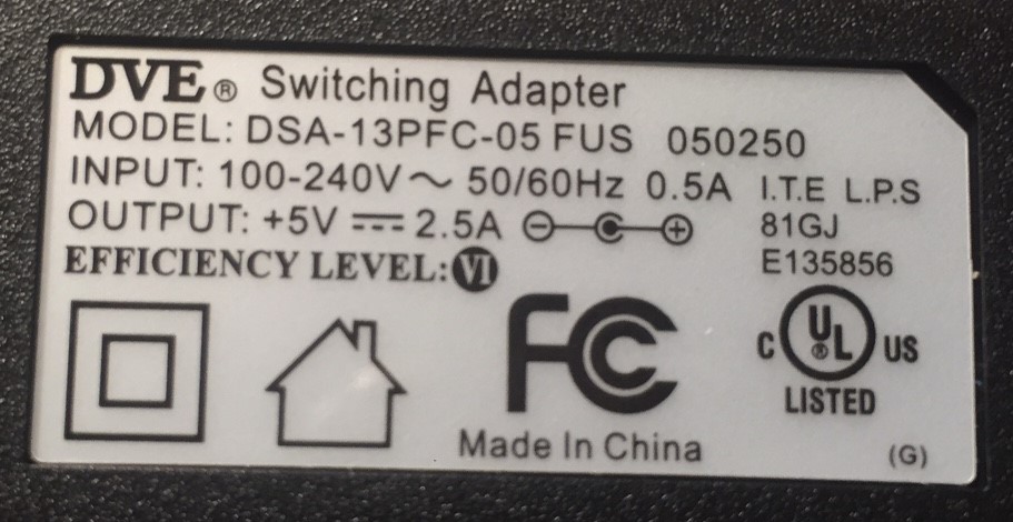

- Info on power cord being used.
- IMG_8167.JPG (127.5 KiB) Viewed 5005 times
