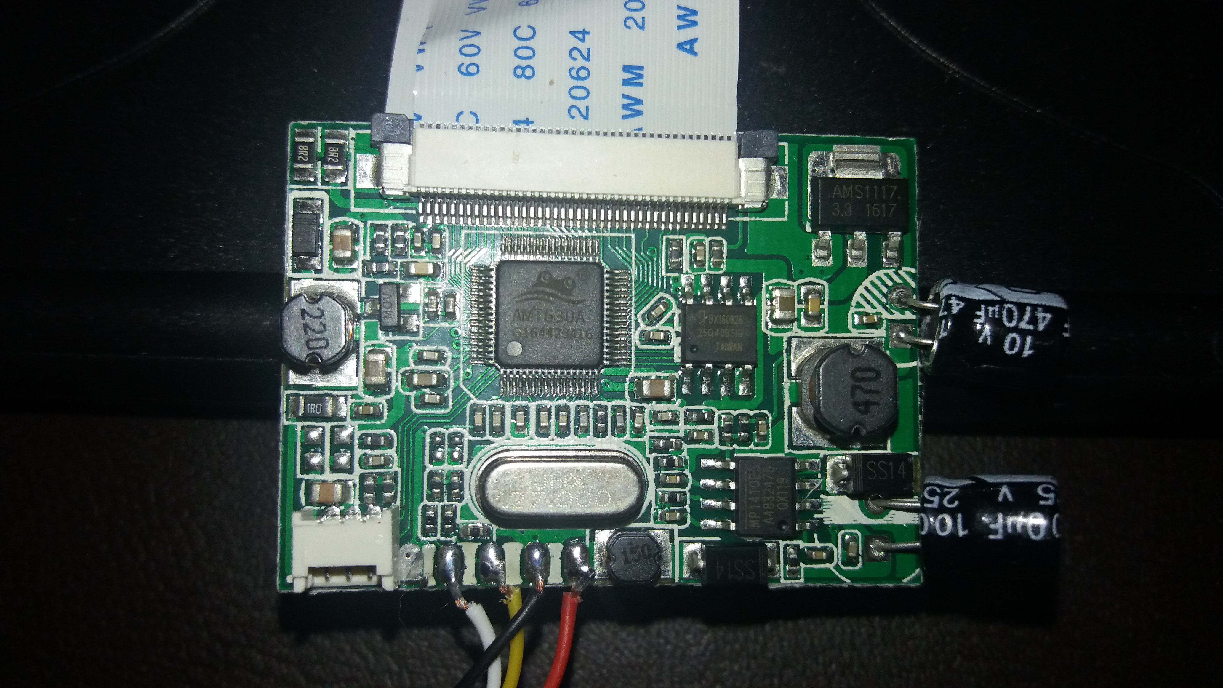

I found a really cheap TFT but I cant find any 5v mod.
Anyone can help me?

Ok one tip please make also photos from the chips. Thanks

Post by machimachi » Sat Dec 10, 2016 11:07 am
This is the best picture I could make, tell me if I have to try another one.
Thanks for your help.

Post by Durtturbine » Sun Dec 11, 2016 1:39 pm
I have a board with the AMS1117 chip as well. How I converted it to 5v was running from power to the third pin on the ams1117
Here's my board. I've still gotta trim it down though.

Post by machimachi » Sun Dec 11, 2016 1:51 pm
So just for confirm.
I have to soldier the red cable as you mark on the picture and unsoldier the white one?

Post by Durtturbine » Mon Dec 12, 2016 8:30 pm
You don't have to unsolder the white one. Its just a second input for the screen.
