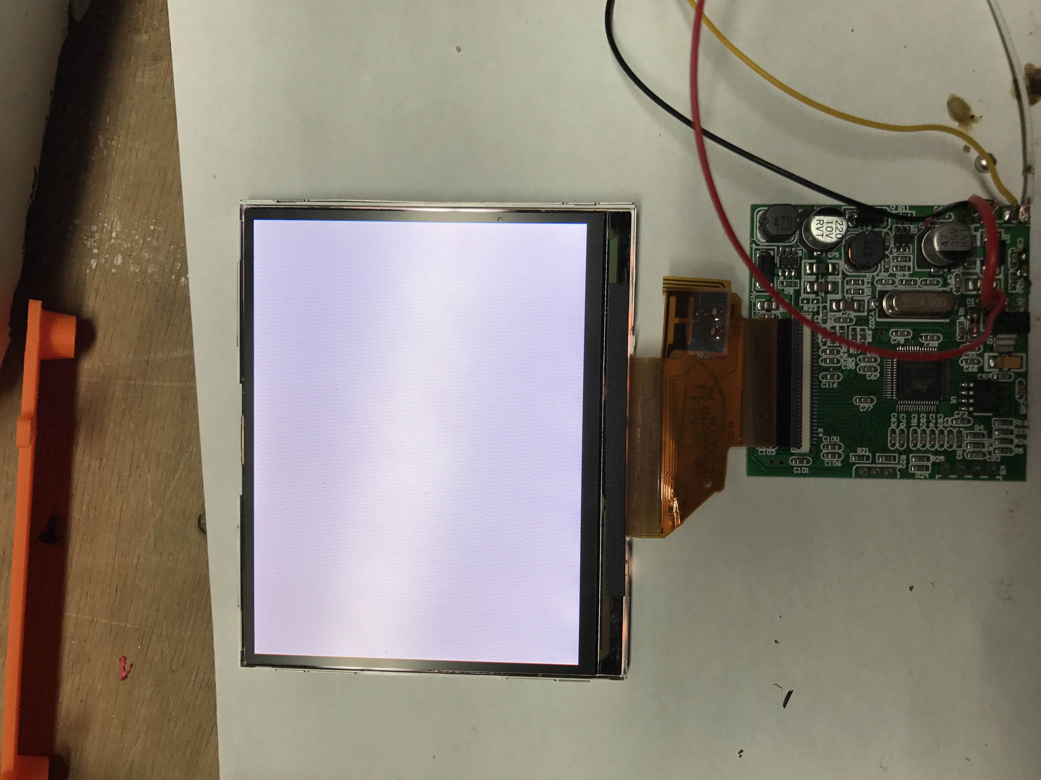

Okay so I've been wracking my brain over this for most of the afternoon, but I can't seem to get the BW backup camera screen to give me a picture. The screen is variant 8 on the wiki and I have tried both 5 volt modifications. Everything is wired up correctly and I can't find any shorts but I still end up with a white screen, I tried formatting my SD card and adding retro pi for pi 1/0 and it still doesn't seem to work, any ideas before I order another screen off amazon to try again?

I have had all kinds of problems with these screens. I have gotten 1 of 4 to work and it is constantly blinking and staticey. The one I have gotten to work I did not need the jumper. I just removed the original power and and went straight to the 5 v input. Have you tested your pi with another composite screen?

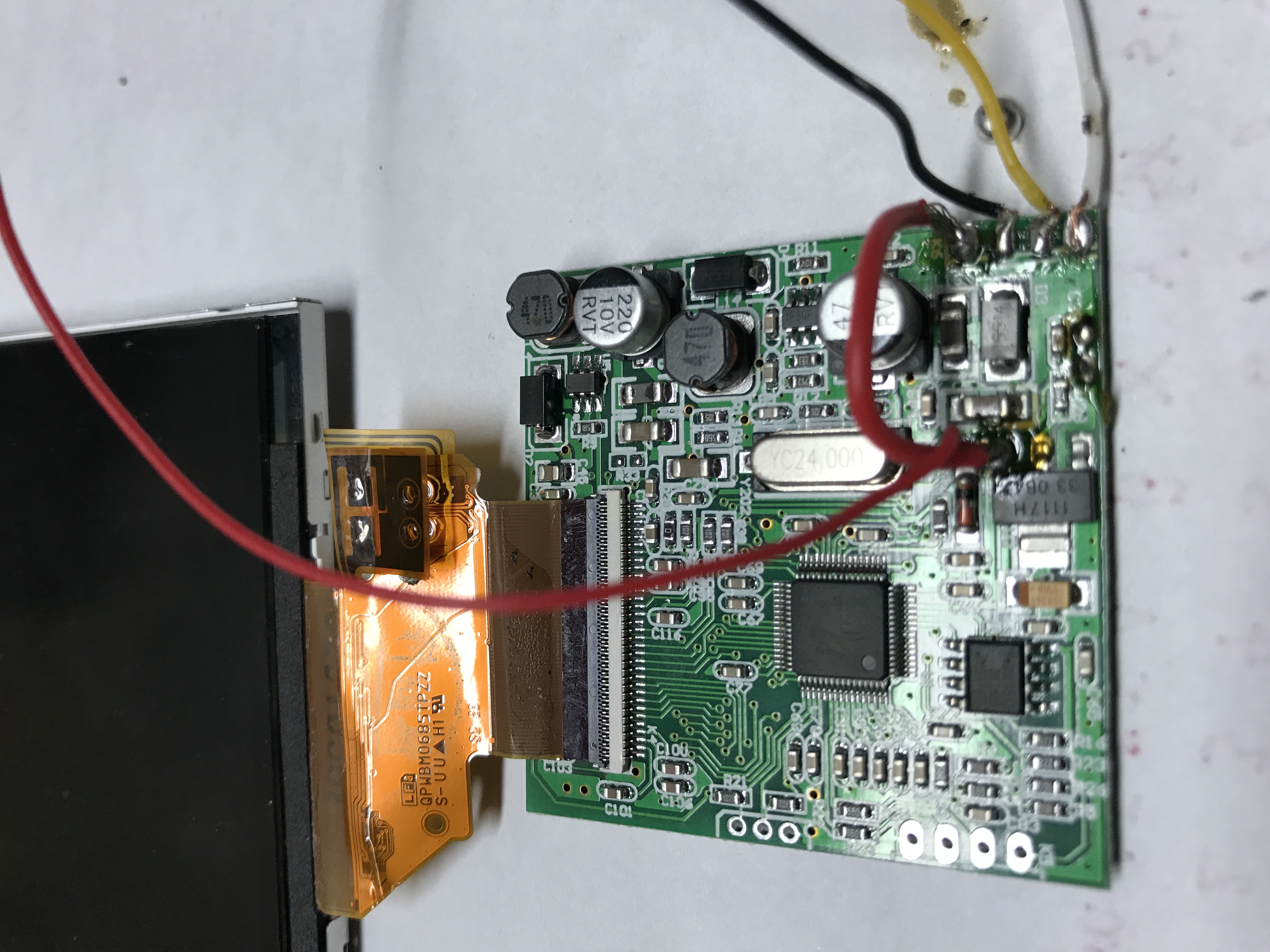

I checked that pretty carefully and the only questionable spot place where it is really close to other components is on the controller board modification (change over to 5v)
I also tried swapping the Yellow and White connections on the Pi but that didnt work.
HDMI input works well so I dont think it is a RPi issue,
I made sure the ribbon cable was attached correctly too.
I'm just at a loss.
I saw a post that said only one composite connection is necessary on these screens (either white OR yellow). Is it possible that using both is causing some sort of interference?
I cant imagine that being the issue because how would the screen ever function normally if they are both plugged in?
The only thing I have not yet tried is the Second modification method from the Wiki.
http://sudomod.com/wiki/images/a/a5/IMG_0480.JPG
If I'm looking at this picture correctly, it seems like the red 5v wire is soldered to the GROUND connection on the board and then bridged with solder to the 12V input and over to the chip. That seems really weird to me, Why are the ground and power connected in the same port? It just seems counter-intuitive to me.

Re: White screen when testing BW screen.
Post by dryja123 » Thu Jun 08, 2017 12:35 pm
I'd be curious to see how he's wired up to the Pi. Also, as cobramike suggested, the soldering looks suspect. Particularly the white composite cable has copper exposed.
Post by cobramike » Thu Jun 08, 2017 1:07 pm
Ya when i look @ his solder work. Its not nice. Also the pic is not that clear to see. Clean your board up. And please make a new pic of the aria where you solderd. Thanks buddy
