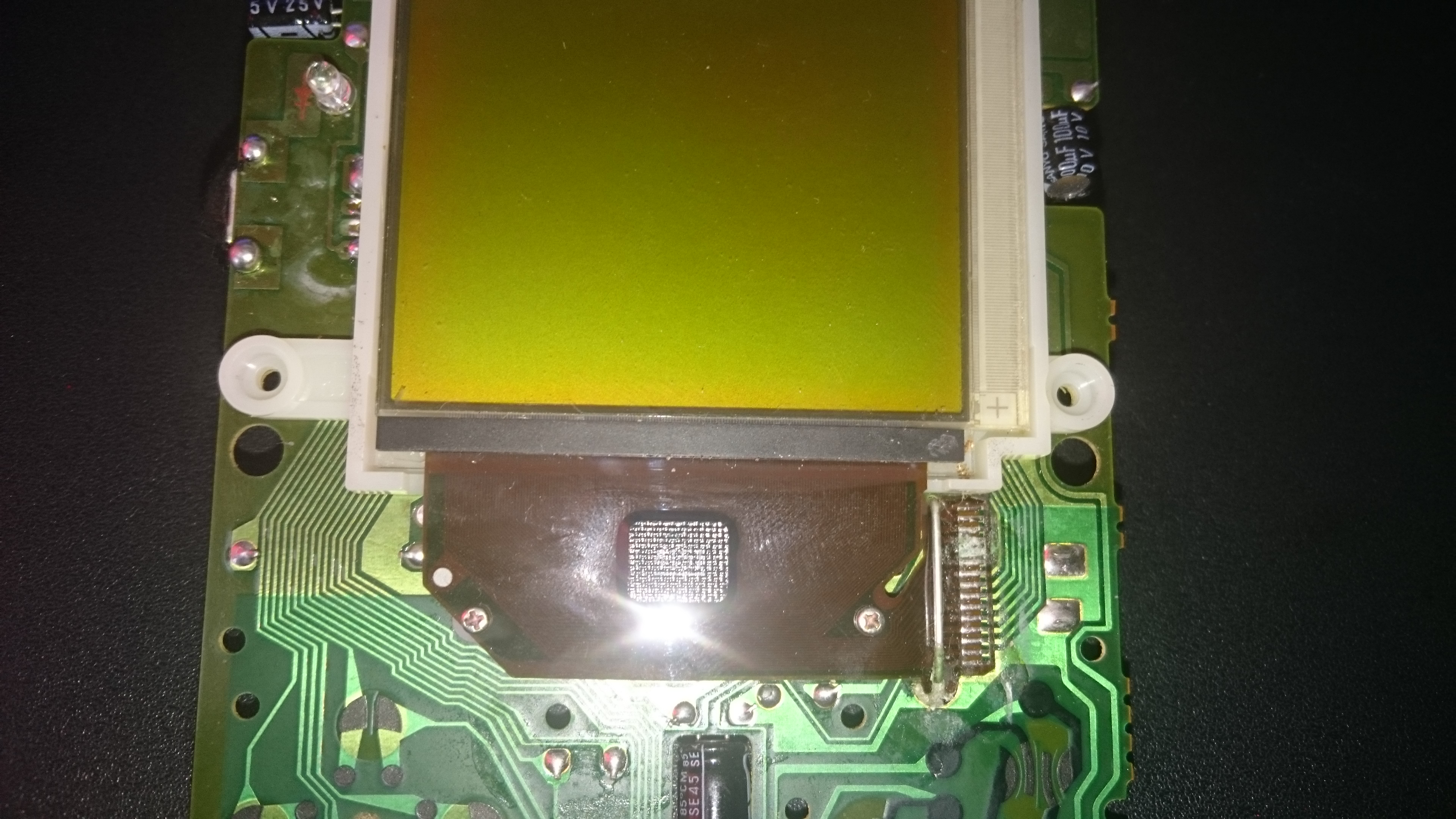

I also saw some oxidation today in daylight on the ribbon where it connects to the pcb and on one of the retention. will try to clean this up:

I've had one DMG that looked similar, showing the same oxidation where the ribbons connects to the PCB (it was actually much worse). I was never able to get that one to work, but it never powered on like yours did, since yours actually powers up hopefully you have more luck!

im giving it a nice cleanup treatment now it's drying. gonna resolder the lcd completely when it dries off tomorrrow

Post by Pap » Fri Sep 08, 2017 11:32 am
a little update: the solder points on ribbon lcd to board were super corroded after the cleanup it was much more visible. tried to desolder the ribbon it was undoable. the corroded pins were stuck to the board. RIP DMG
