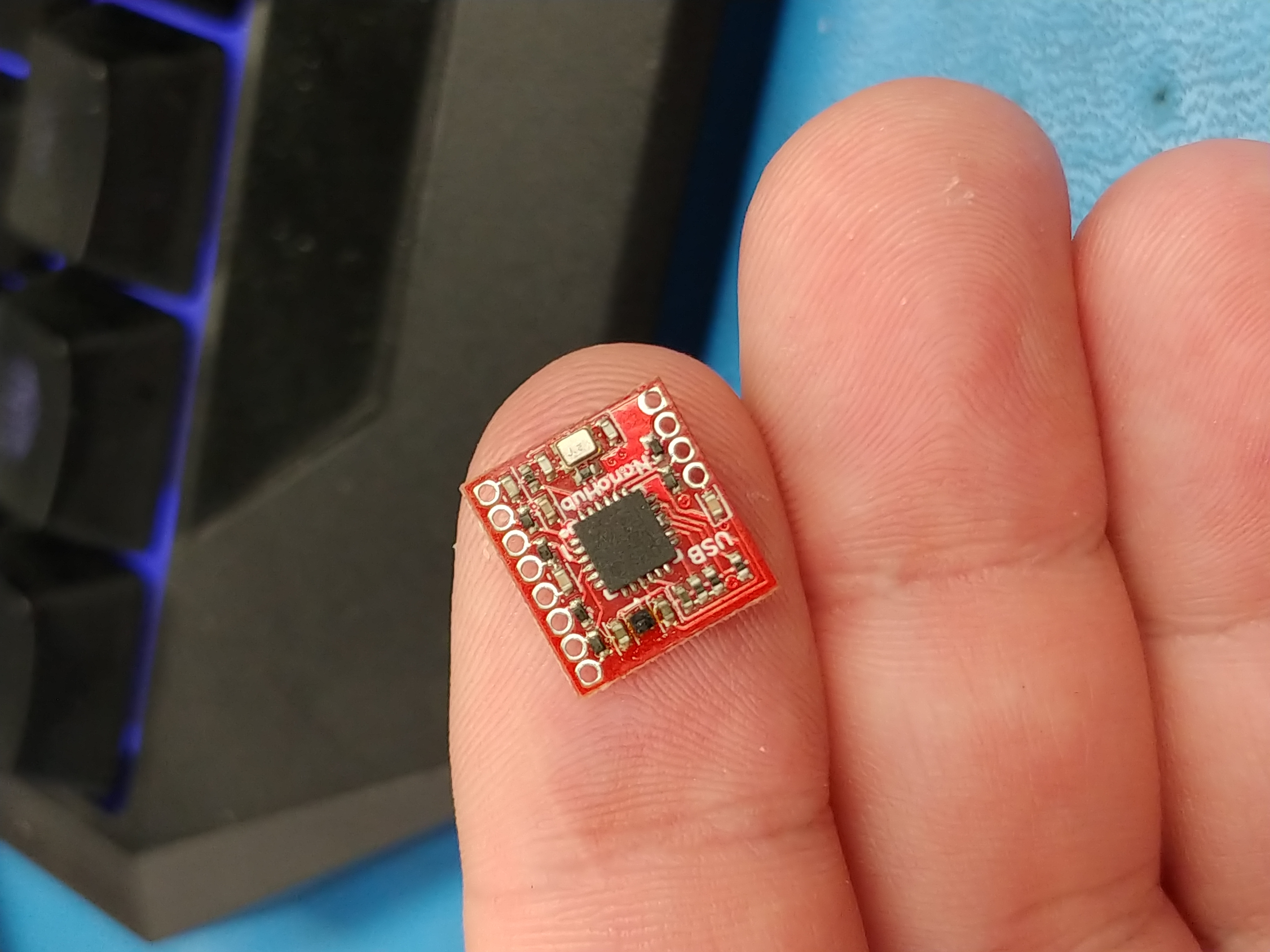

Post by SumCanadianGuy » Mon Jun 04, 2018 7:49 pm
This is what I have handy. I can get more if needed. There is nothing on the back.

Re: Nano Hub 2.0 Wiring
Post by VeteranGamer » Mon Jun 04, 2018 8:37 pm
based on this (image from his tindie listing)....
(i'm assuming by looking at it that its identical to the one you have)
this would be the appropriate pinouts.....
but its not that (its misprinted on the hub in his listing)
this is the correct pinout for the hub....
heres a diagram showing you the upstream port and the two (side by side) downstream ports
hope this helps....

Thanks a lot! I did notice that print on the original and thought it was weird that the data lines would be swapped on one port. My board I am assuming is identical but the traces on the back side looked a little different so I wasn't sure. It would not make sense for him to have changed the output layout imo but he did not state anywhere on the site what the revisions were for and I just did not want to fry any of my components.
