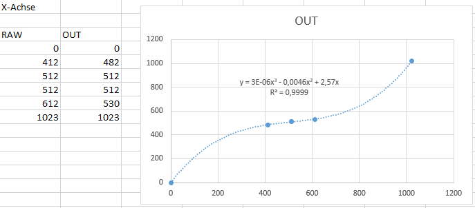

Visualization of the non-linear calibration. The function I used in the code is a more accurate fit using MATHLAB. Dont use this formula! The stick would be at 561 (off-center) in rest position.
