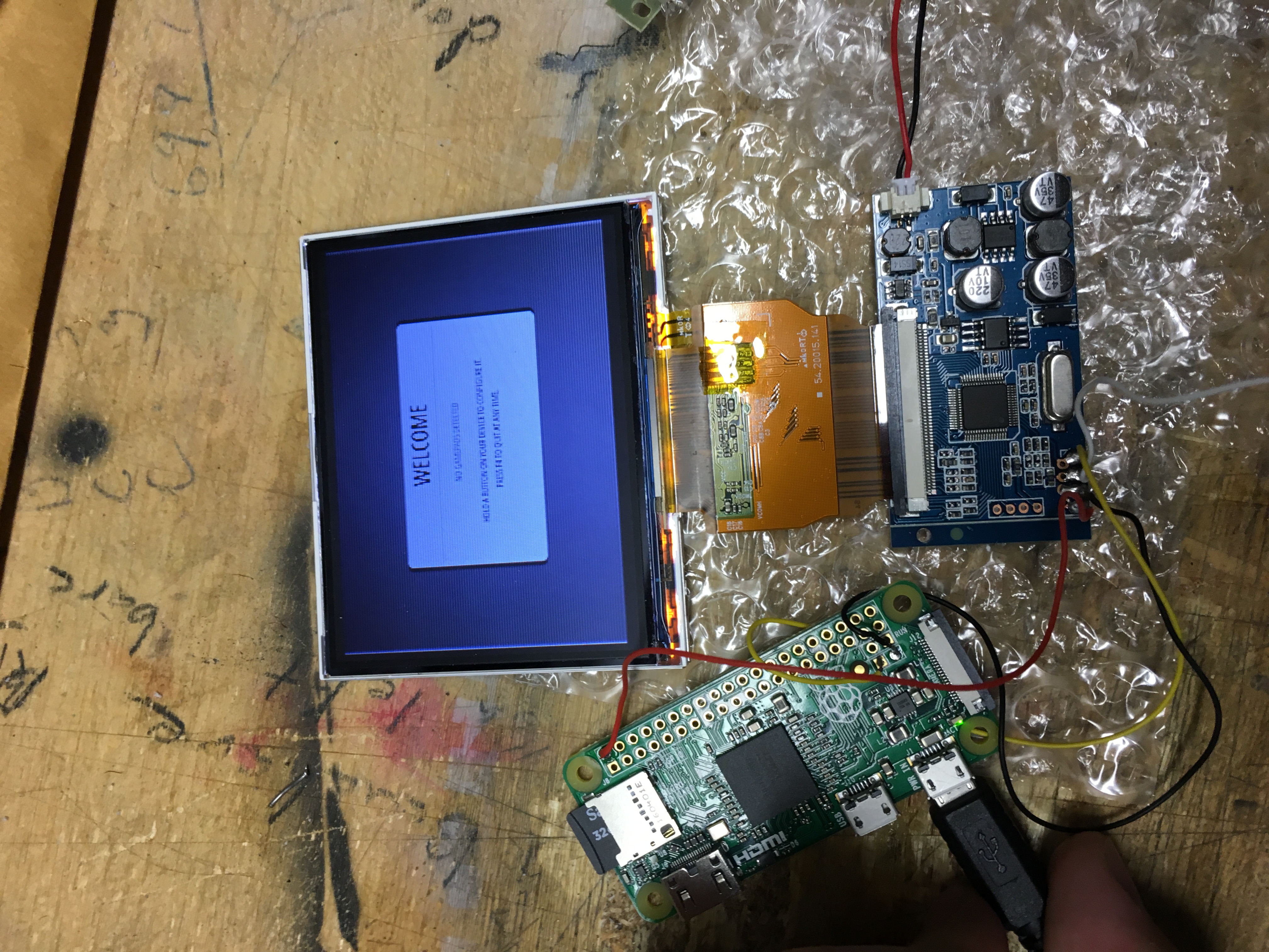

I have wired up my screen based upon Felders post. (http://www.sudomod.com/forum/viewtopic. ... =lcd#p9839)
I dont have the adafruit monitor i have the BW one so I wired it up but the text just isnt readable. Is my voltage too slow? or did I wire it to the pi wrong?
Also there is a bit of noise on the screen. There are waves pulsating from top to bottom

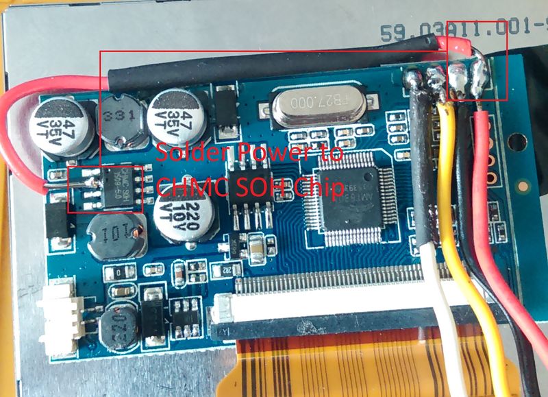

Can't help with the text size I'm afraid, however the screen phasing you mentioned can be fixed with a jumper wire:
(Image taken from Sudomod Wiki)
Had the same issues myself (BW screen Variant 7, same as yours by the looks of it). You don't even need to remove any chips!

I solved the screen noise issue by removing the IC chip before running the bypass wire, also if your running another device as well as the screen from the same power point that will cause a little noise as will having the power wires to the screen too long make them as short as possible.
