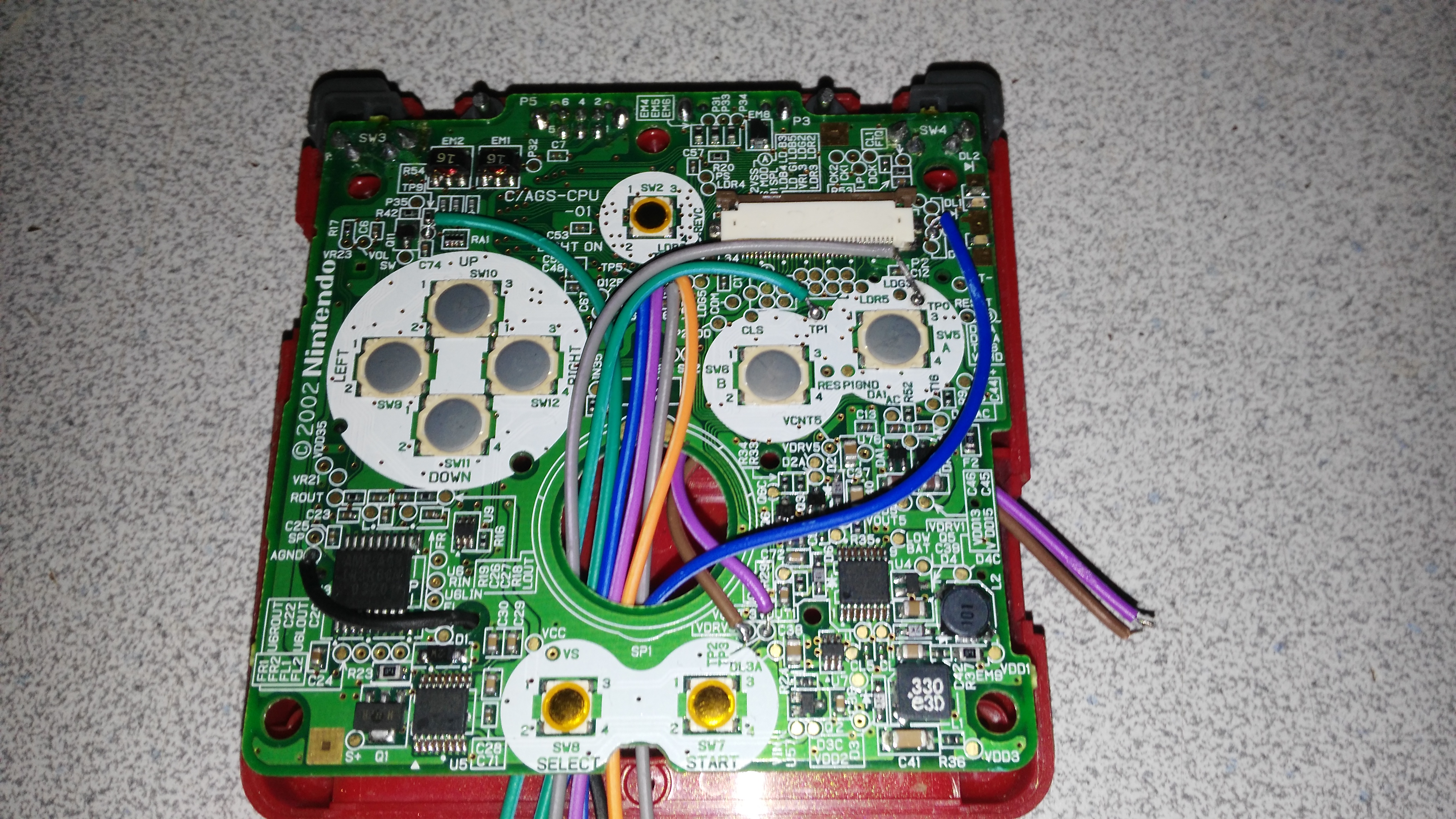

This one is just using the original PCB for the buttons. I have not connected them to the pi yet but I get proper signal when I use my volt meter so I assume it will work :P I have chosen to forgo a speaker so I could run the wires but ill still have audio with headphones.

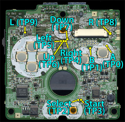

This is the image I found online that showed me where the button solder pads were.
I am going to try to get the screen i'm using to display properly today then move on to connecting the control wires to the Pi so I wont need a teensy :P
