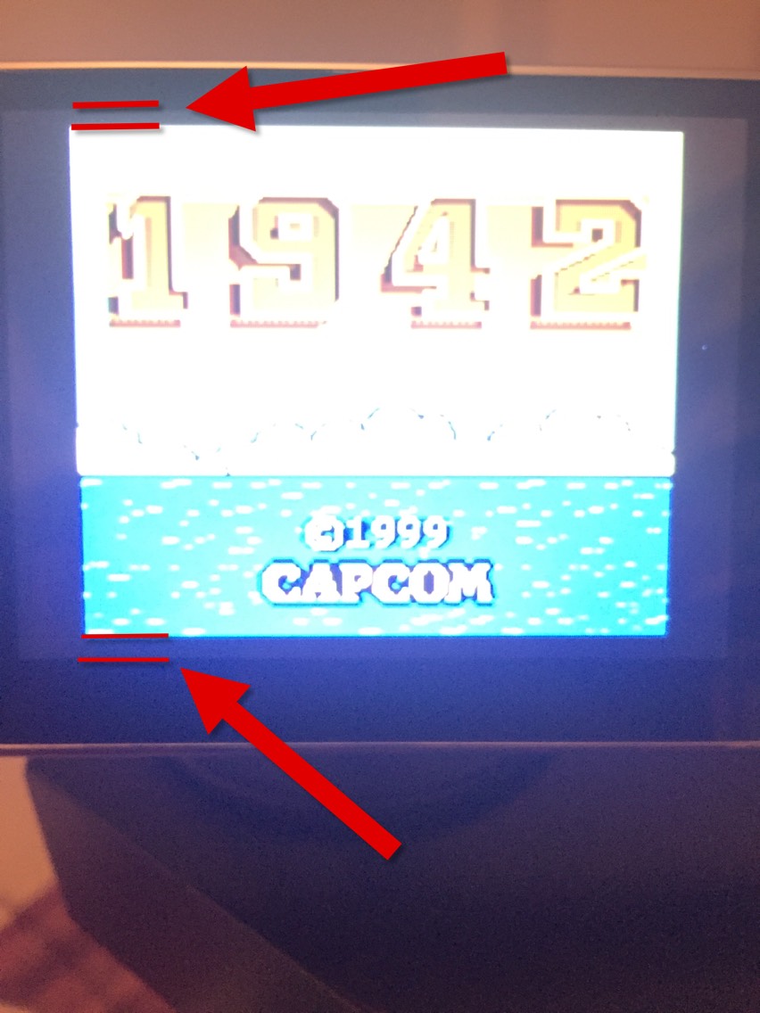

Hi all I got my aliexpress 3.5 " lcd screen it has 272*480 pixel resolution. I connected it to pi zero to try but I discovered today it has empty black pixels on top and bottom. here is the picture of it.
I changed the config. txt to framebuffer as 272*480.
Do you know how I can change this to use that pixels. It is not only limited to games it also happen in emulation station system selection screen

You need to adjust your Overscan in your config.txt :) Here is a similar post I had and ABH had some great resource links to share. hope this helps.
http://www.sudomod.com/forum/viewtopic.php?f=12&t=1294
