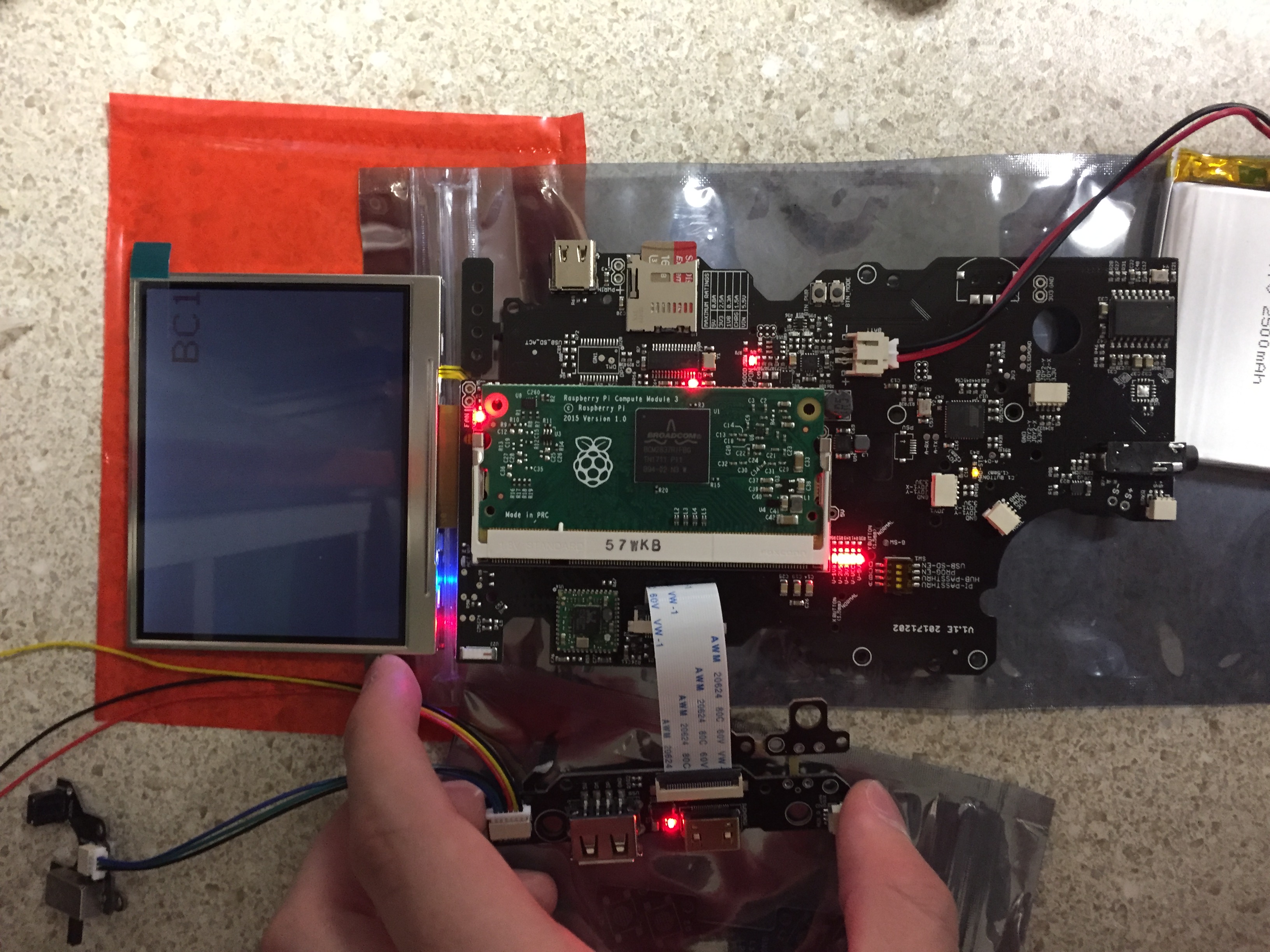

I have plugged in everything in order to perform a test start up before I put the case together. But the screen only shows 'BC1' when the power is turned on. What did I do wrong and how can I fix this?
Solution: Use the pre-made image from the Circuit-Sword GitHub page :)

The "BC1" is just print on the LCD protector thing, not actually being displayed :) have you imaged the SD card? How have you done that?

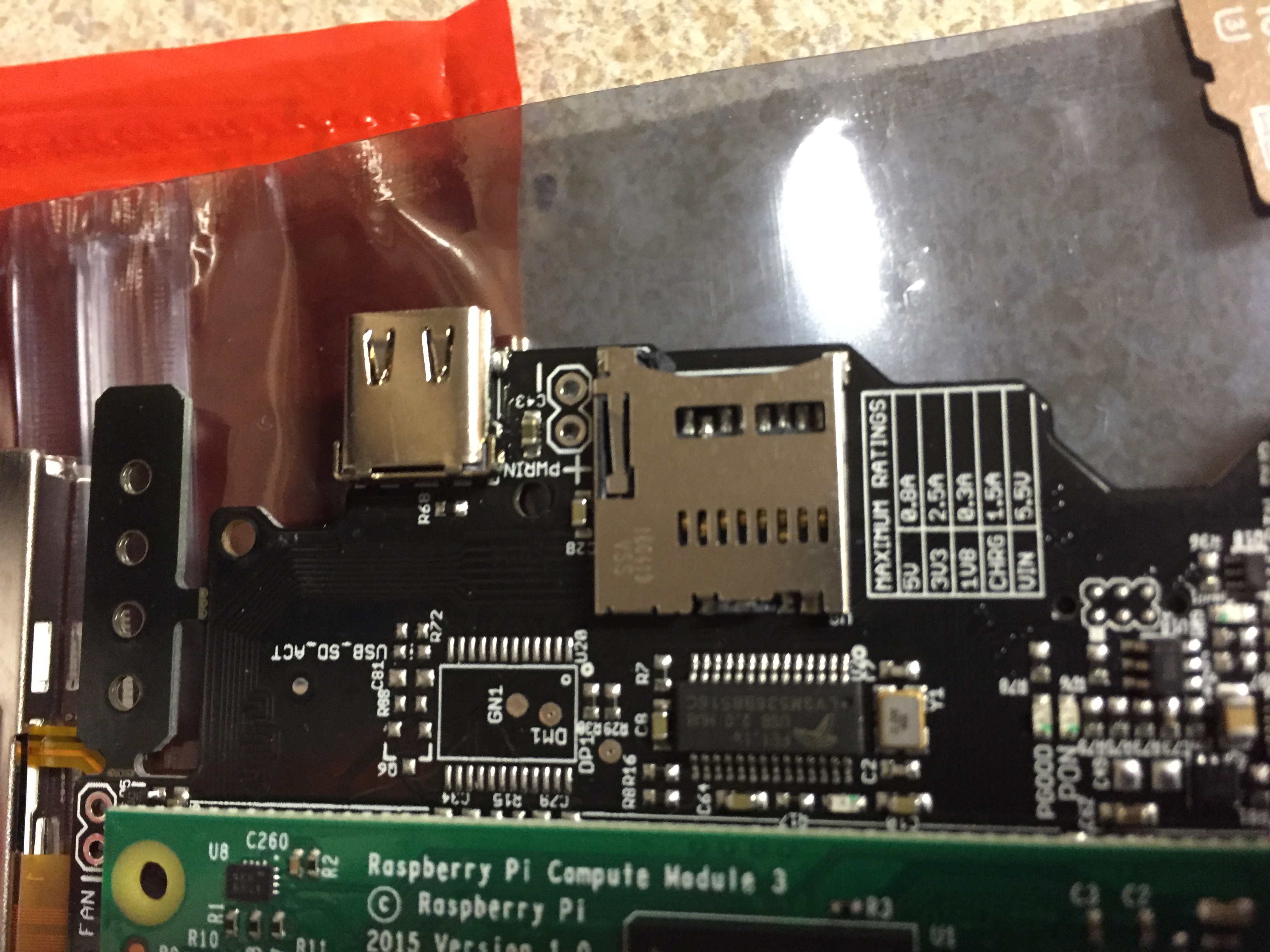

Can you remove the SD card and take a picture of the SD card holder from above. You can see it has some holes in it where you can inspect the actual pins that are soldered to the board.. ideally need a closeup of that to make sure all the legs are soldered correctly

Post by Aaron4317 » Fri Aug 03, 2018 10:53 am
I hope this helps
