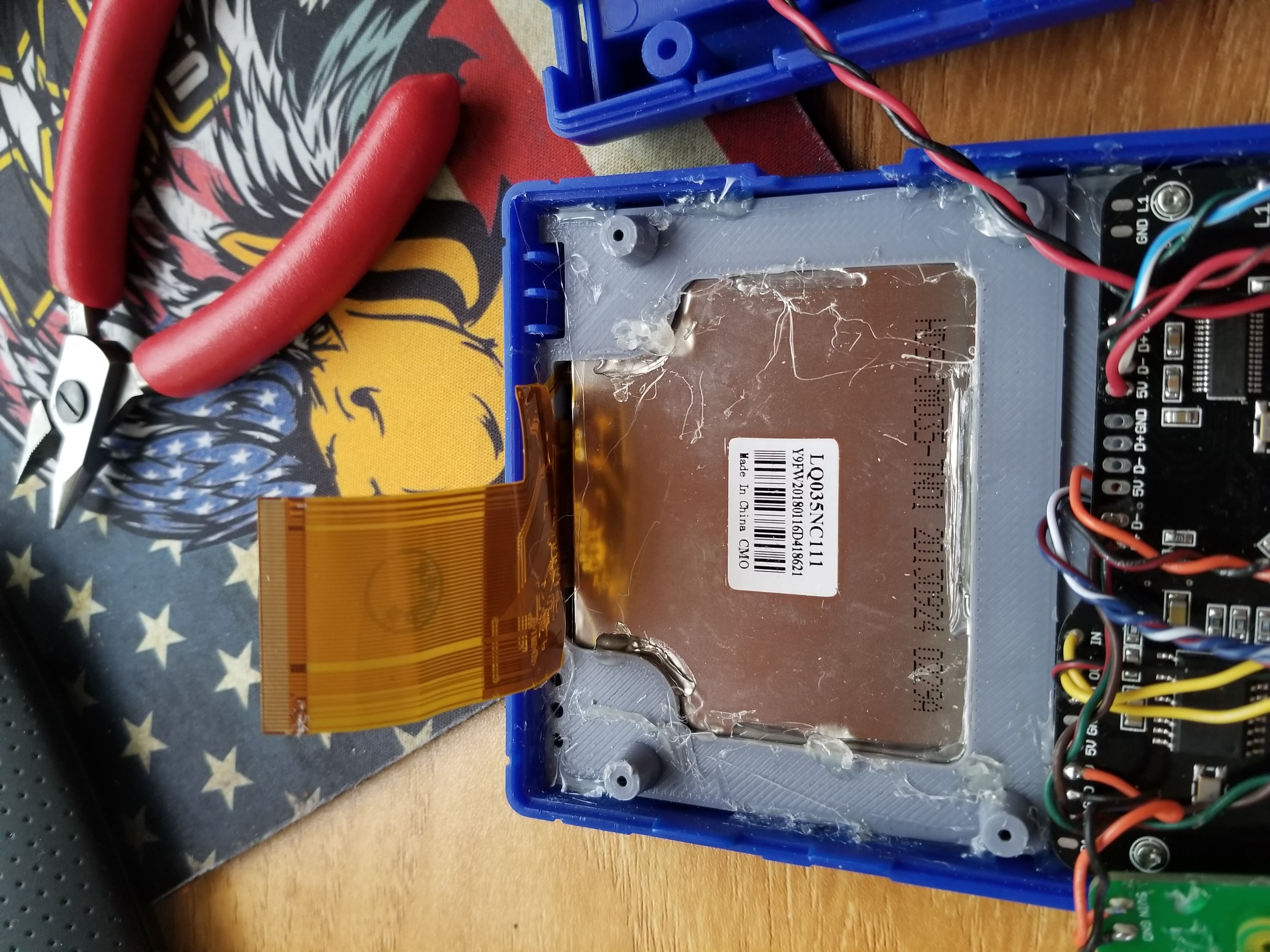

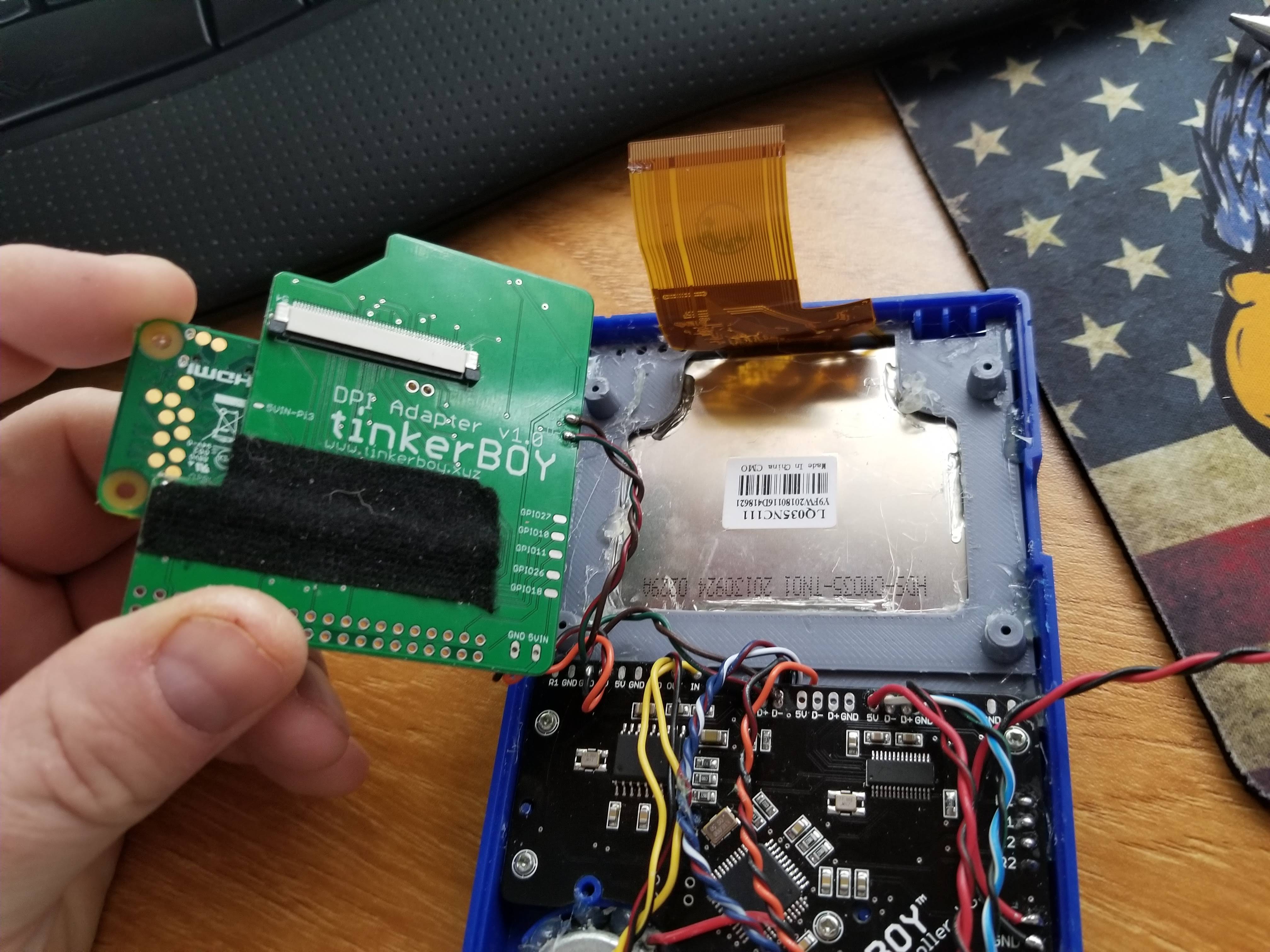

I have a GameBoy Zero I'm working on.I had to mount my LQ035NC111 upside down to get it to work and now when I try and plug in my ribbon cable its not correct. What Am I doing wrong to get this thing together? Looks at my picture to see my screw up somewhere down the line.

Im pretty sure with that tinkerboy adapter, you'd have to insert the ribbon cable so that the copper contacts face up.
with your screen inserted upside down, the ribbon will not insert in the correct way.

Second that. There’s a different bracket that allows you to instal the screen with the ribbon cable at the bottom. That’s the one you want. Also, if you’re freaking out because you already hot glued everything, let me save you a headache; 98% isopropyl applied with a cuetip. Softens the glue so it’s easly removed.
