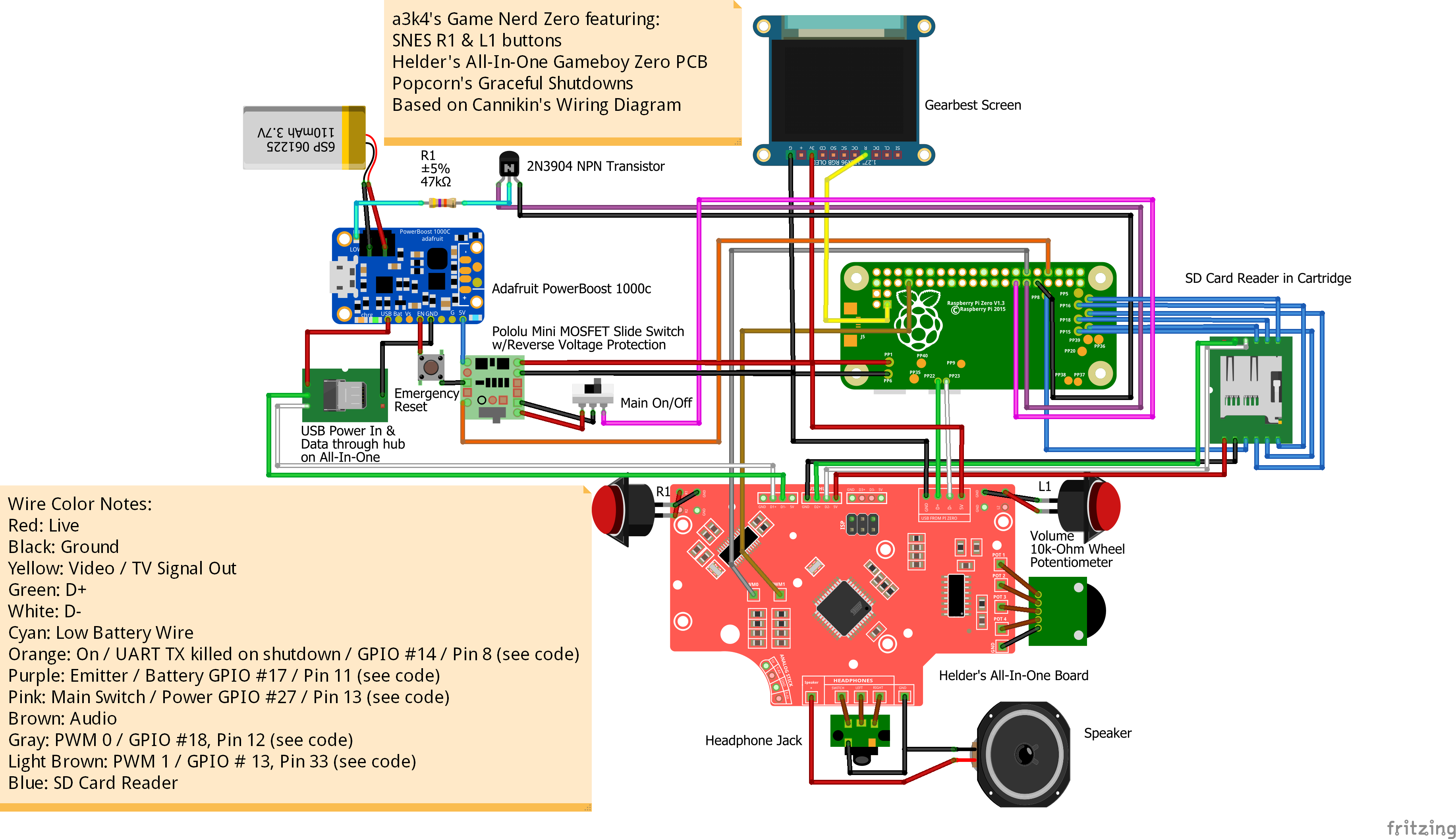

tronicgr wrote:Anyone has suggestion for the potentiometer we can use for the amplifier. I know it's 5pin but how much kiloOhm? Is 10k enough?
Thanks
Thanos
I just measured the original GB version and it's 10k. I bought some on ebay :
http://www.ebay.com/itm/2-10K-Ohm-Thumb ... Swqu9VRHcN

I found this somewhere before ( I had it in my saved photos, Sorry if I cannot give credit for it).
It looks like a 10k might be fine.
Thanks
Thanos

tronicgr wrote:I found this somewhere before ( I had it in my saved photos, Sorry if I cannot give credit for it).
Thanks
Thanos
seems to be @a3k4's :) thanks for sharing, looks good !

Thanks for the diagram! Can I ask why we send usb d+ and d- to the sd board?
That is an old diagram. Make sure you use the new one, the old one had wrong connections to the power board as well which can damage something. Updated link below.
http://www.sudomod.com/forum/viewtopic.php?f=9&t=1014
Was just about to post the same thing. @jermzz, @day, @tronicgr please use the new diagram! This older version could short your entire system.
The USB d+ d- to SD card is incorrect, please see the updated diagram :)
My wiring diagrams and schematics for Helder's boards and graceful shutdowns.

jermzz wrote: Thanks for the diagram! Can I ask why we send usb d+ and d- to the sd board?
Also, I believe Helder said that the speaker and headphone output is wrong in this diagram.
In the old one or even in version 2?
Both

Here is a wiring diagram made with Fritzing for my board BUT the speaker output is wrong
it should be like the image below for Speaker output and Headphone connections.
