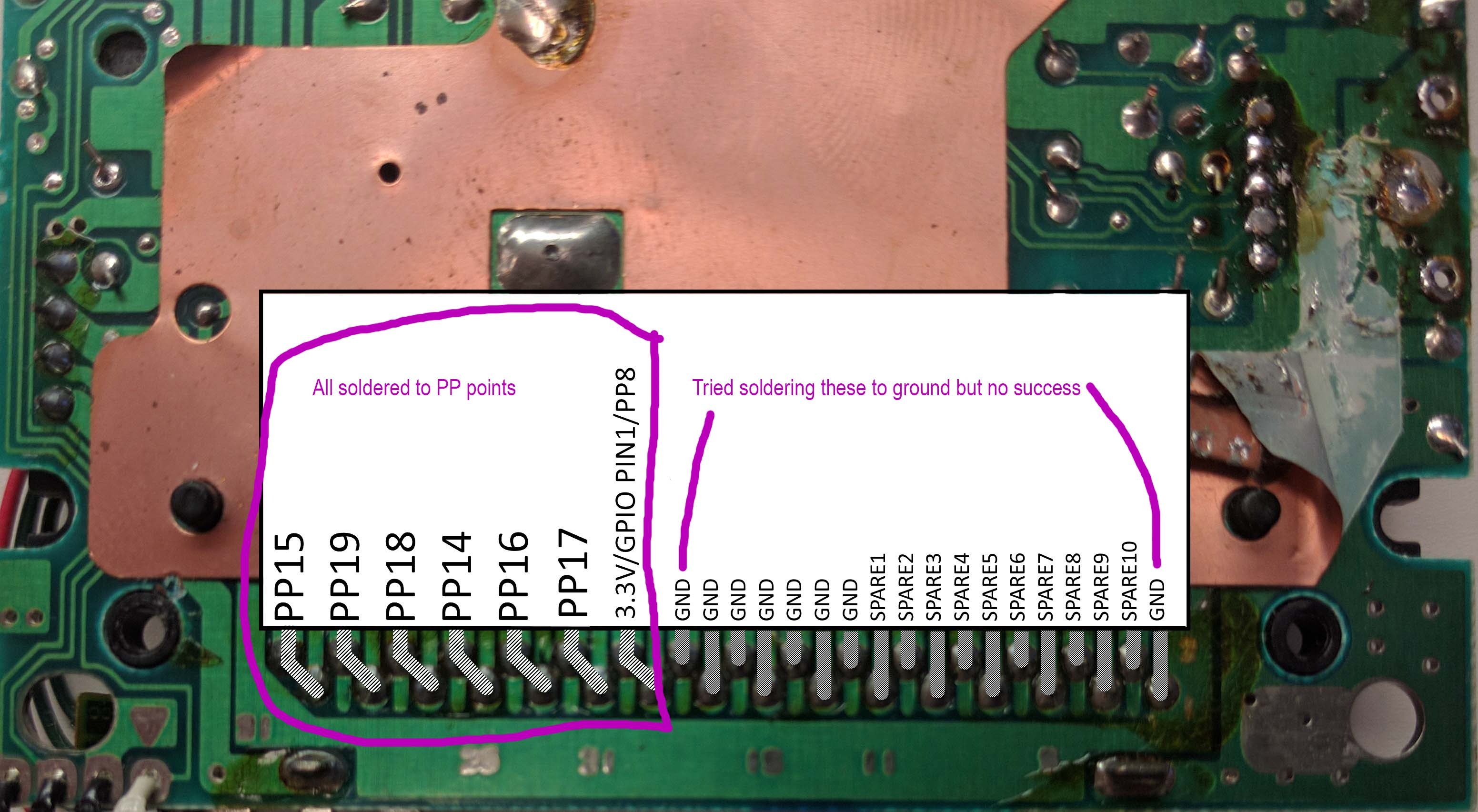

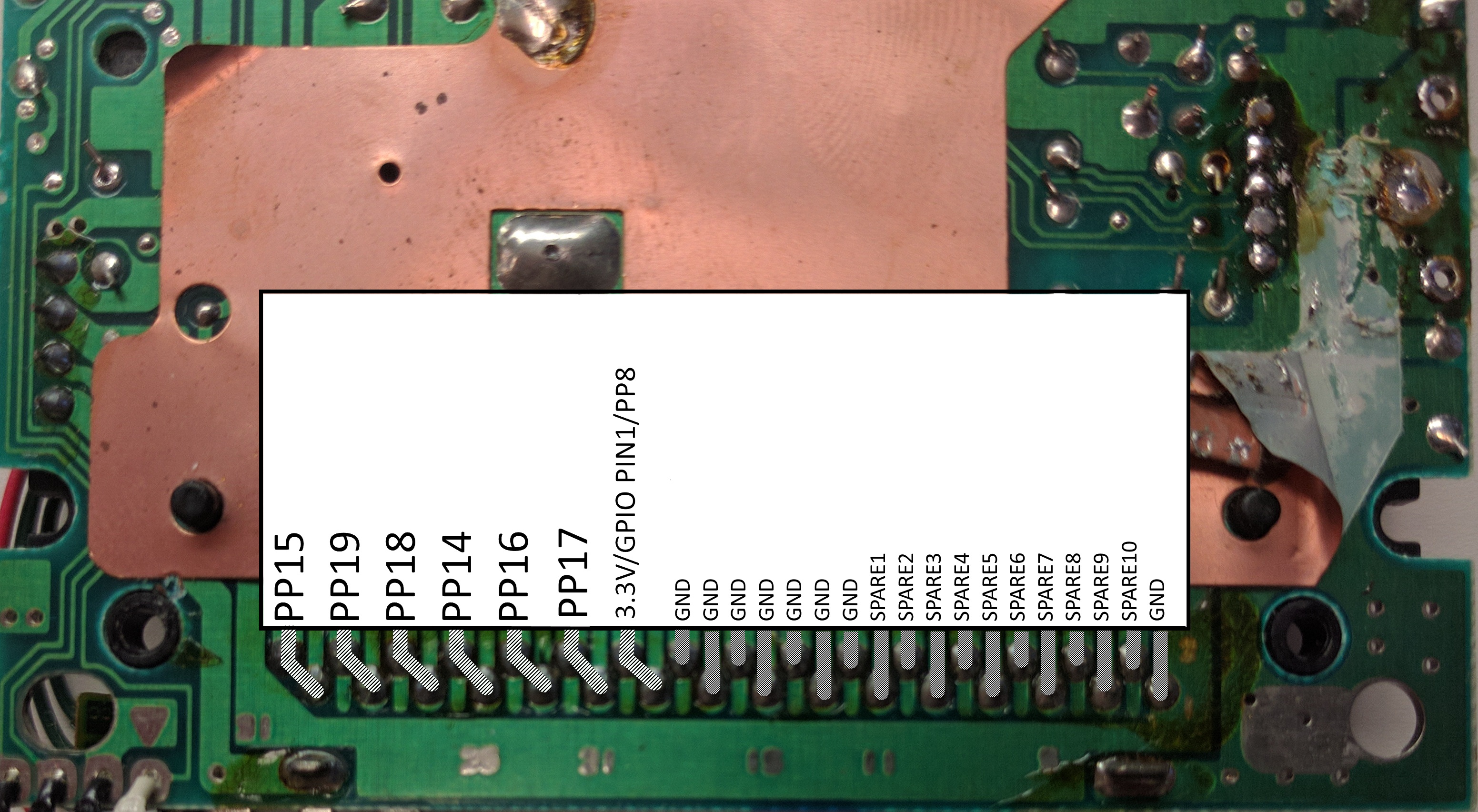

prerunnerseth wrote:
Yes! just remember to remove the connector from the board first. It wont work with the card edge connector still soldered to the original game boy board
Yeah I know, after half an hour of solder sucking then busting out the dremel got the damn thing off.
I gathered from your posts in the thread where I found the pic, that first lot of pins should be soldered to 2 pins to reduce the impedance or something, but it still works if you soldier them to single pins. Right?
exactly
cartridge pinout.jpg (1.28 MiB) Viewed 10054 times
Hey I'm having some problems. I've wired everything like the picture (pp15/pp19/pp18/pp14/pp16/pp17/pp8) but it doesn't work, the pi's light is flashing like it's booting but no image on the screen, and I know everything else works fine as when I put my sd card directly into the pi it works without any problems. I was wondering, I noticed wormy has 8 wires going from his card reader to the pi and I only count 7 on yours, am I missing something? do I need to run a ground wire? I've tried running a ground wire from the ground (the pin after where you have labeled 3.3V/GPIO PIN1/PP8) and no success, then I also tried grounding the last pin of the cartridge connector, again no success. I feel like I'm missing something.
exactly
YOu defintely need 8... and that would be the ground pin. Did you remove the connector from the game boy board?

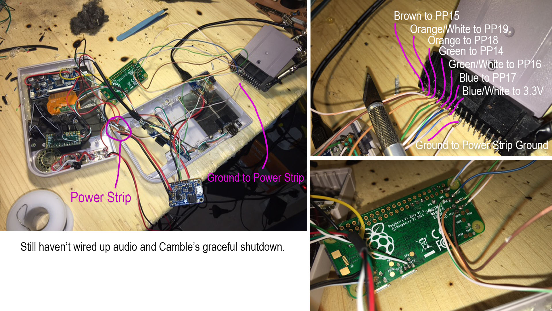

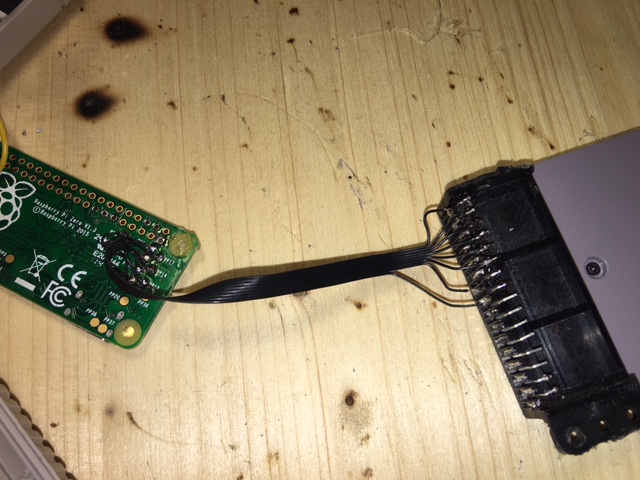

Post by KrxXxiT » Thu Sep 15, 2016 12:41 pm
I've re-wired the cartridge reader to use single pins as you suggested a short, I swapped PP8 for 3.3V GPIO.
Still no luck.
Here's some pic's I've put together with labels. If you want a more high def pic, let me know.
my wiring.jpg (403.42 KiB) Viewed 10028 times

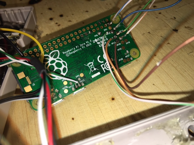

Here's a close up of the pi's wiring:
Forgot to mention; yeah I have a multi meter and I've checked continuity between the cartridge, cartridge reader, and pi, as far as I can tell it's all fine, and I'm using the wires from an Ethernet cable.

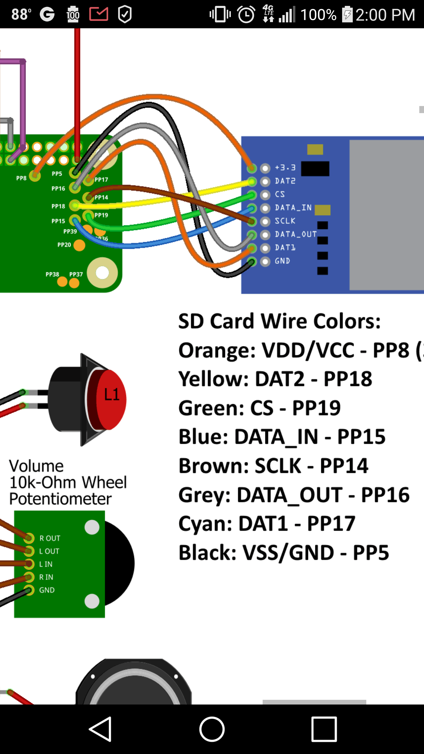

Post by msykos » Thu Sep 15, 2016 1:02 pm
Your missing the ground wire to pp5, it does not go to the power strip ground.

Re: [SHIPPED] PRS-TECH Micro SD Cart board with Advanced Filtering

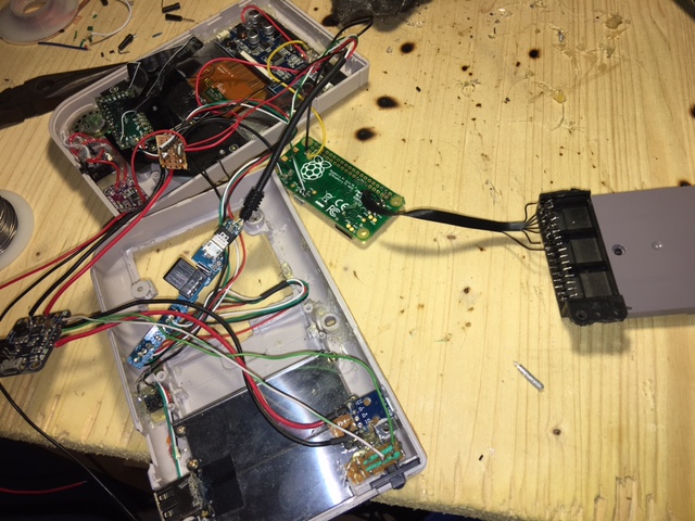

Post by KrxXxiT » Thu Sep 15, 2016 2:31 pm
I removed all wires, chopped a 10cm piece of ATA ribbon cable and wired it up the same but using PP5 as msykos said, now works flawlessly :)
I knew I was missing something simple... 2 things:
1) my wires were probably too long.
2) I did not know PP5 was ground and that the power strip ground would react differently.
Thanks @msykos for the tip
And thanks @prerunnerseth for helping
Now I can move on to finishing up the audio and graceful shutdown :D :D :D
Here's some pic's of my amendment to the wiring:
