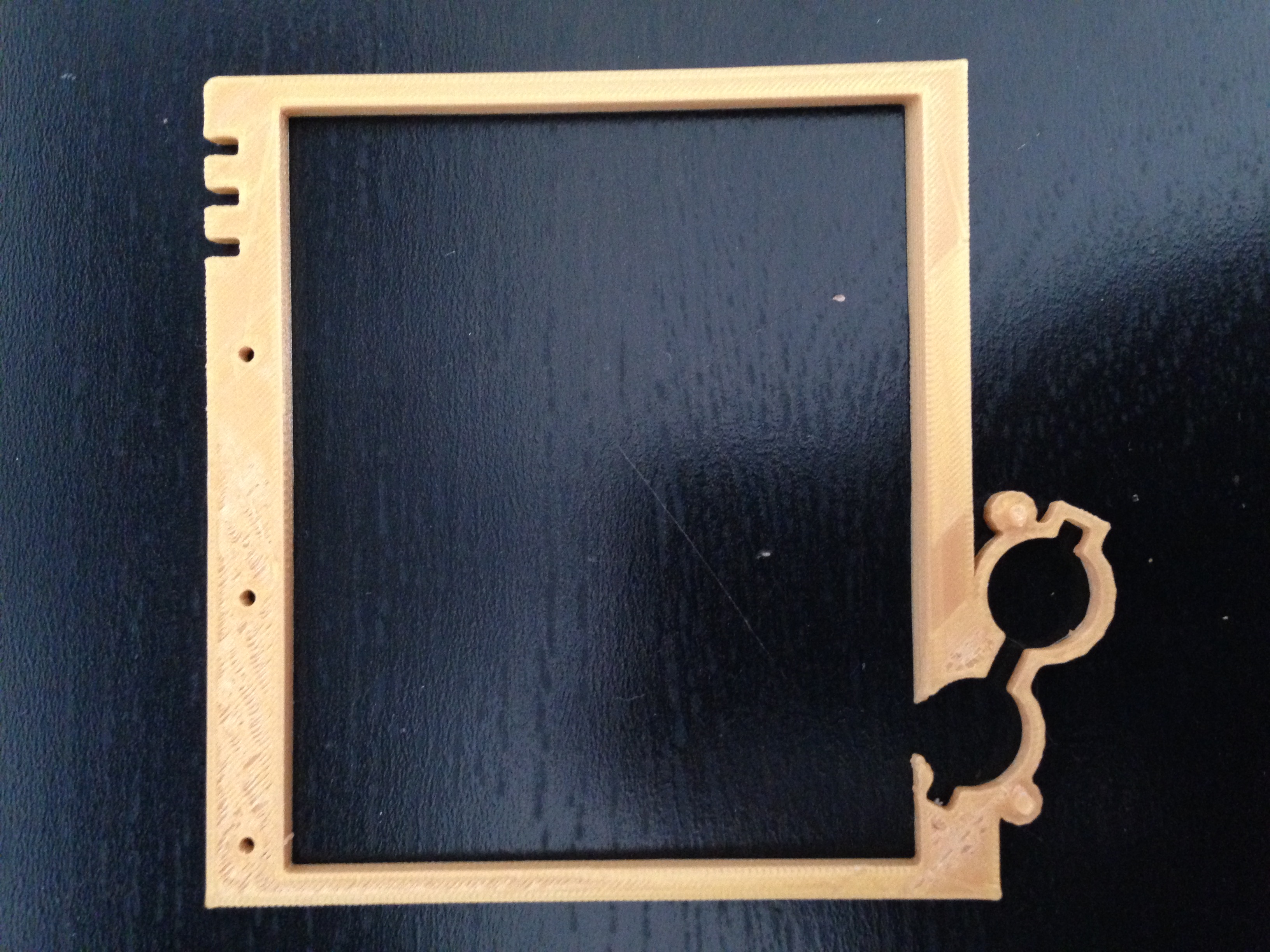

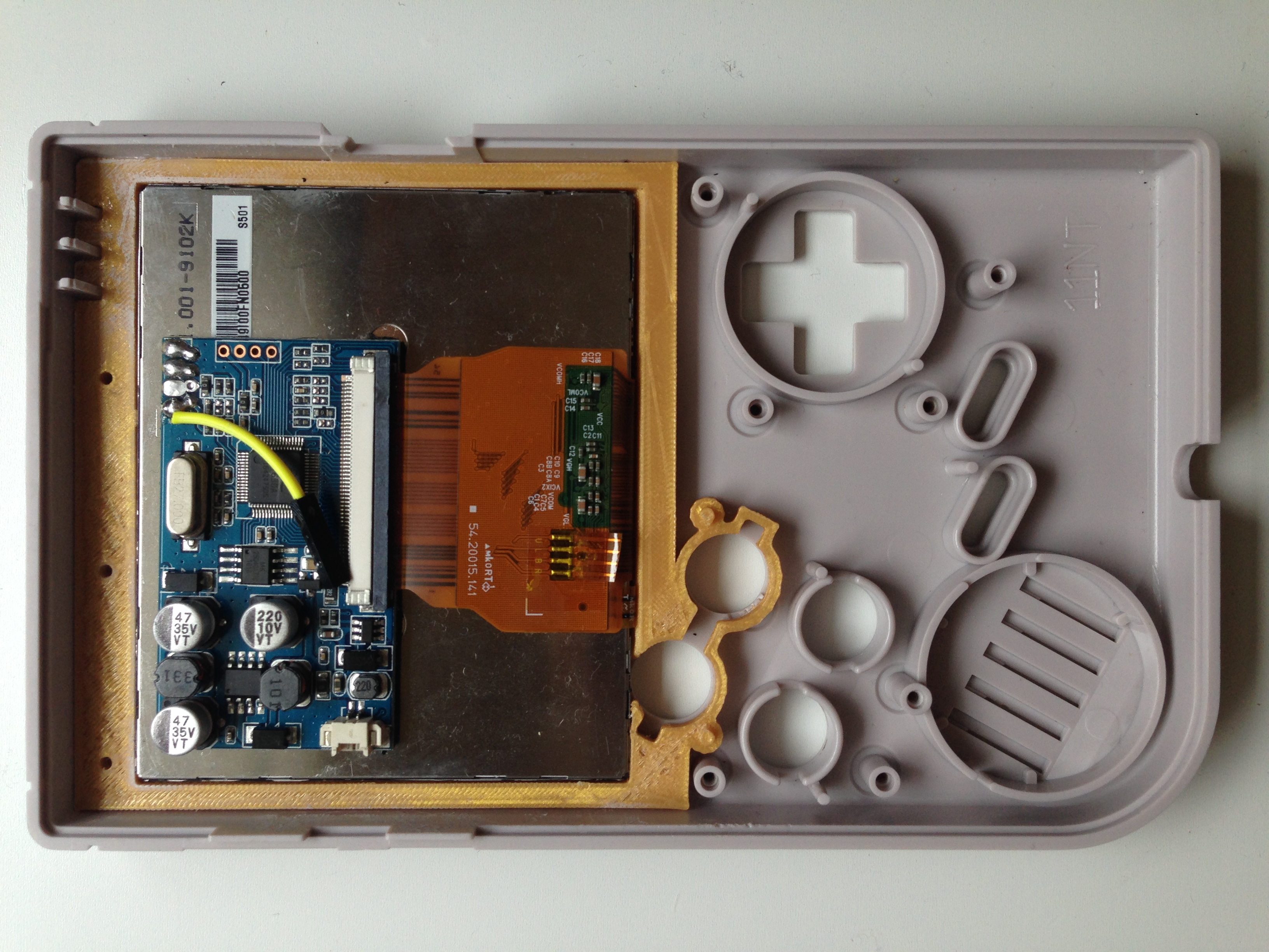

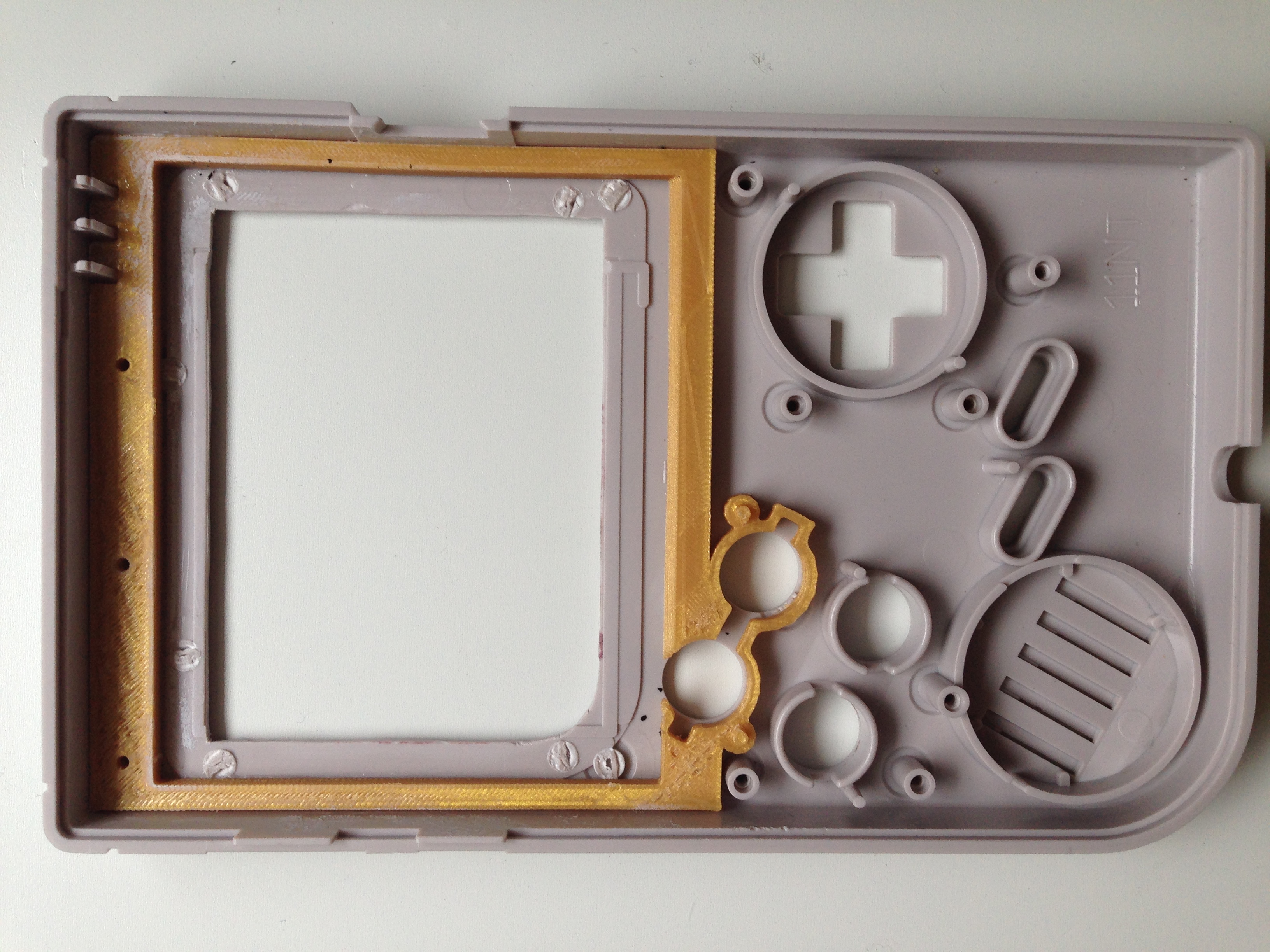

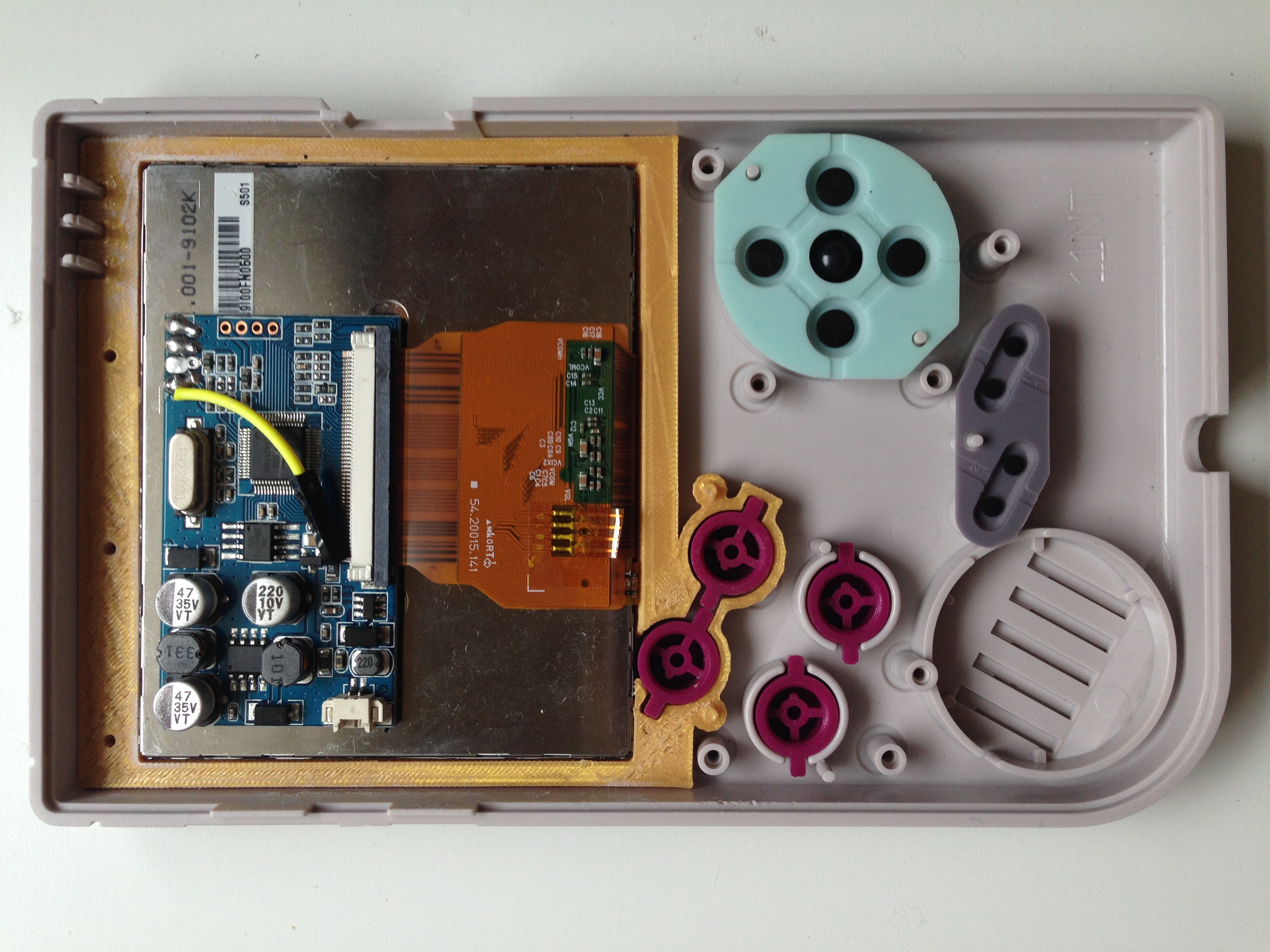

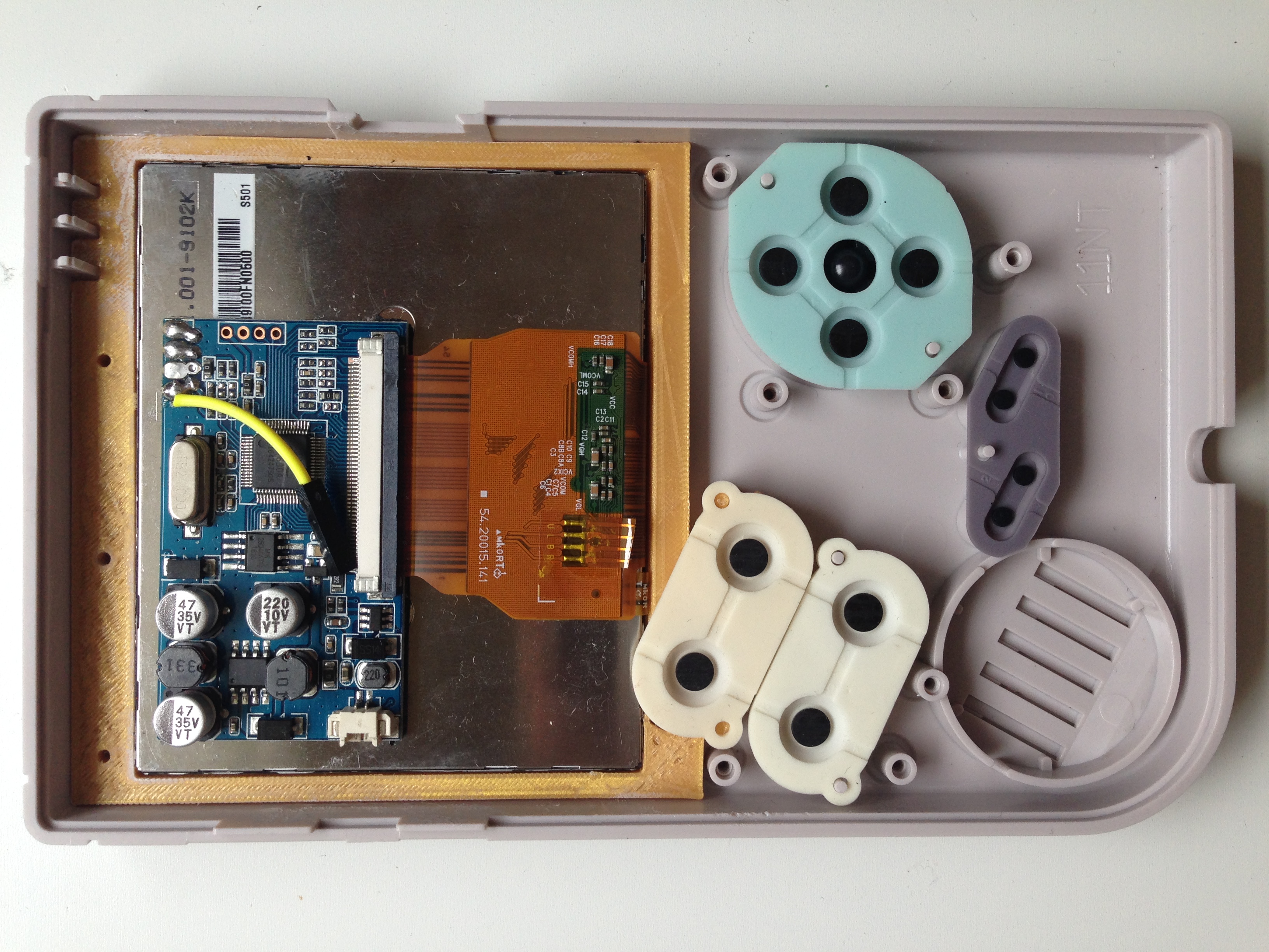

This is a frame for the screen that I designed to use on my personal Game Boy Zero project based on the project by sudomod, I added support for the extra two buttons and It will be a platform for other two layers that will hold up the raspberry pi zero and the powerboost board. I recommend to use epoxy to have a clean and strong adhesion.

I got a question, have you thought about multiple break out for different sizes on screens. Some of these back up camera tend to sometimes be bulky on the side or even the top and bottom. Maybe a way to do sized break outs on height adjustments could be a general thought? Another comes to mind on building a simple way to build a bridge across the top so the screen's board and screen are touching while in the Game Boy? I really like the idea and would love to see more structures pressure fitting parts together instead of common ideas on 1 big board to rule them all.

Those are great ideas and definitely something that I may try to do in the near future. When I designed this frame I did it around the parts I already had and I wanted an all around frame that would also provide more area of structure for additional layers and the pats for the case screws.
Maybe eventually as more people produce reviews on my design I will be able to modify it and make of more general use.

So I downloaded the STL files and printed them - they fit great in the original DMG case!
However, a word of caution to anyone with one of the aftermarket cases (like the black one from Wermy's custom build). It seems the inner dimensions of those cases are slightly narrower than the original case which makes this part too wide to fit properly (I dont have a caliper so I can't get a precise difference but seems to be around 1/2 mm narrower).
Since my 3d modeling skills are pretty limited (and I don't have a printer myself - had to use 3dhubs.com) I'm planning to modify the bracket with some sandpaper / dremel but thought I'd give a heads up to anyone considering this for their project.
Also, I'd recommend printing the bracket at something like 100 microns, I had mine printed at 200 microns and it's a bit flimsy in the controller bracket area (I think it should still work but it doesn't look as robust as the photos here).
