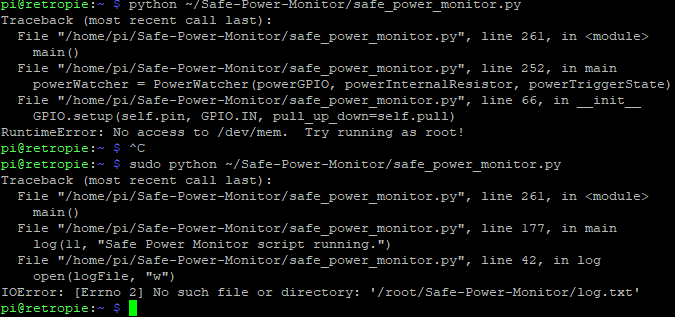

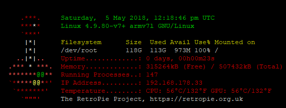

Hi guys,
when I start the script (python ~/Safe-Power-Monitor/safe_power_monitor.py) the following error appears, with and without "sudo". anyone have an idea?
thank you very much!
EDIT - SOLVED-: I use another retropie image...and it works fine.

Re: [For Sale] Safe Shutdown v1.0 for BangGood/GearBest/Generic power Supply
You can issue this command and see if it fixes the error:
$ sudo touch /root/Safe-Power-Monitor/log.txt
