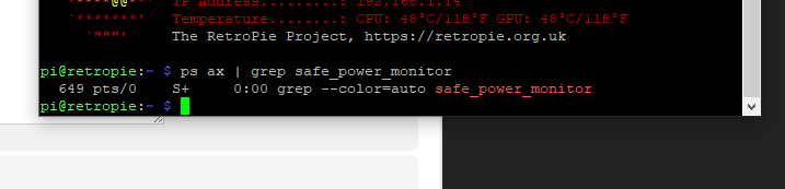

Ok. I'm back. I reopened my GB Zero, flashed the SD card to star anew, enabled WIFI and SSH, then got to work. Before adding the script the switch worked like a regular on/off switch. Then I followed the instructions here: https://github.com/Camble/Safe-Power-Monitor
I changed AdafruitPowerBoost = True to AdafruitPowerBoost = False
then I added dtoverlay=gpio-poweroff:gpiopin=22,active_low="y" to /boot/config.txt
To be honest I can't remember if I had to do anything special here to add the script to startup. It just says add the script to startup.
EDIT: BTW, the way it stands now it still doesn't work.
EDIT2: I did as you suggested.

This grep output shows that the script is not running, so clearly there could be nothing working.
Please check the section https://github.com/Camble/Safe-Power-Mo ... the-script ... There you see that it has to be added as a cron job in your crontab by executing this line:
echo "@reboot /usr/bin/nice -n 19 /usr/bin/python ~/Safe-Power-Monitor/safe_power_monitor.py" >> mycron; crontab mycron;rm mycron
Than reboot and do this grep command again. It should show more than only itself
hth

OMG! HOW DID I MISS THAT? I read the entire thing. Had it working on a previous build even! Thanks man. I guess I have some new toys to tinker with during my countries self isolation period. Stay safe people!
EDIT: And it's a dud again. Sometimes it works sometimes it doesn't. Oh, well I guess it's better then nothing :P
