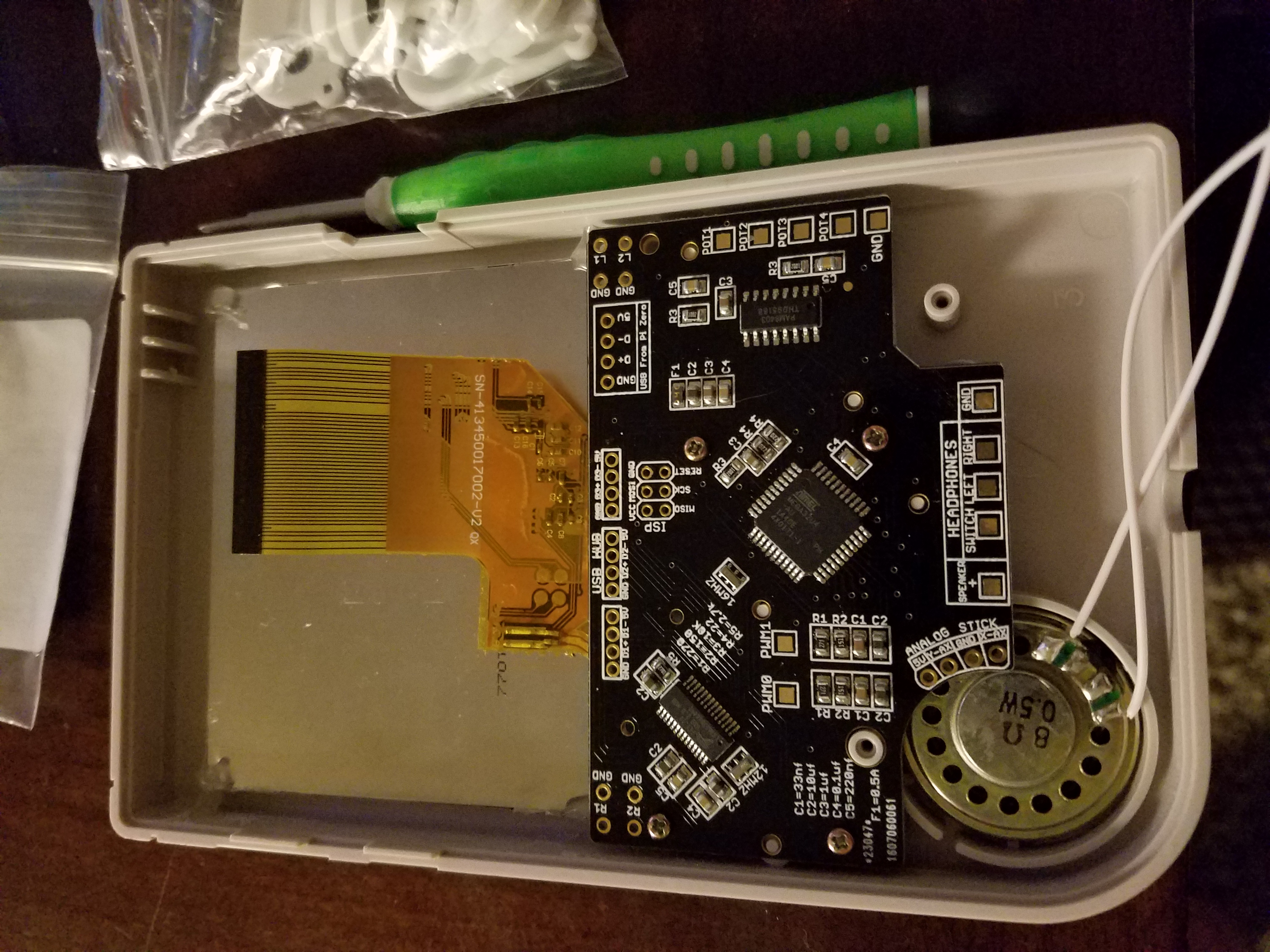

All right, I figured out what it was. I didn't have a potentiometer on it, so no connection was made. Currently I have pot 1 connected to 3 or 4, and pot 2 connected to 3 or 4 with jumper wires. I used a male to male headphone jack, one end plugged into my MP3 player, the other laying on the floor. I touched one wire to one of the top portions, and the other to the bottom, and voila! Sound! However, I still couldn't hear anything when I had it hooked up to the Pi (I think I may have very faintly heard something). I also noticed that it didn't sound amplified, compared to plugging my headphones straight into the player. This makes me think maybe the amplifier isn't amplifying it, and the faint sounds I (maybe?) heard were the un-amplified sounds from the Pi? Just as a side note, if it helps, I had the mini-USB connector connected to the wall for power.

Check you config file is setup properly and you have the correct GPIO pins wired in according to the config file. Also you might need to turn the sound up in the Emulator setup. Post some pictures of the setup so I can have a look.

Hey guys, just posting to say that the adafruit mini metal speaker [ADA1890] seems to fit the AIO board without modification. I put pads down and secured the pcb to the gameboy and there's about 1/16 of an inch clearance. Maybe put some electrical tape to be safe, but if you use an analog you'll probably have to modify as stated by helder. But those not, it seems to be OK.
