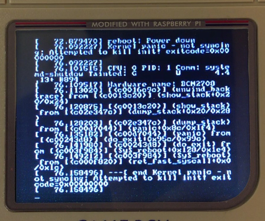

When I shutdown using the switch it seems to initiate a shutdown, however I'm getting the attached on a low battery.
Is there anything you can tell from the photos?

@DarrylUK If using the right script it should shut down properly after playing the video.

It didn't play the video :-/

DarrylUK wrote: It didn't play the video :-/
Are you using my modified script?
