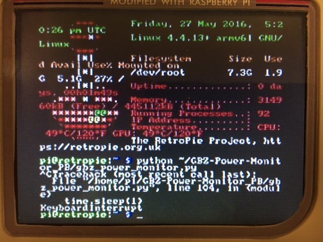

Honestly I have no idea what's happening. I rebooted after posting the video and the shutdown script isn't working.
When I launch the monitor manually via the below:
python ~/GBZ-Power-Monitor_PB/gbz_power_monitor.py
I'm not presented with anything at the prompt (is that correct?). If I power off whilst in this state there's a half second delay or so and then it just cuts power. If I stop the script via ctrl + c I get the attached message. Is that expected?

DarrylUK wrote: I'm not presented with anything at the prompt (is that correct?).
Yes
DarrylUK wrote: If I power off whilst in this state there's a half second delay or so and then it just cuts power. If I stop the script via ctrl + c I get the attached message. Is that expected?
Yes

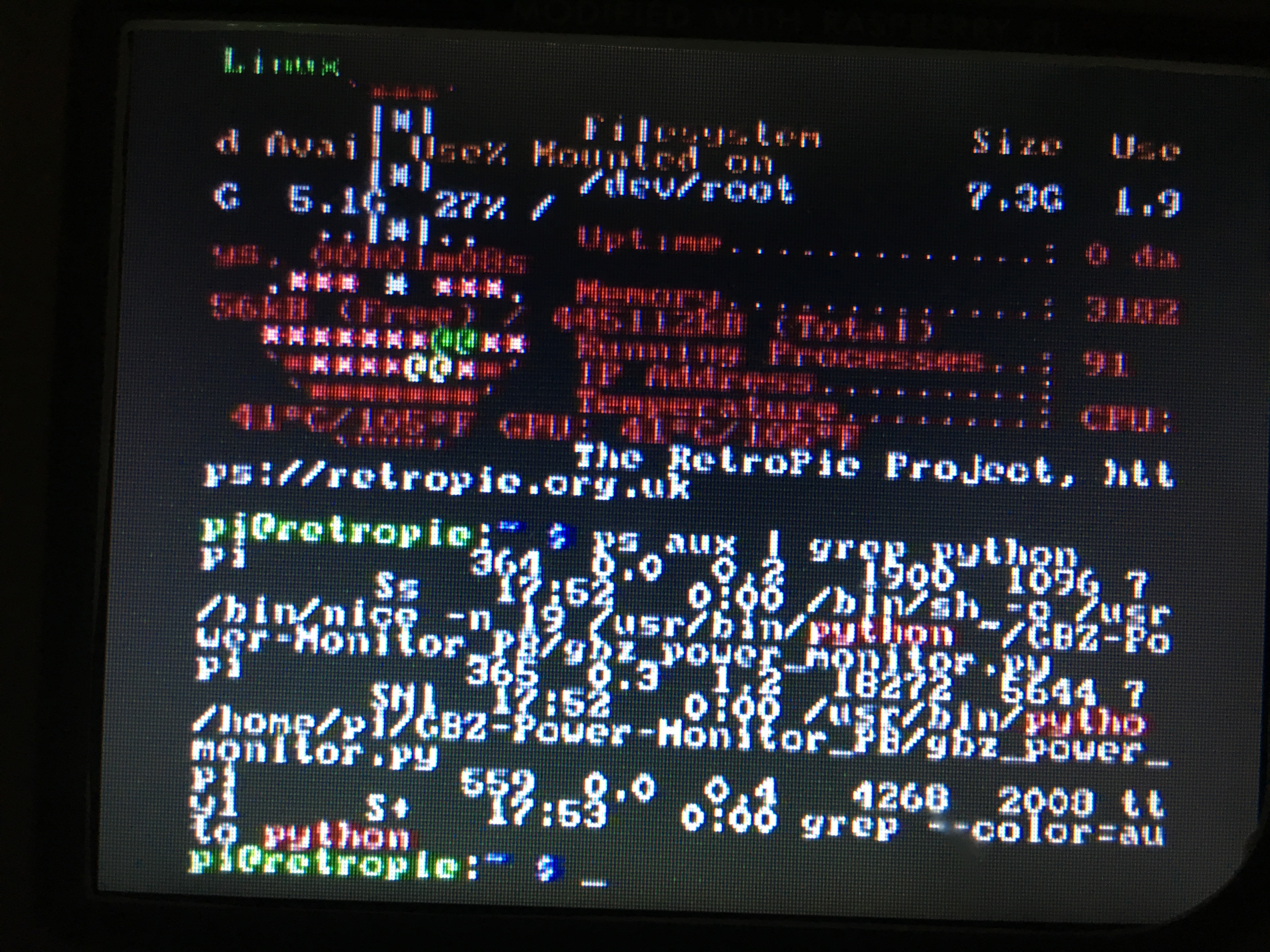

I've removed and re-added it, it doesn't seem to be working at all. Is there a way to verify the script is running apart from physically turning the device off?
Typing, ps aux | grep python, at the command prompt should give you all running Python scripts and their paths.

Thanks for that. I just ran it and it showed 2 instances of it running. I cleared my cron jobs, rebooted, verified no scripts were running, added it once, rebooted, checked again and it shows 2 scripts running.
Does that tie up with you @Camble?
Edit, I'm not sure if it makes a difference that it's being powered on in a low battery state. I'm charging it now to see.

DarrylUK wrote:Does that tie up with you @Camble?
Just set it back up and checked. Yes, it's listed twice.
