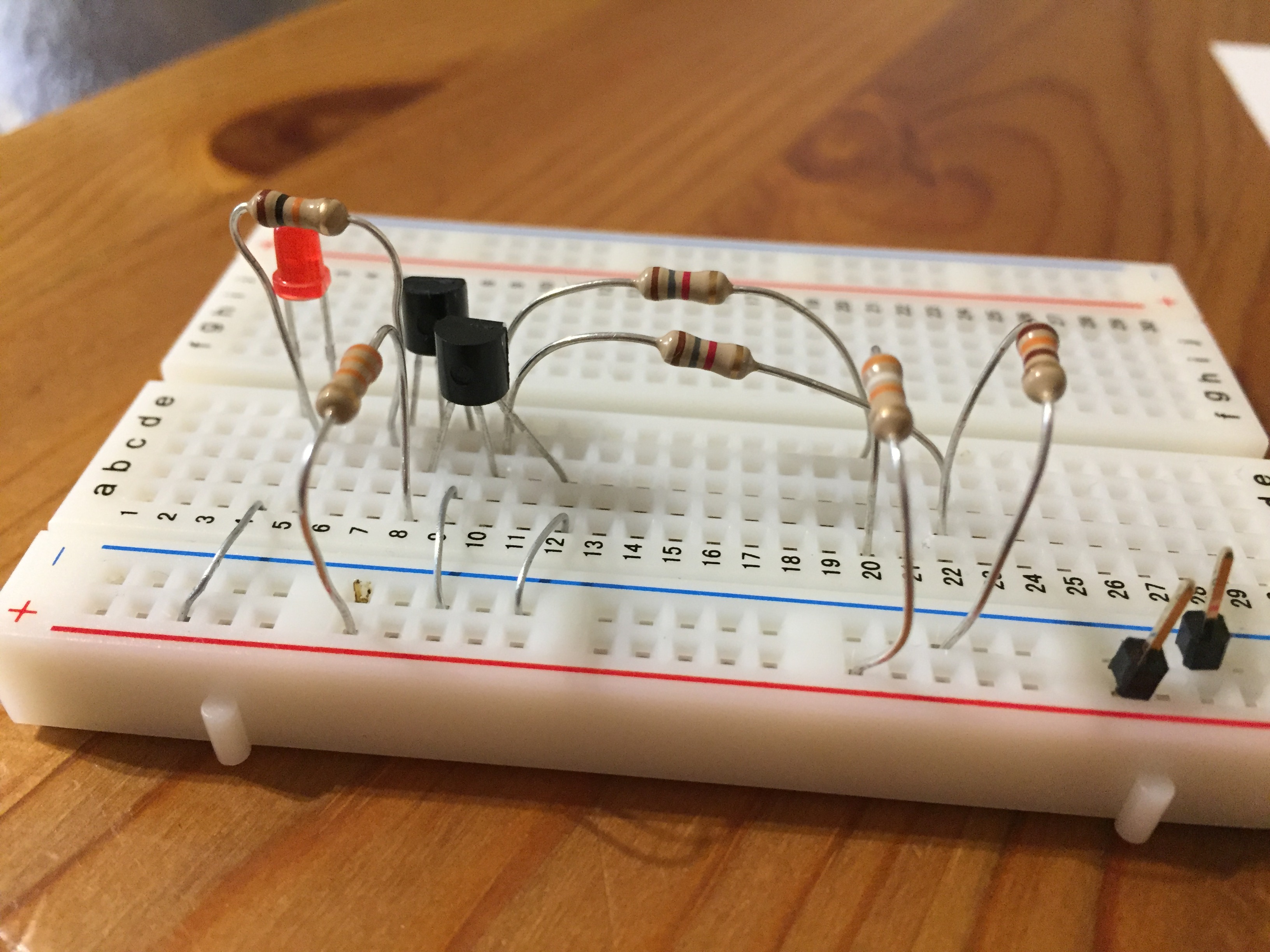

Re: Low Battery LED Indicator Board [OSHPark]
Hi!
I've made the circuit, based on the PCB image, Gerber files and schematic (without the potmeter):
(Sorry for the hand-drawing...)
Should it so working?
Because on breadboard the LED is continuously turned on, not only when the battery is low....
Well if you added the battery positive to the 5V point and the negative to the GND point it should only light up when it's at or below 3.26v.lpepe wrote:Hi!
Post an image of your bread board and are you sure you're using the correct value resistors?

I think, the transistors are the same, that you used:
http://www.produktinfo.conrad.com/daten ... 92_FSC.pdf
- IMG_3225.JPG (1.24 MiB) Viewed 19442 times
- FullSizeRender 2.jpg (1.23 MiB) Viewed 19442 times
Looks alright to me, is your battery charged? do you have a multimeter to show how much voltage it has? Also try a pot like in the first schematic I posted and mess with the values to see when it lights up at the battery voltage when it's low and take the measurements with a multimeter of the POT to get the resistor values.

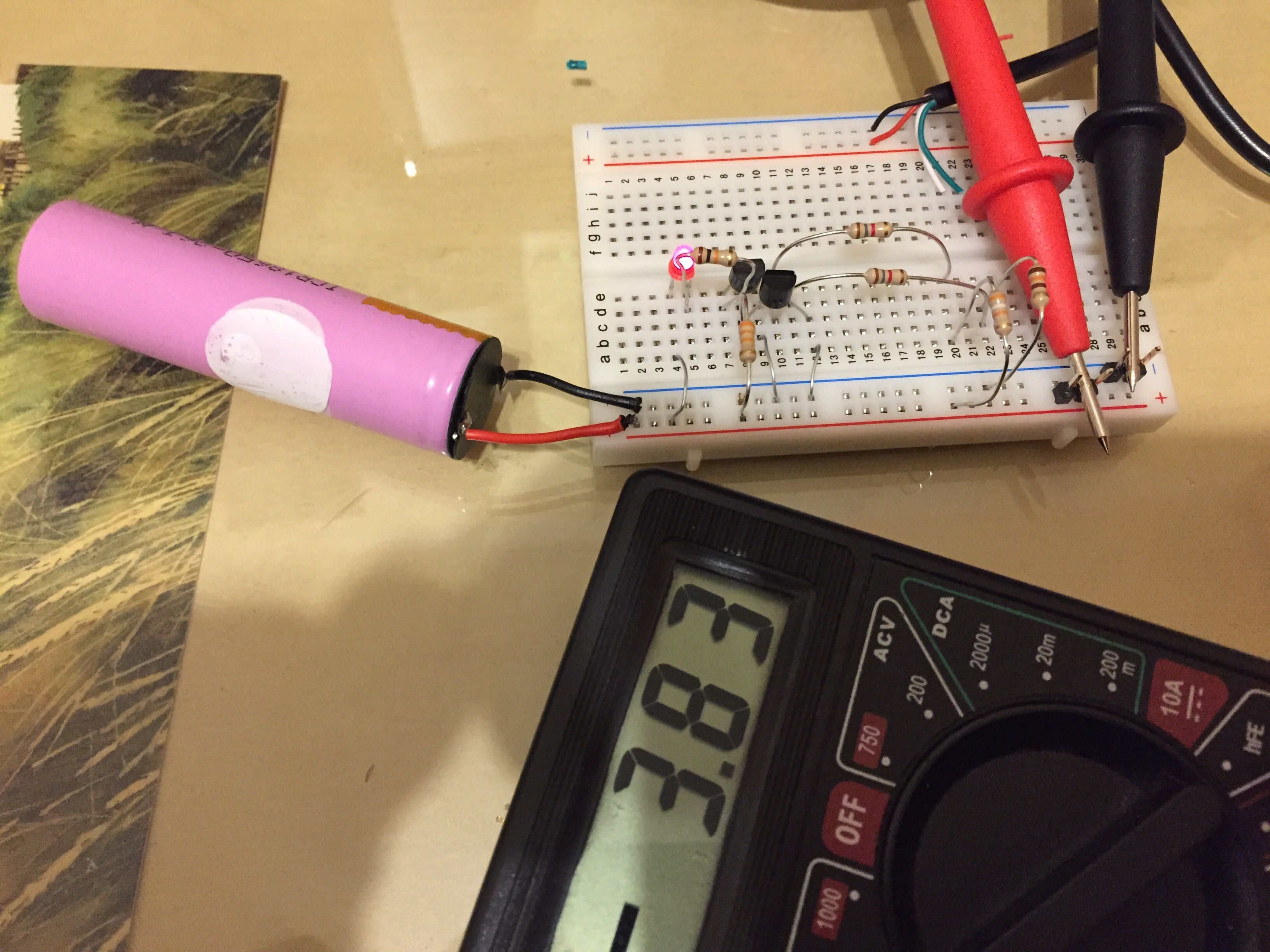

Helder wrote:Looks alright to me, is your battery charged? do you have a multimeter to show how much voltage it has? Also try a pot like in the first schematic I posted and mess with the values to see when it lights up at the battery voltage when it's low and take the measurements with a multimeter of the POT to get the resistor values.
Of course, it's charged. With potmeter didn't tried yet, I didn't ordered one....
I used a 18650 li-ion battery, but I think this isn't the problem? (the battery is brand new Samsung cell...)
- FullSizeRender 3.jpg (1.29 MiB) Viewed 19423 times
