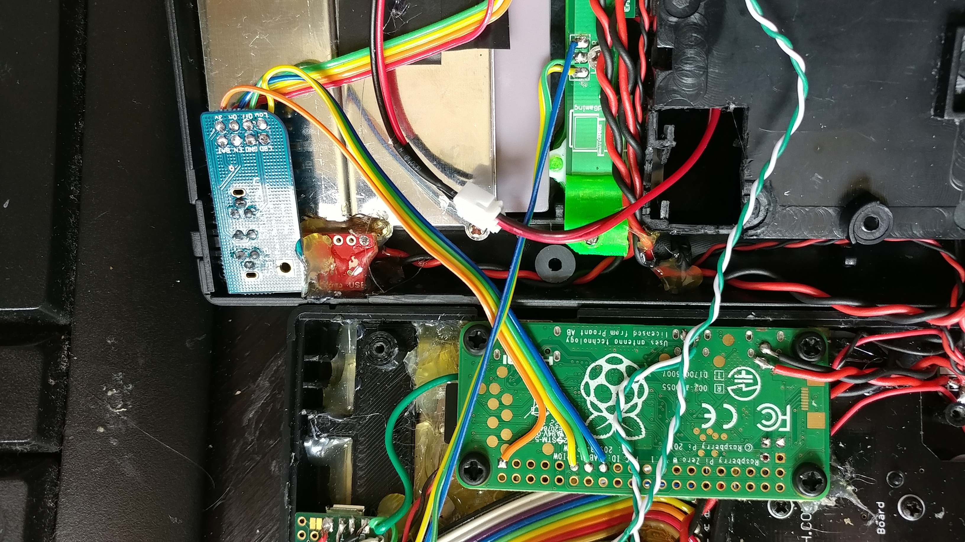

Ok, so I have my safe shutdown (cool little product) V1.2 powerboost.
Got it installed.
Starts the system like it should.
Wont shutdown when I turn the switch off.
If I leave the switch of and shutdown from software I get a kernal panic........
Turning the switch off turns off the powerboost at this point like it should.
Additionally I should point out that both the low battery warning and the startup arrest on low battery dont seem to be working.
When I run python ~/GBZ-Power-Monitor_PB/gbz_power_monitor.py the power monitor comes up and tries to shutdown my gameboy.......but fails. So the battery monitoring is working......
It seems like the power monitor is not running in the background like it should, and at this point I am rather stumped.
Camble
Posts: 885
Location: Scotland
Has thanked: 269 times
Been thanked: 488 times
Re: [Pre-Order] Safe Shutdown Switch (PowerBoost Version) - Closed
Post by Camble » Mon Feb 19, 2018 2:07 pm
@garthster Thank you :) Your wiring to the Safe Shutdown looks fine. I can't be sure of the wiring to the PowerBoost, but you have good connections elsewhere so unless something is in the wrong place, I can't see it being wiring.
The reason you get a kernel panic when you shutdown through software (or indeed on low battery) is because the power switch is still in the On position. An unfortunate side effect that I was unable to eliminate.
Does it work if you remove the components from the case? Please check you haven't got a short anywhere else and remove then reinstall the script.

Ok, I removed the switch and powerboost components from the case, still the same issue. My powerboost lines are wired properly like the pi.
How would I uninstall the power monitor script? Prolly a silly question, but I didn't seem to find instructions for that.
I suspect a software issue of some sort, as the hardware seems to be working as I would expect, but the pi does not shutdown when I hit the switch.
