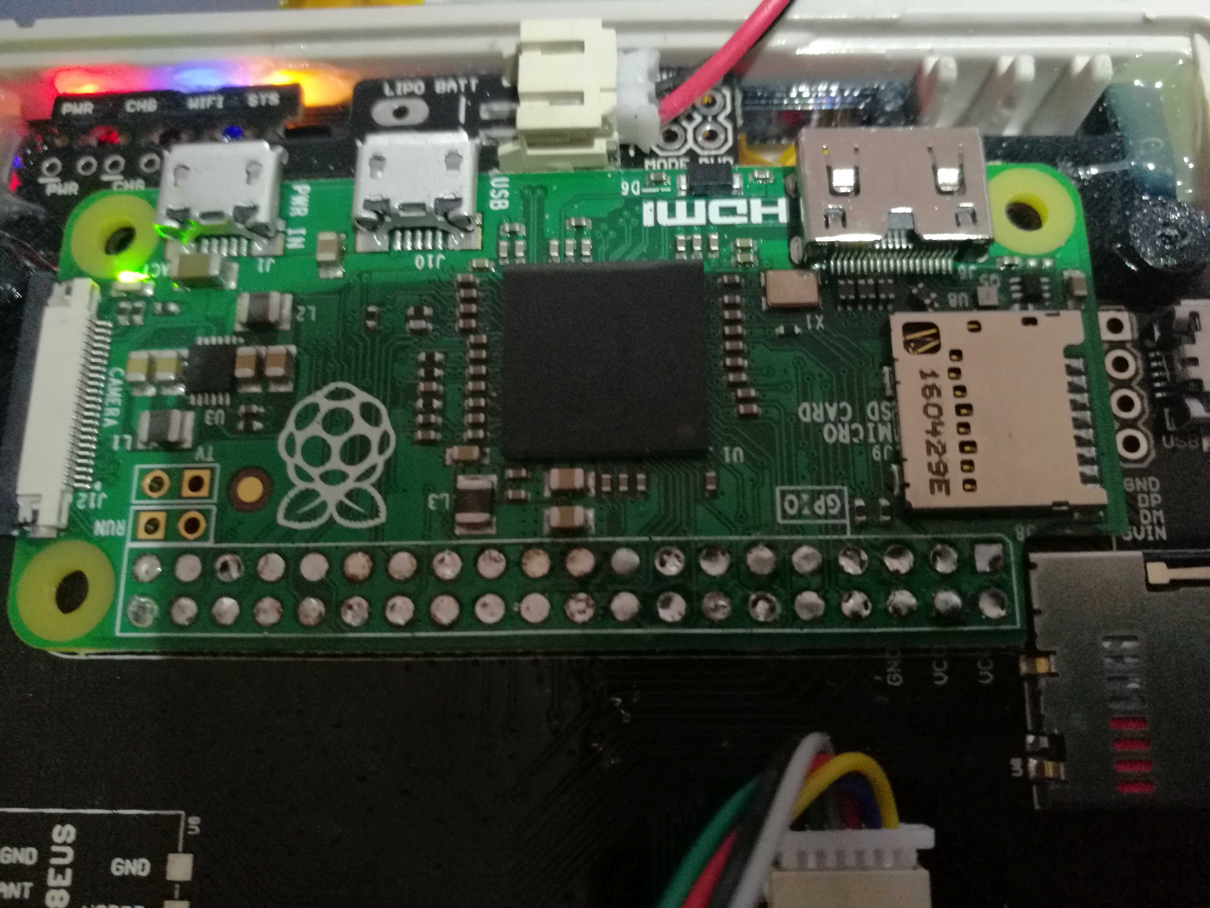

Pi solder.jpg (637.26 KiB) Viewed 8980 times

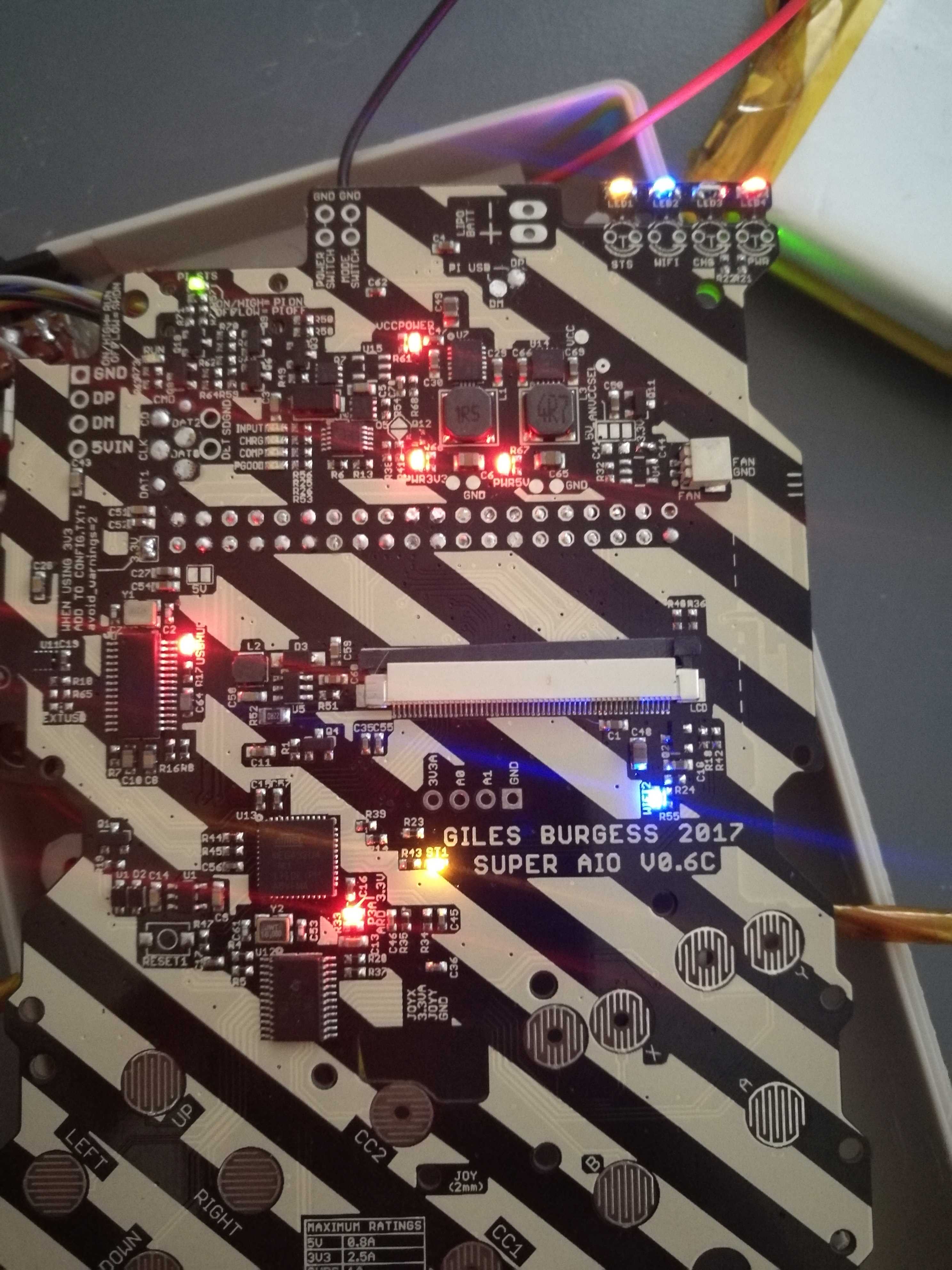

Power switch in position off
3.3V and 5V led is on/red ... is this correct?
Pswitch off.jpg (645.64 KiB) Viewed 8980 times
Power switch in position on
Pswitch on.jpg (664.76 KiB) Viewed 8980 times

Hi,
Thank you for being very accurate with your description! From what I can tell, your soldering and power switch is correct (by the BLUE LED going on/off) and the input is working (wifi on/off) however it is like the "mode button is permanently held down". The fact that it boots up by itself is a concern, and I am 99% sure that I will need to take a look at it myself :/ Is it ok for you to PM me and we can work on returning it to me to repair and I will send out? I suspect it is something to do with the safe shutdown circuit messing up, which means I have to replace a few components!
I assume it powered on even it you UNPLUG the back board (those 6pin connectors)?
