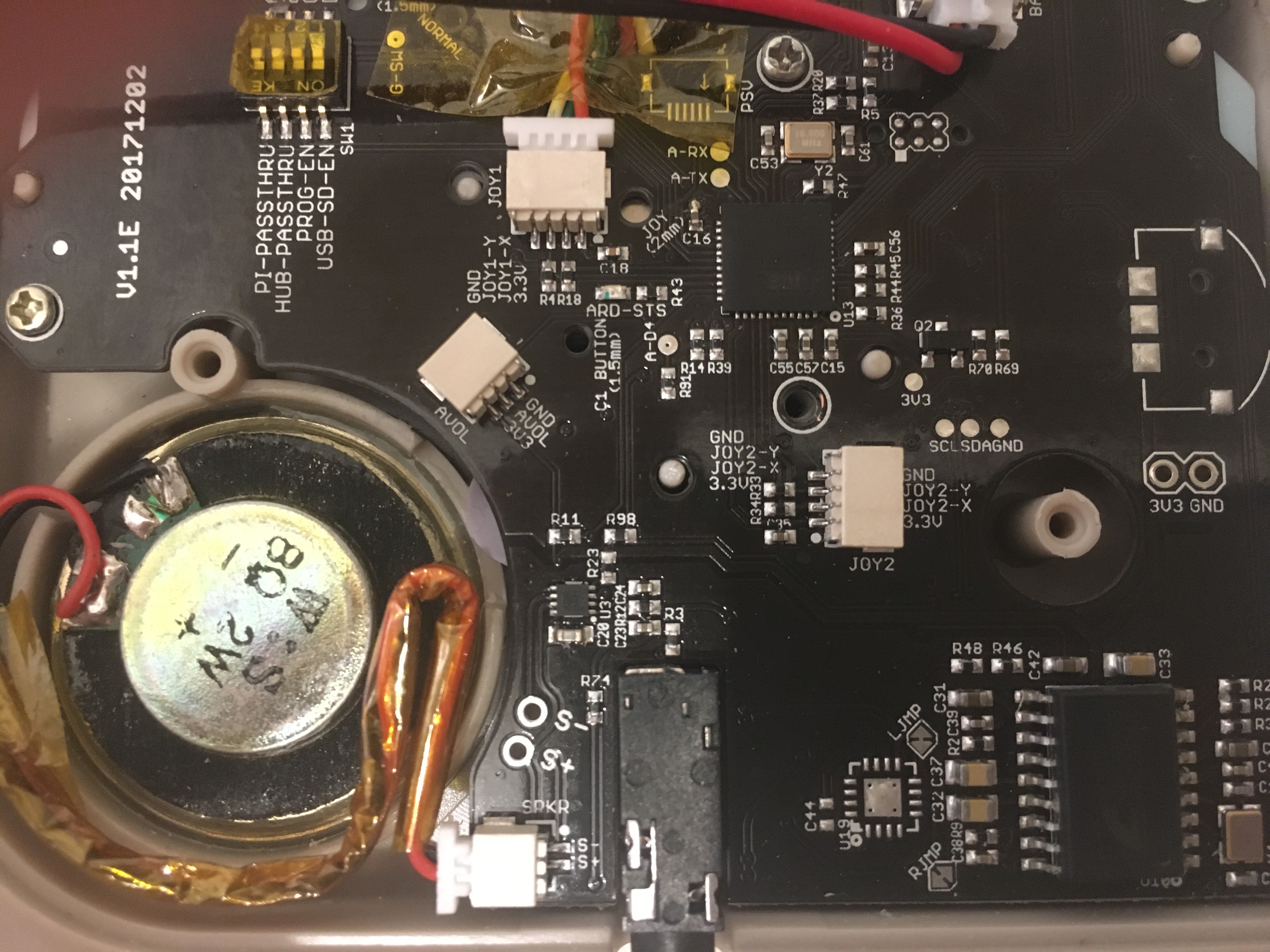

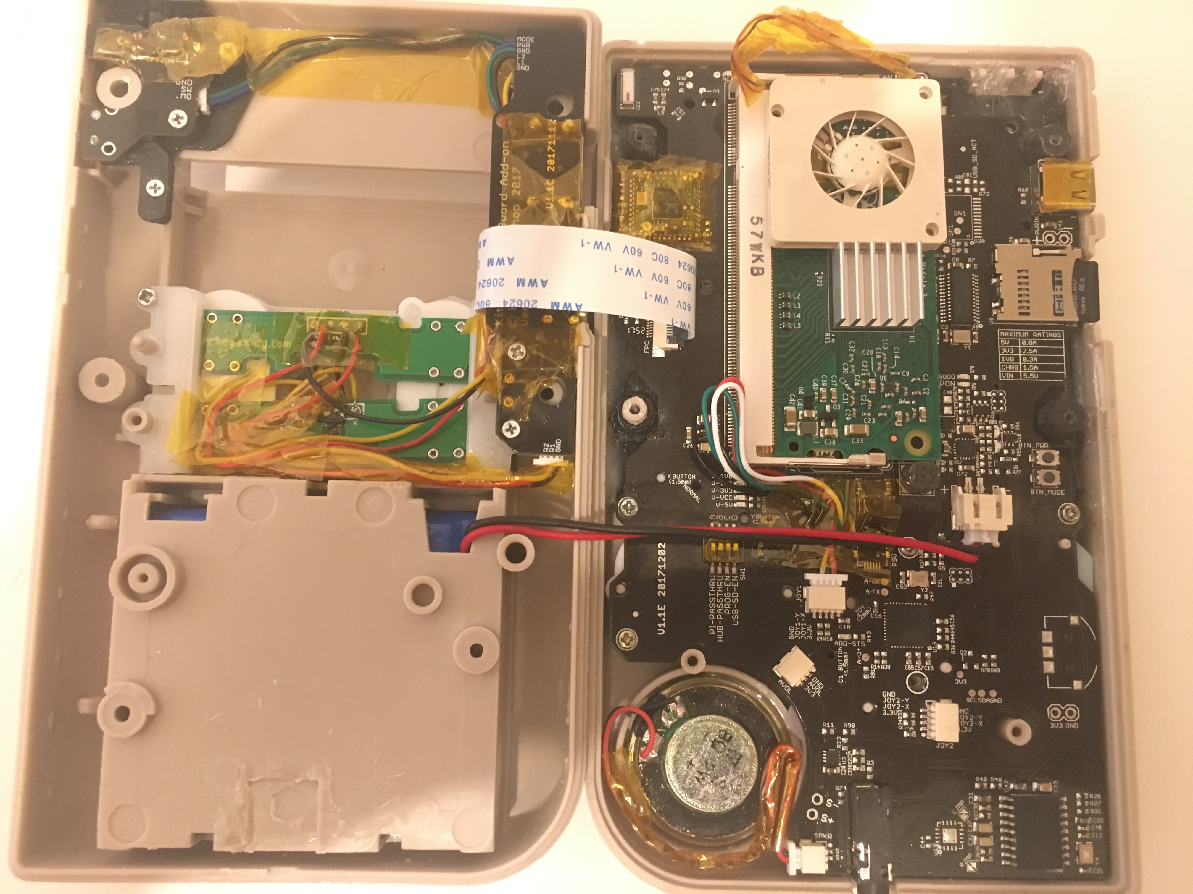

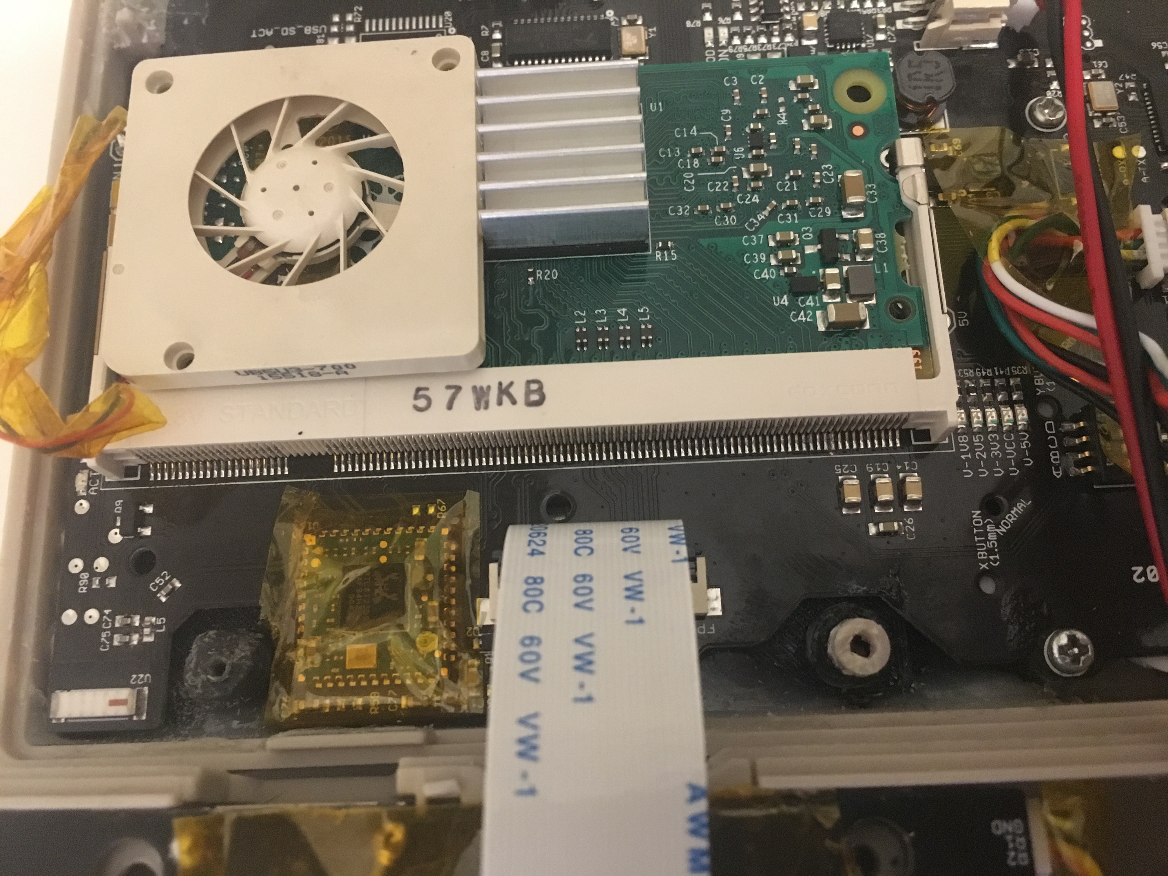

Hi, could you post some pics of your setup and of it 'running'? Ideally a video with it open showing the issue if possible

Hi Kite
See attached some pics and a video with the issue.
Thanks!
Thanks!
- GBZ_WHITE_SCREEN_1.mp4
- (9.23 MiB) Downloaded 295 times
- image4.jpeg (2.15 MiB) Viewed 4563 times
- image3.jpeg (1.8 MiB) Viewed 4563 times
- image2.jpeg (2.17 MiB) Viewed 4563 times

Ok so from the looks of it (was a little hard to tell) not all of your voltage rail LEDs were lighting up, this most likely indicates a short on 3.3v (also the fan not spinning could relate here too!)
I suspect the joystick, could you unplug that? Keep unplugging things that you have added until all 5 of those red LEDs light up. You may want to unscrew the main board as the back of the joystick could well be pushing in to the board.

Sorry I didn't answered you before: you were right, the Joystick was pushing the whole thing and causing the issue.
