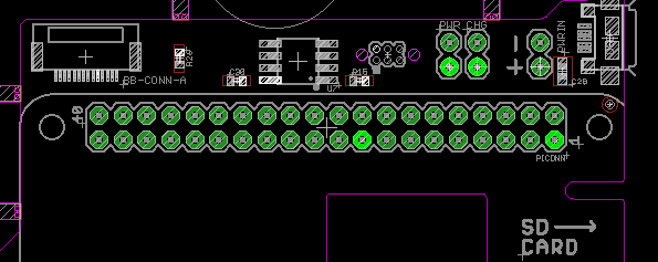

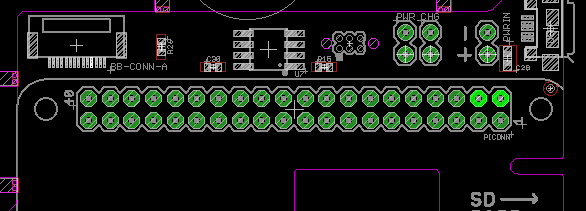

Hi :) yeah soldering isn't the best i'll be honest! So likely it sounds like VCC or 3.3V is shorted somewhere.. if you have your multimeter in continuity mode and measure the following pins to GND, and it is a dead short, well that's where to follow and look for problems :P
5V (or, battery voltage):
Screenshot from 2018-10-22 13-59-15.png (12.33 KiB) Viewed 7888 times
3.3V:
Screenshot from 2018-10-22 13-58-50.png (13.32 KiB) Viewed 7888 times
I can look to repair but removing stuff is way harder than putting it on, regardless you won't have to wait 5 months because i have spares for existing customers! I can do you a discount on a replacement board if you send me an email we can work it out. It might be better in future to snip the long pins first before soldering, I'm going to edit the guide to suggest this instead!
