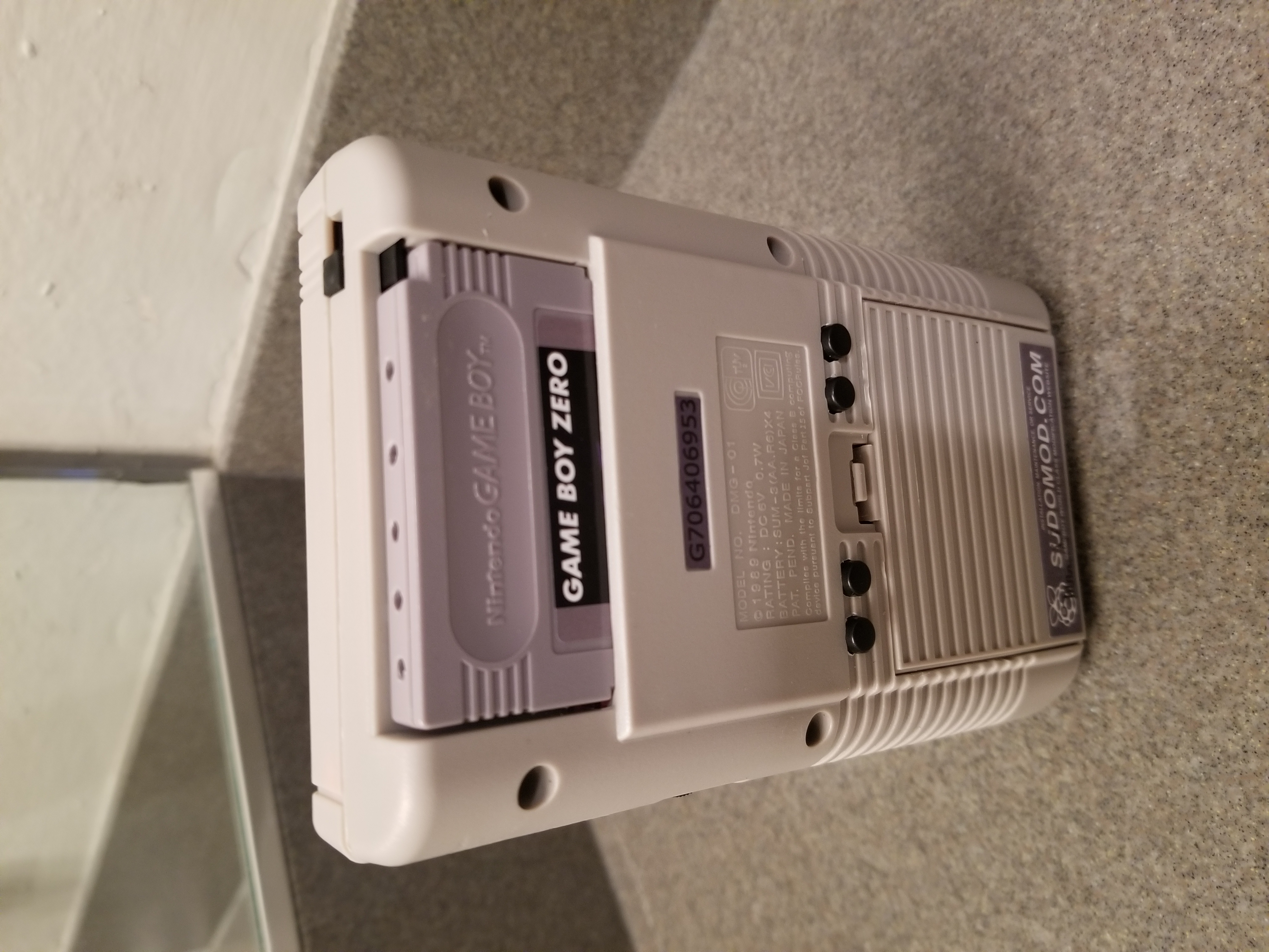

Thanks again in advance! Also, here’s a couple of pictures of how my Circuit Sword came out :)

So my temperature does spike up to 60 degrees at times but I've never seen it go past 65 degrees.... at least not yet that is. Also, my fan isn't directly placed on the module. I opted to have it attached to the cartridge area which vents out the top, like many other builds I've seen here on the forum (pictures from my first post can be seen for reference). So I'm assuming that's why it maybe goes a bit above 55 at times.
