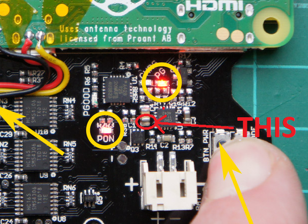

I got the lights all setup and they appear to be working. I have noticed that the 'charge' light only turns on when the unit is powered on. Is that the way it is? I would love the charge light to be on even when the unit is powered off but it is not a big deal.

Post by kite » Sun Oct 06, 2019 5:04 am
Ah i see, i hadn't actually tested that out but i see what needs to be done! Move the "+" wire from the charge LED onto the RED CIRCLED side of the capacitor here with the label "THIS":
It has to be this cap, and it has to be the side circled in RED :)
