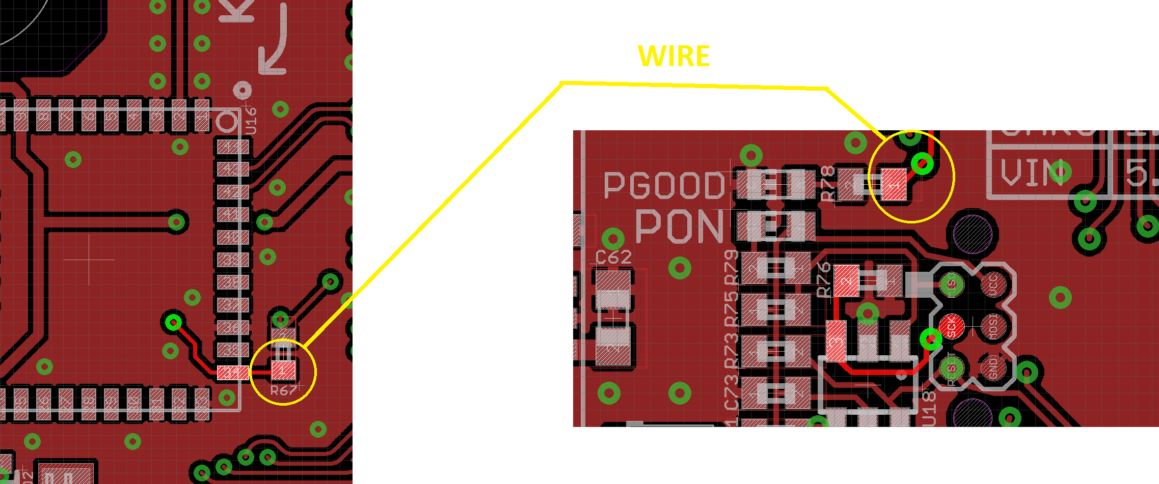

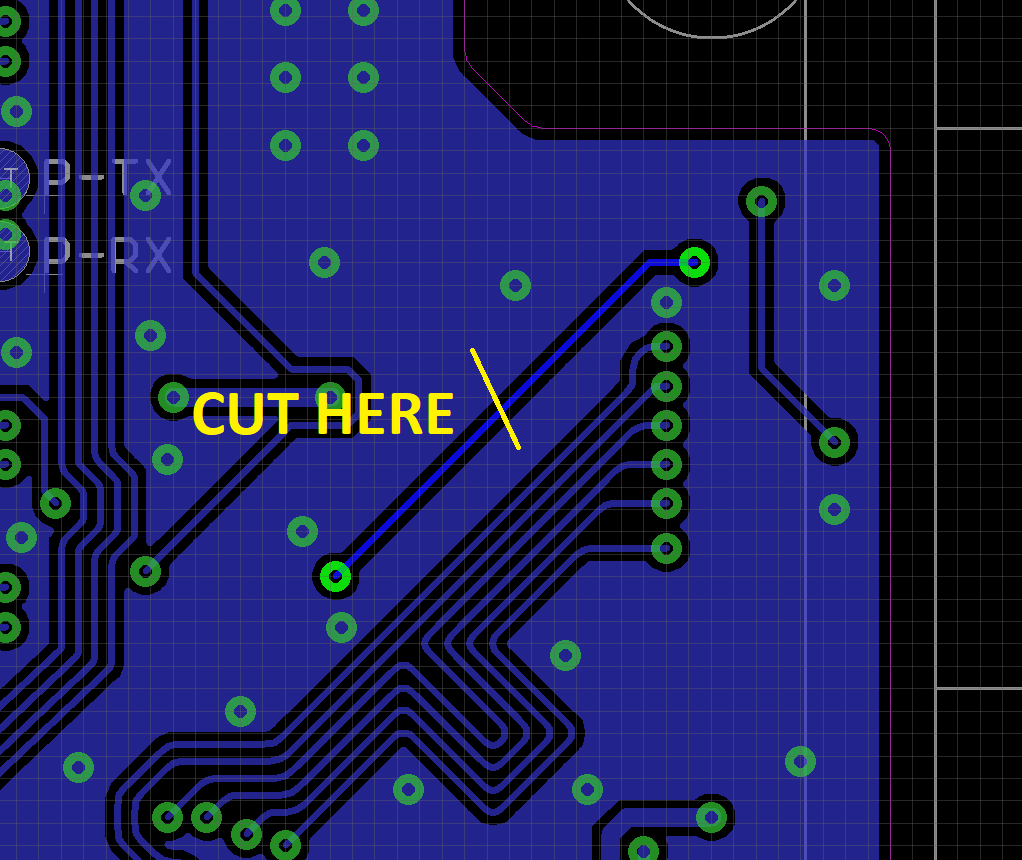

I have a hardware fix for the reboot thing, it's not particularly easy.. if anyone actually wants to do it i can post how (involves cutting traces and soldering to 0402 resistor pads with magnet wire!)

Directly underneath the wifi module, there is a trace that follows a bunch of others, but it's on its own.. this needs cutting where the yellow line is!
Then, solder a wire from the highlighted pin/resistor (resistor is not populated) next to the wifi module to the opposite end of the board, to any one of the highlighted pins :) (i have circled the one that looks easiest to add to)
Report back how it goes if you are brave enough!

You specifically said magnet wire... any reason why it can't be regular old hook up wire like one used on a bread board?
kite
Posts: 972
Has thanked: 246 times
Been thanked: 361 times
Re: Circuit Sword Bluetooth
Post by kite » Sun Oct 28, 2018 5:23 am
Any thin flexible wire will work, magnet wire is usually recommended because it is so light it doesn’t put any strain on the pads. These pads to solder to weren’t designed to have strain on them, and so a tug or even bending the wire could rip the pad off the board. A thin silicone cable will work, or after you have made the join to hot glue the wire somewhere nearby (I wouldn’t recommend putting glue where you solder incase you need to adjust it).

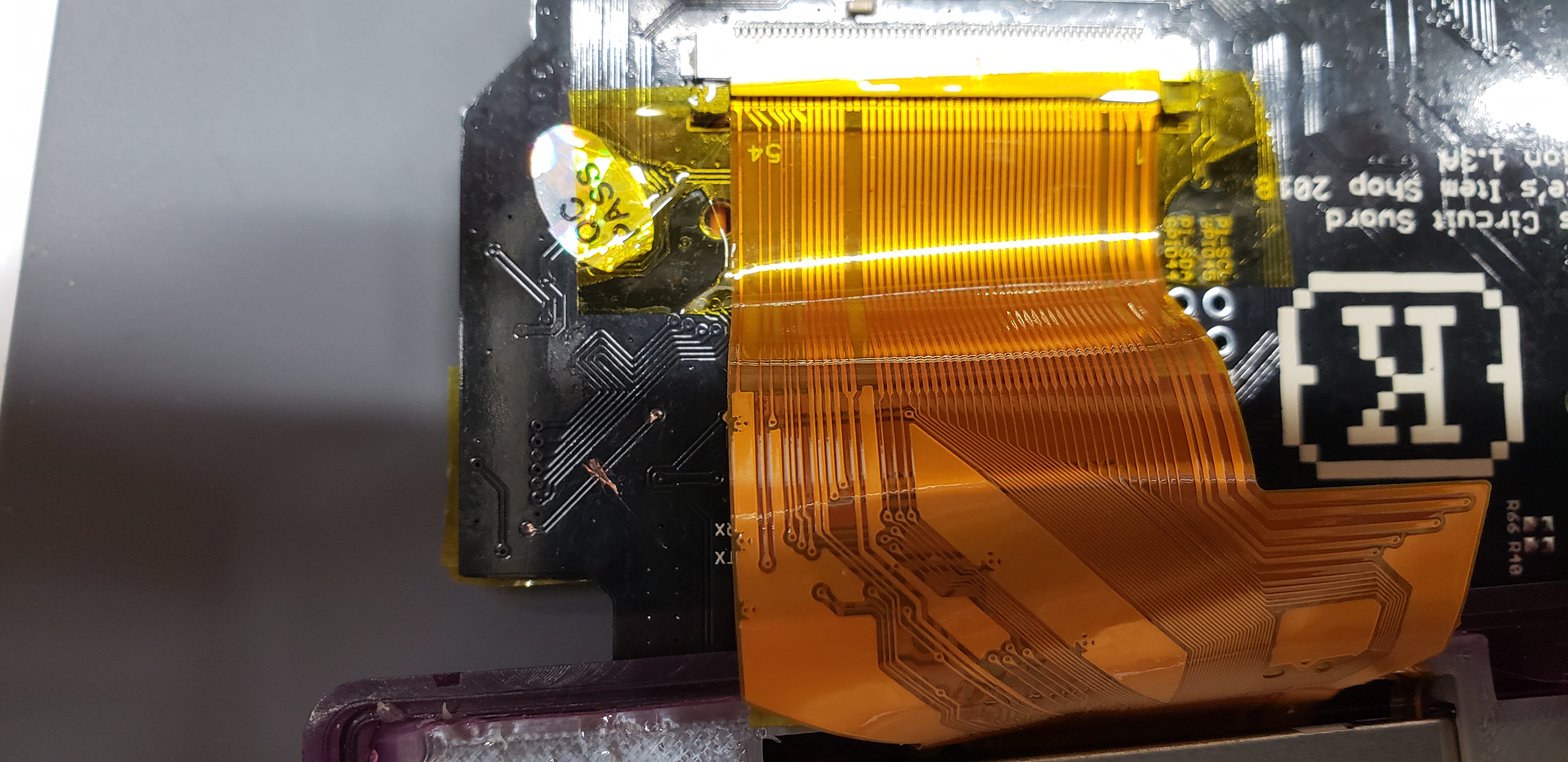

Made the mods. I've got to figure out the software next. Guess I forgot to take a picture of the front of the boards but I routed the wire below the cm3 and held it down with some kapton tape.
