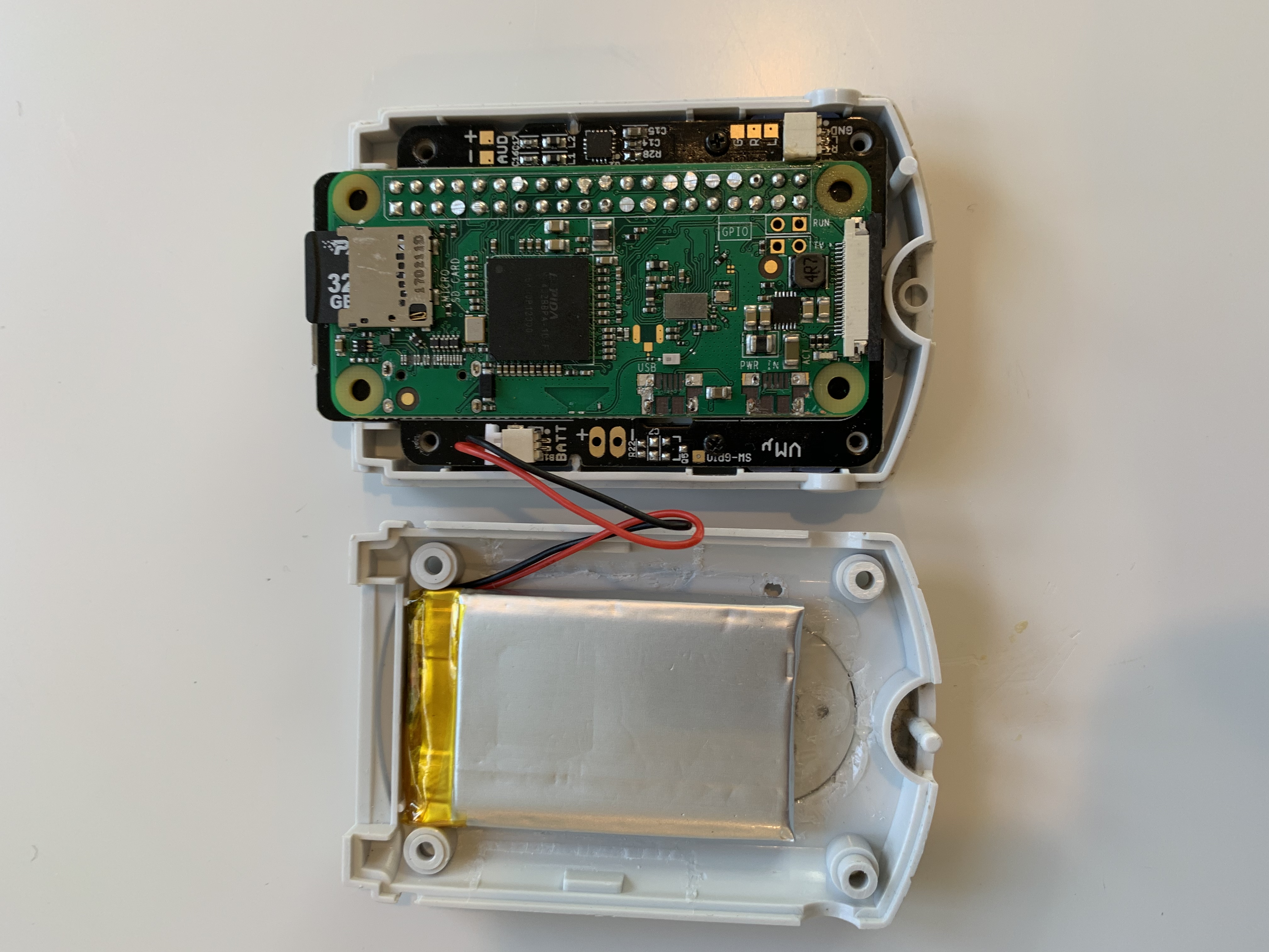

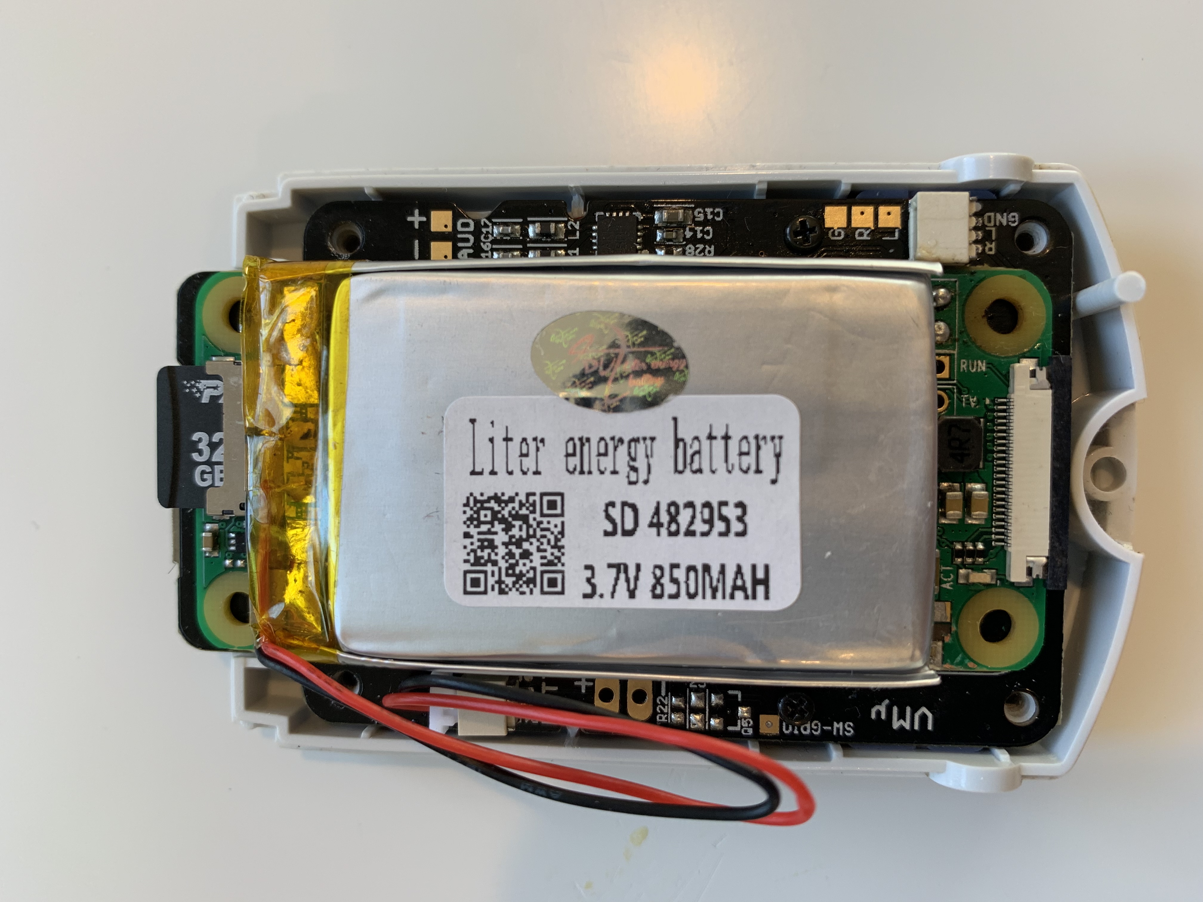

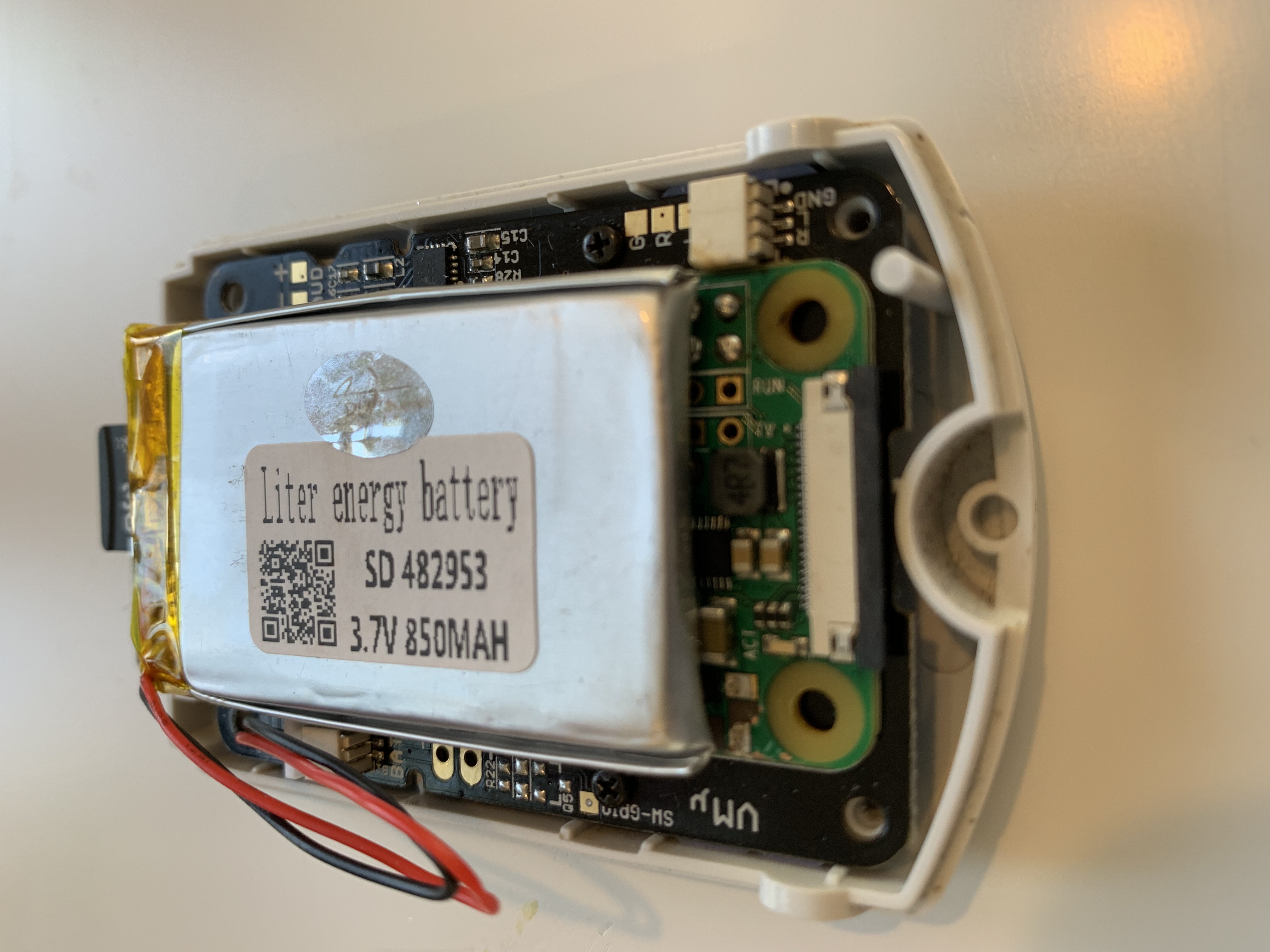

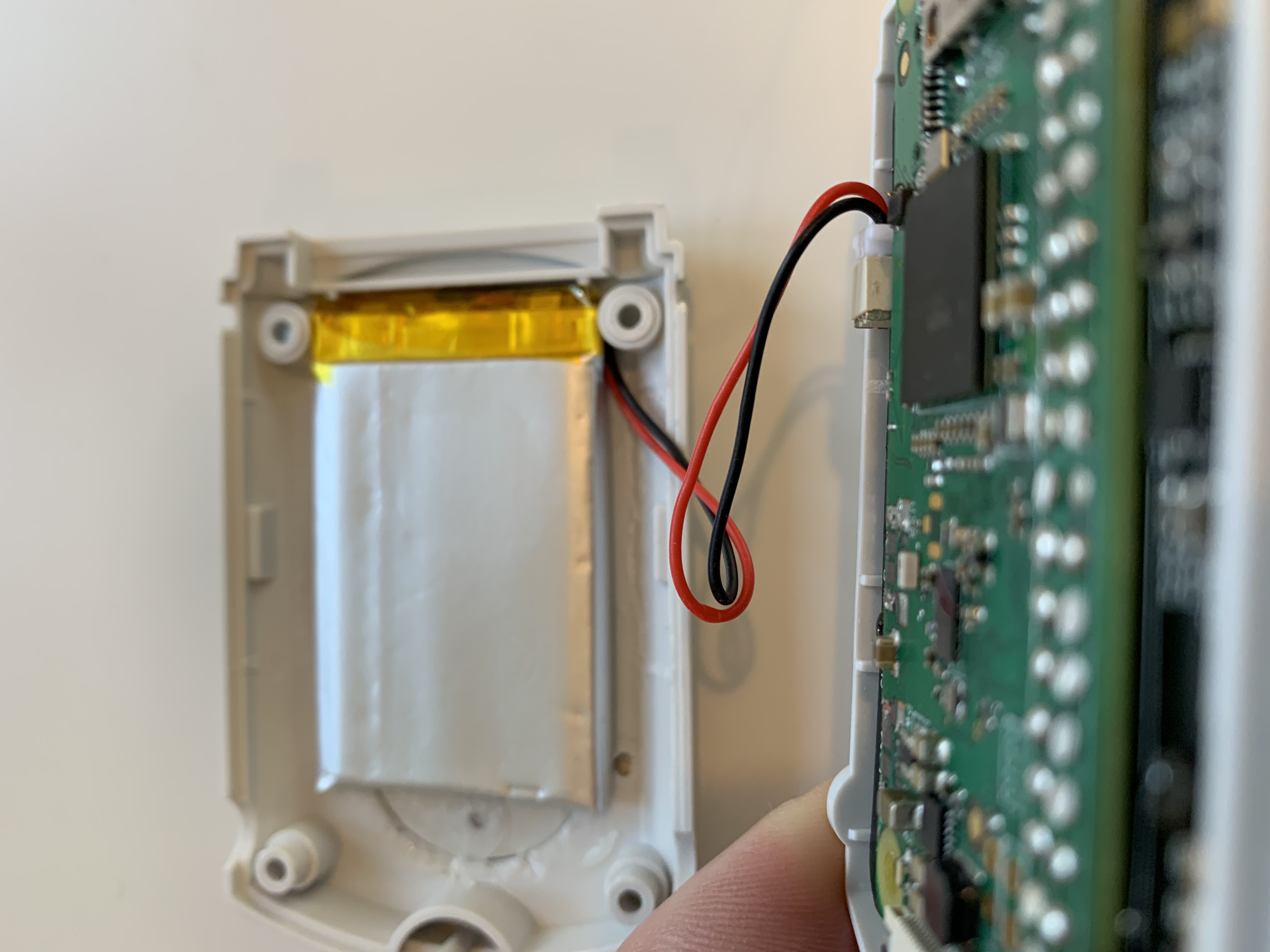

Post by diko_d » Sun Mar 17, 2019 1:42 pm
Here you go, a few pics as a reference.
An image of the device open. note the orientation of the battery. Especially the fact that the top of the battery is facing the top if the case, since the top back case is slightly curved and the top of the battery with the charge protection is thinner.
An image of the pi zero w board from the side. You can see at the left side the bulky power regulator and below it the bulky Capacitor.
An image of the battery on top of the pi zero w as it sits inside the case when closed. You will notice that it sits just above the large capacitor and well above the Power regulator and CSI connector.
A clear image of the battery.
The inside of the back case. Everything scraped off. Since the CR2032 battery cover is slightly thinner than the rest of the case I put a light amount of hot glue the carefully smeared it all over to hold the cover in place but not add thickness to the case.
The outside of the back cover. The screw there is the original screw just completely clipped and glued in place with super glue.

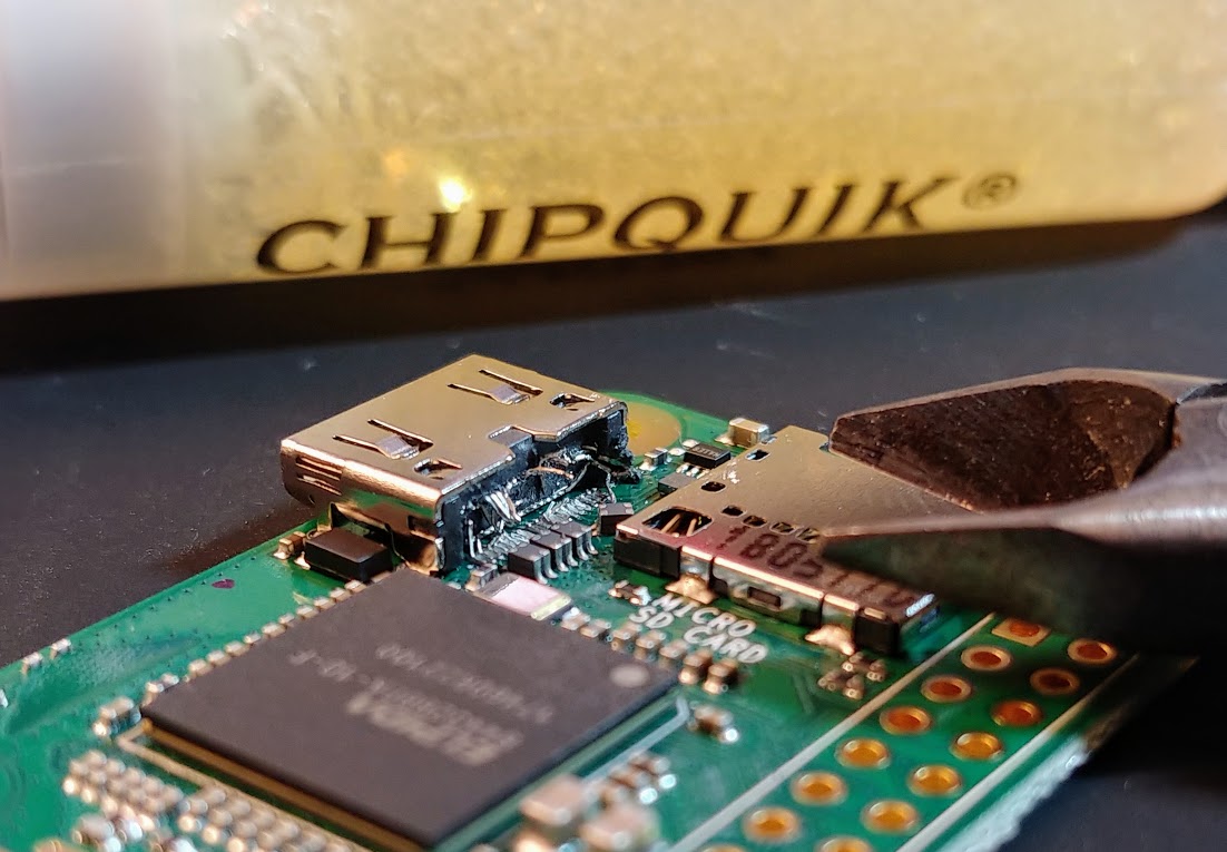

The HDMI connector has some fine pitch SMT components near it which I was worried about buggering them up by unsoldering them:
Since the HDMI connector is a sacrificial part on this board and wouldn't be reused, I opted for destruction of the connector pins to ease the removal. This way I only had to unsolder the HDMI connector shield from the ground plane of the Pi board.
Held the Pi in a panavise, lots of solder and flux on the HDMI shield, and a pair of needle nose pliers to _very_ gently pull up the connector once it was hot enough. Cleaned up the cut pins with some solder wick (copper braid). The USB connectors were much easier in comparison, but again, plenty of solder and flux made it easier to get them off. IIRC, my soldering iron was set to 800 degrees F.
