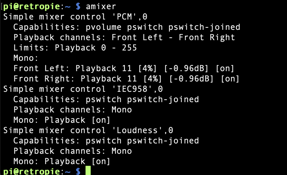

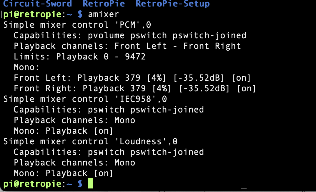

I had the exact same problem that the volume is too loud on my Circuit Shields. While on Stretch everything was fine, on Buster the volume is at max. So, I flashed the 2 images (Stretch and Buster) and compared the outputs of amixer and dmesg:
Stretch:
Buster:

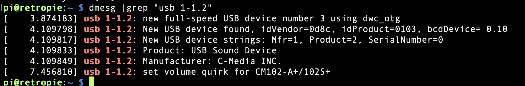

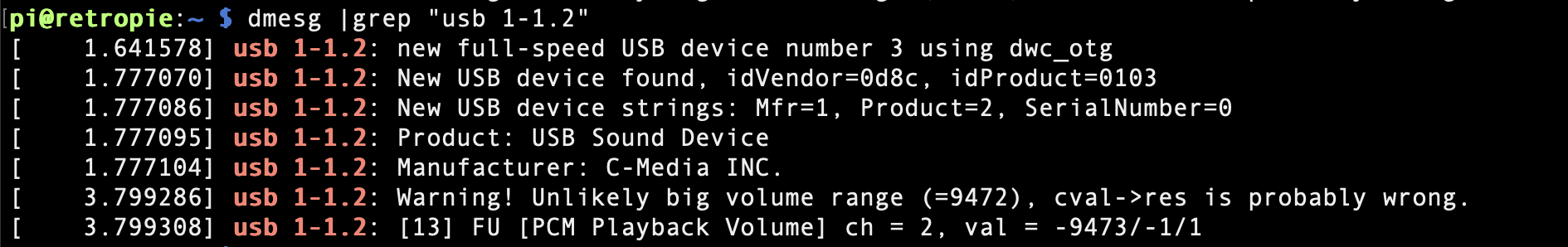

As you can see, there is a difference in the volume range (Stretch: 0-9472 vs. Buster: 0-255) so that on Buster the volume can be decreased only by 1dB. On Buster now there is also some obscure message saying "set volume quirk for CM102-A+/1025+". Searching for it quickly reveals the cause of the volume difference here:
https://github.com/torvalds/linux/commi ... 4639c4caff
It seems someone wanted to fix a volume problem, but introduced another one which is now in the linux kernel driver for the CM102-A+/102S+ USB audio controller:
https://github.com/torvalds/linux/blob/ ... er.c#L1139
Long story short, I could fix the volume problem on Buster locally by reverting that change in the kernel and recompiling it directly on the Raspberry. I simply followed the guide here:
https://www.raspberrypi.com/documentati ... tml#kernel
I tried to create a DKMS module to replace the snd-usb-audio module of the kernel with my patched one, but am struggling here. Maybe someone with more DKMS experience can help? The reverse kernel patch is the following:
