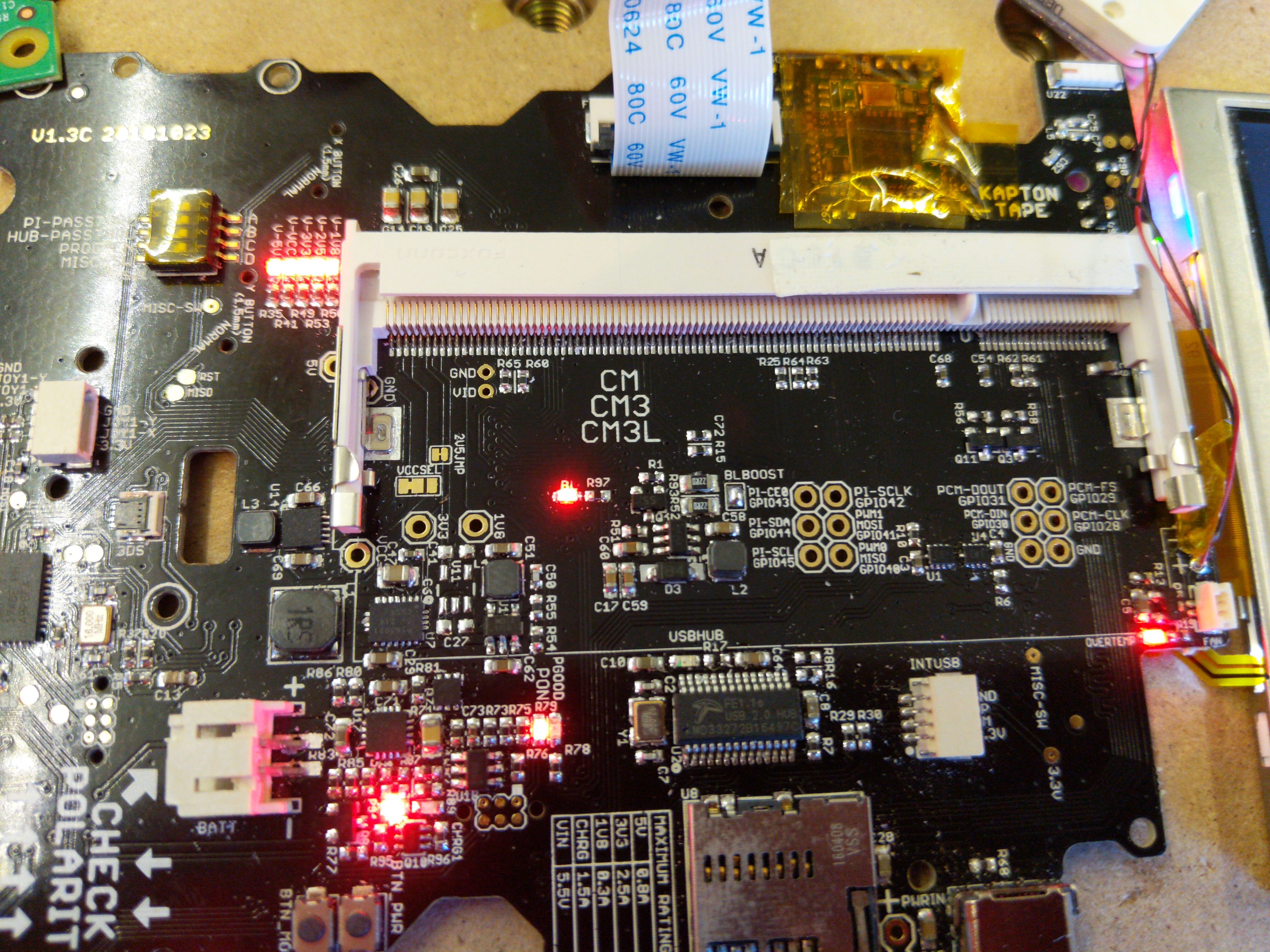

I got a Circuit Sword (1.3C) with the 320x240 screen in 2019, everything worked fine.
I got a new Circuit Sword (1.3D) with two _new_ 640x480 screens (the ones with no adapter) in 2020. The idea was to make a new build and upgrade the screen of the existing one.
I first tried to simply plug the new 640x480 screen to the old Circuit Sword and it didn't work. I kinda remembered that there was something to do for 640x480 but since nothing was needed for the new board I only searched it back after doing nothing failed. I found my way back to the Circuit Sword FAQ. Since I've a 1.3C board I followed the instructions: updated the software, flashed the arduino and bridged the BL BOOST pads with solder (not when the board was powered, obviously).
But now, both the 640x480 and the 320x240 screens don't work with the 1.3C board. Backlight do work on both, you can see the screen is powered on. But it stay black. The software side of things seems fine. Safe shutdown works when switching things off. SSH connection works too.
I've seen another topic about a non-working LCD on a CS and checked the BL led and the voltage on C17 and C59 as instructed there. The led is on when powering the board. So I assume it is good. With the display (320x240) C17 and C59 both read as 18.8v. Without the LCD they both read as 36.2v. I've no idea if this is the expected values or not. I also checked if any component nearby the BL led was hot, everything was cold to the touch.
The attached image shows the BL led one and the solder birdge on the pads.
The attached video shows powering the board and switching it off with the safe shutdown.
VID_20200919_165107.mp4
(2.71 MiB) Downloaded 519 times
edit: added note about the lack of any hot component nearby the BL led.

Post by pbuyle » Sat May 29, 2021 5:38 pm
/var/log/syslogShow

pbuyle
Posts: 8
Joined: Sat Sep 19, 2020 3:03 pm
Location: Montréal, QC
Re: [Circuit Sowrd 1.3C] LCD Not Working
Post by pbuyle » Mon Oct 25, 2021 7:46 am
I eventually got in touch with Kite who provided great support. After many tests, including a new board and several SD cards and not getting anything except backlight on 3 different screen, the only component left to try to replace is the CM3 board. Unfortunately, they are out of stock pretty everywhere I look :( .
pbuyle
Posts: 8
Post by pbuyle » Wed Nov 10, 2021 11:28 am
Kite sent me a new CM3 and things now the screen work.
I can't stress enough how great Kyle was at customer support. I don't think I've ever receive better service.
