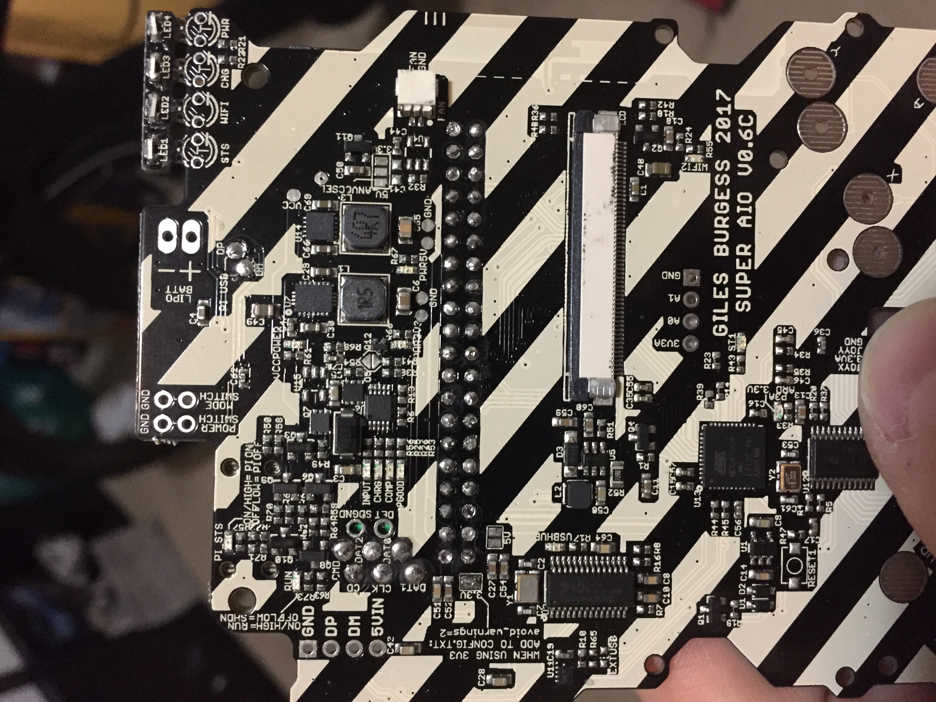

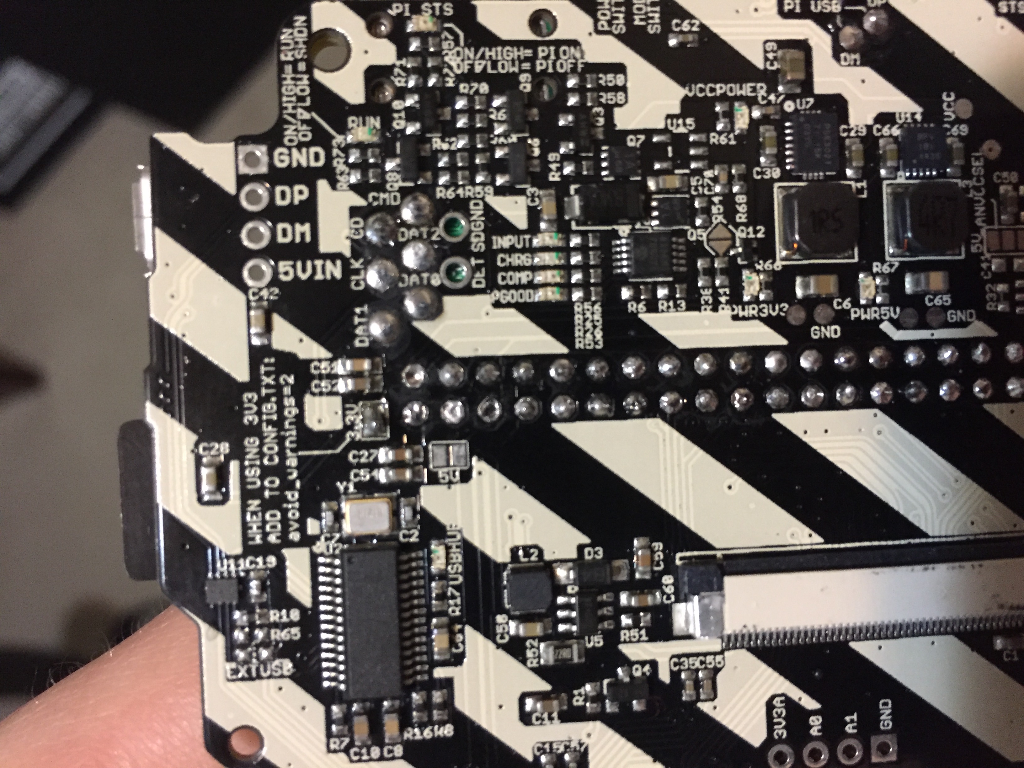

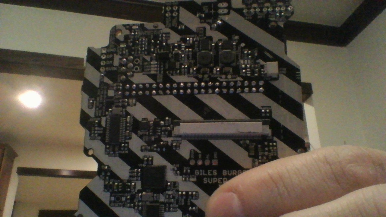

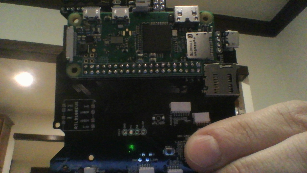

Here are some pics - I can't see any bridges so I am concerned they are between the Pi0 & SAIO.
Started from an old link and the youtube video and got to LCD before I found the new guide...

Do you have a clearer/better camera? Very hard to make out details
Have you soldered the 3.3v jumper?
Can you show a picture with the USB connected to the SAIO (the side port) With the switch OFF and also a picture with the switch ON. I'm interested in the side with all the LEDs.

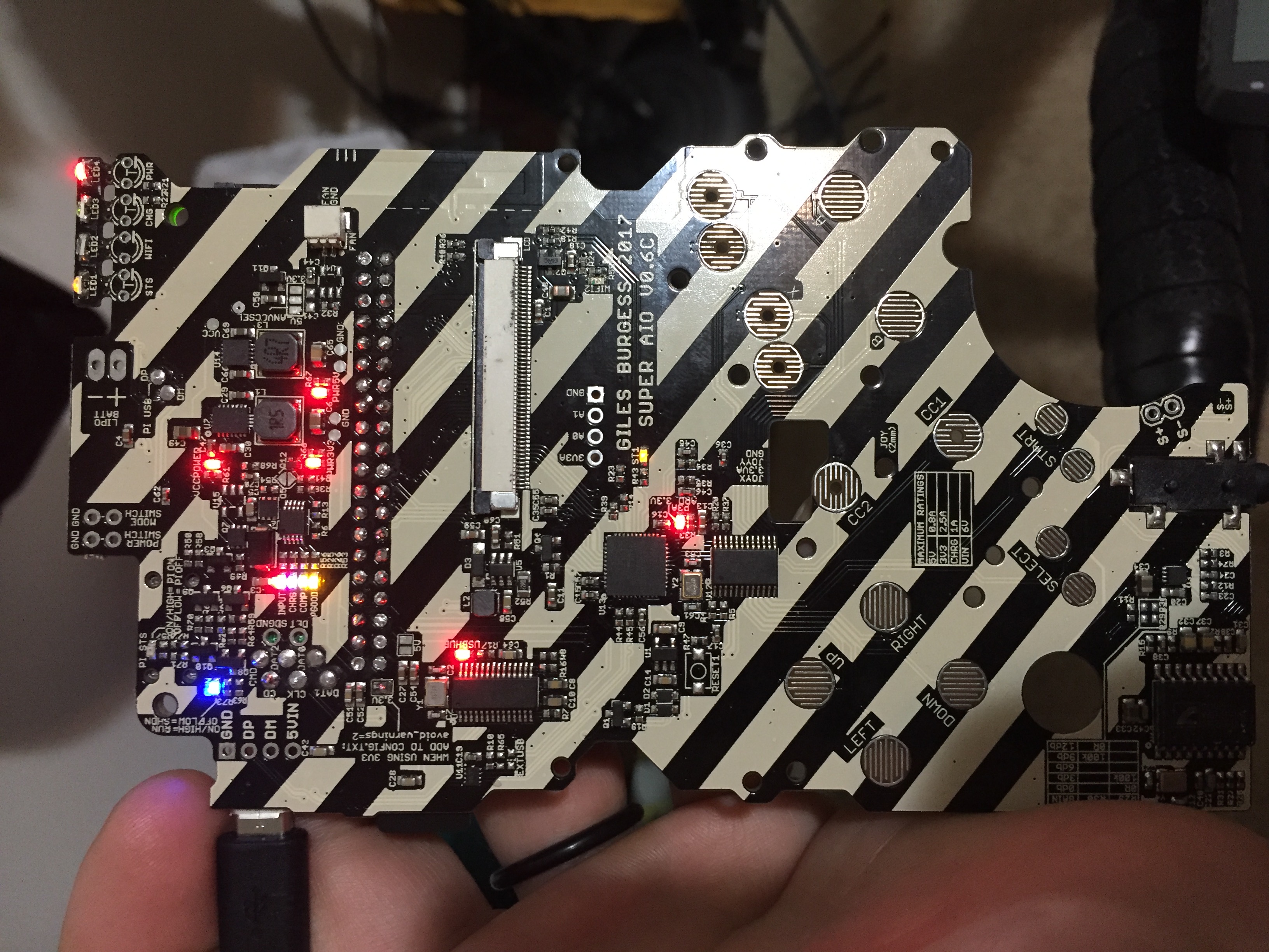

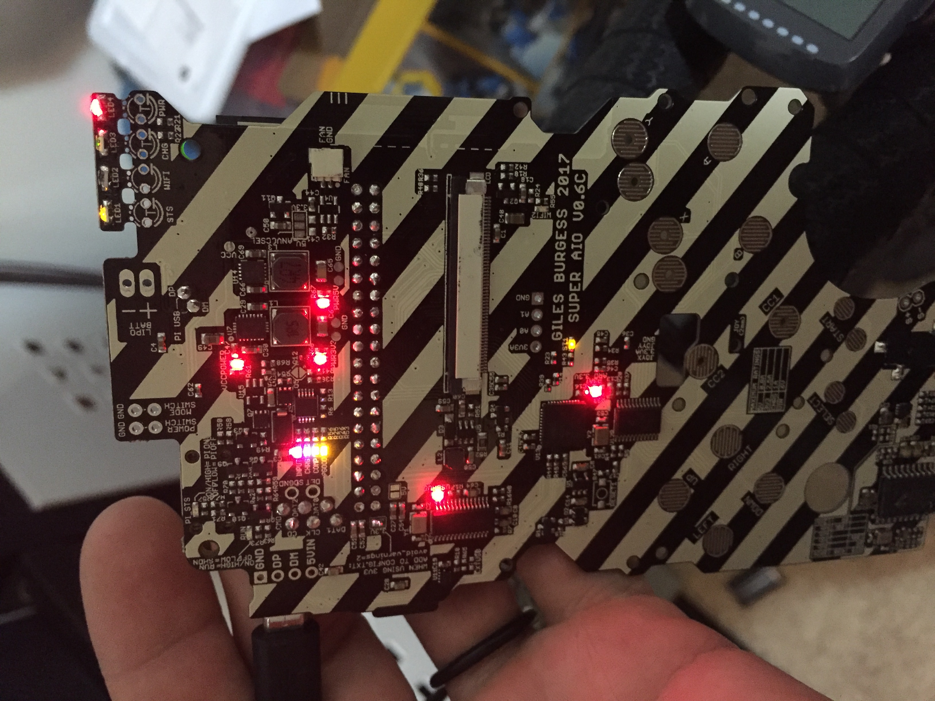

Better pics attached -
Yep - I've soldered the jumper - pic below:
When I flip the switch on I have one extra blue LED - all the others stay on in both positions and the board boots in both (green led on other side).
Thanks again.
Thanks again.
- Switch off
- IMG_5800.JPG (1.45 MiB) Viewed 7125 times
- 3.3V Solder
- IMG_5801.JPG (1.61 MiB) Viewed 7125 times
- Switch on
- IMG_5799.JPG (1.68 MiB) Viewed 7125 times
- Solder side two
- IMG_5798.JPG (1.84 MiB) Viewed 7125 times
- Solder side one
- IMG_5797.JPG (1.44 MiB) Viewed 7125 times

Hm, have you tried just plugging in the battery only?
Do you have a multimeter?
It appears like your pi doesn't actually boot? Have you got it to boot as you have connected it up? Near that BLUE led that comes on should be a green on when the Pi boots, also on the pi itself the green STS led will be flashing as it boots?
Have you updated the arduino firmware at all? (if you haven't, then don't, just leave as is for now)
