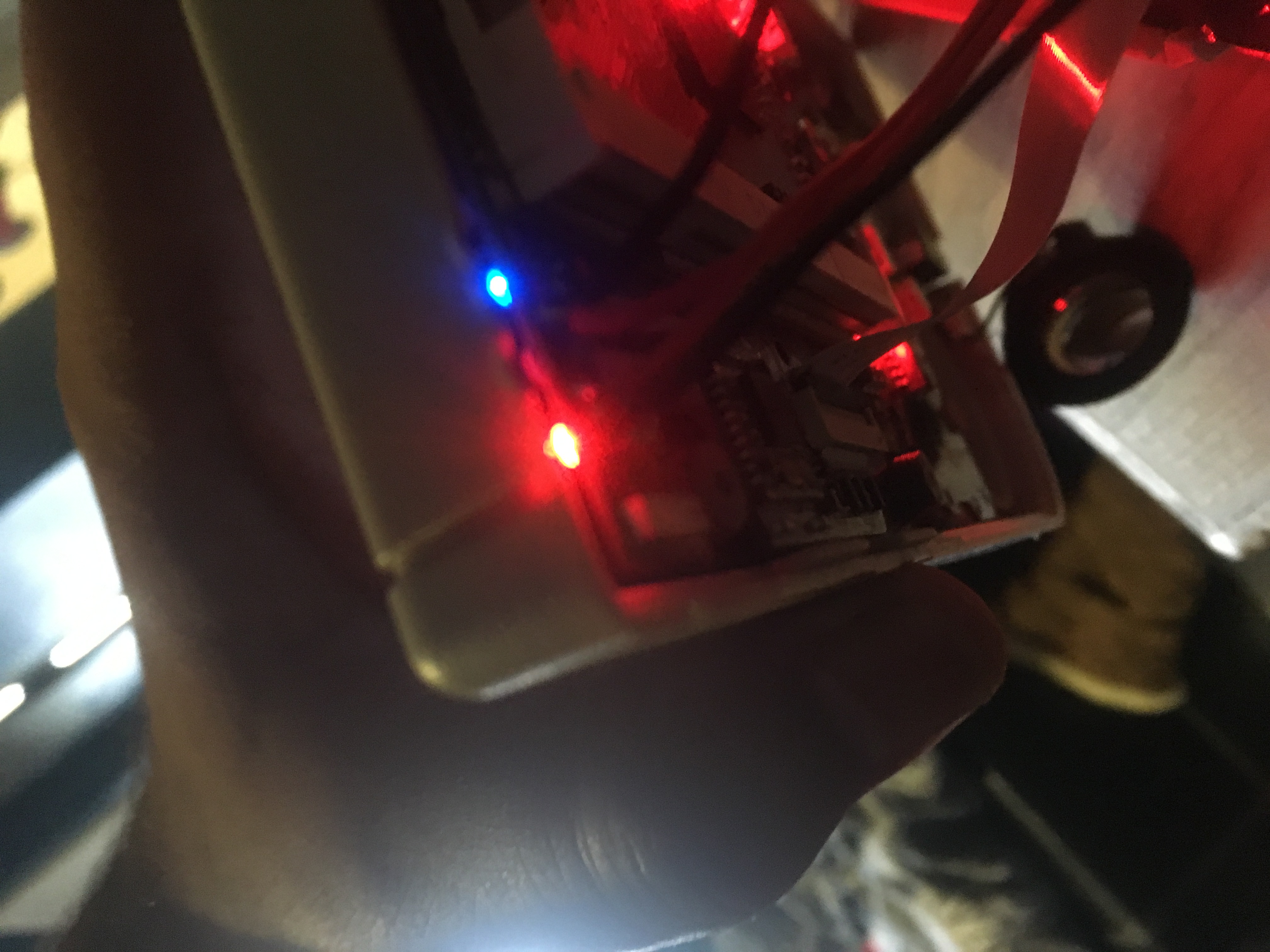

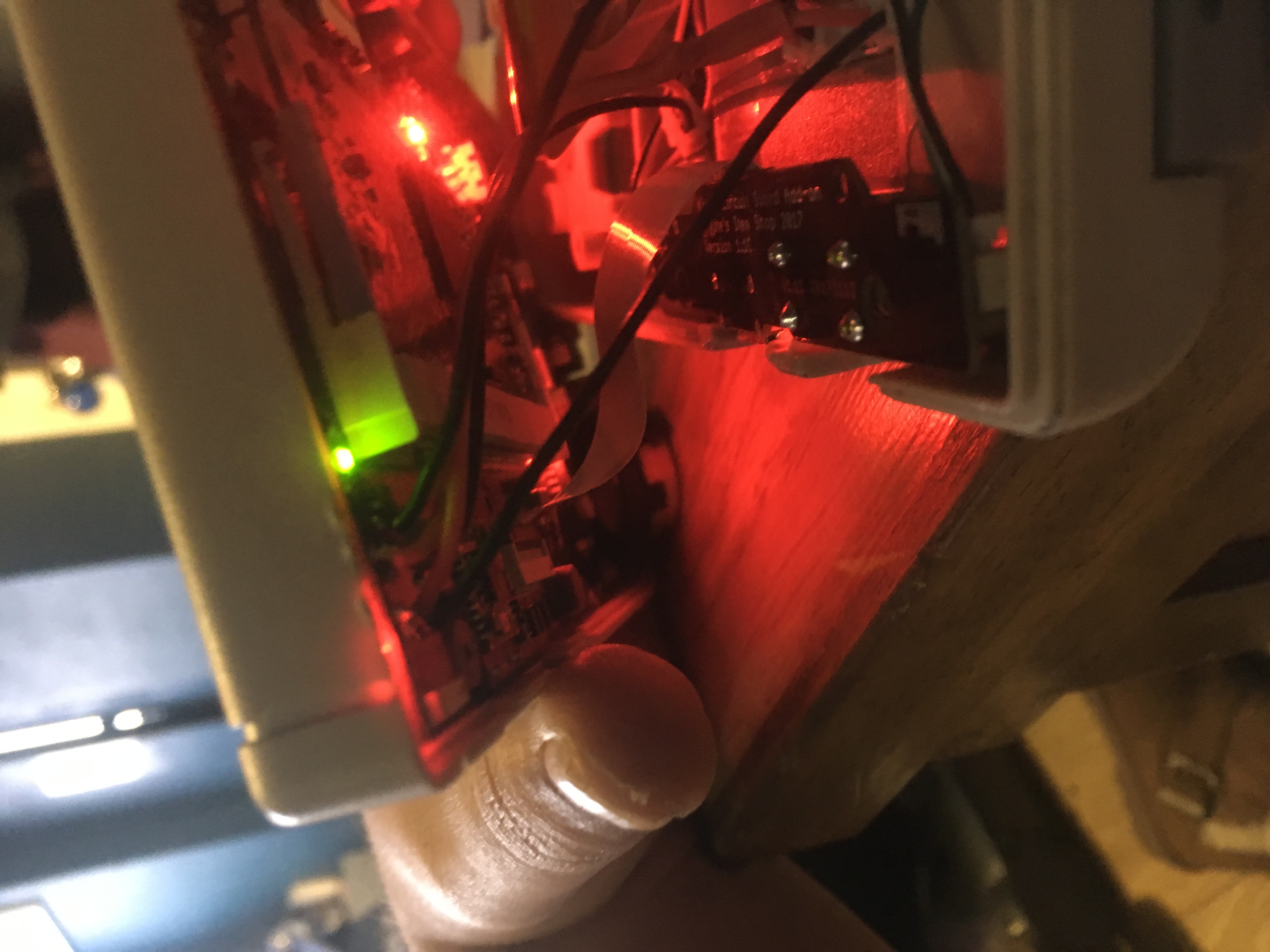

I have soldered some connectors to the LED pads on my circuit sword,the power LED's functions as expected.When powered on both LED's light up,my connected LED light and the one on the board.

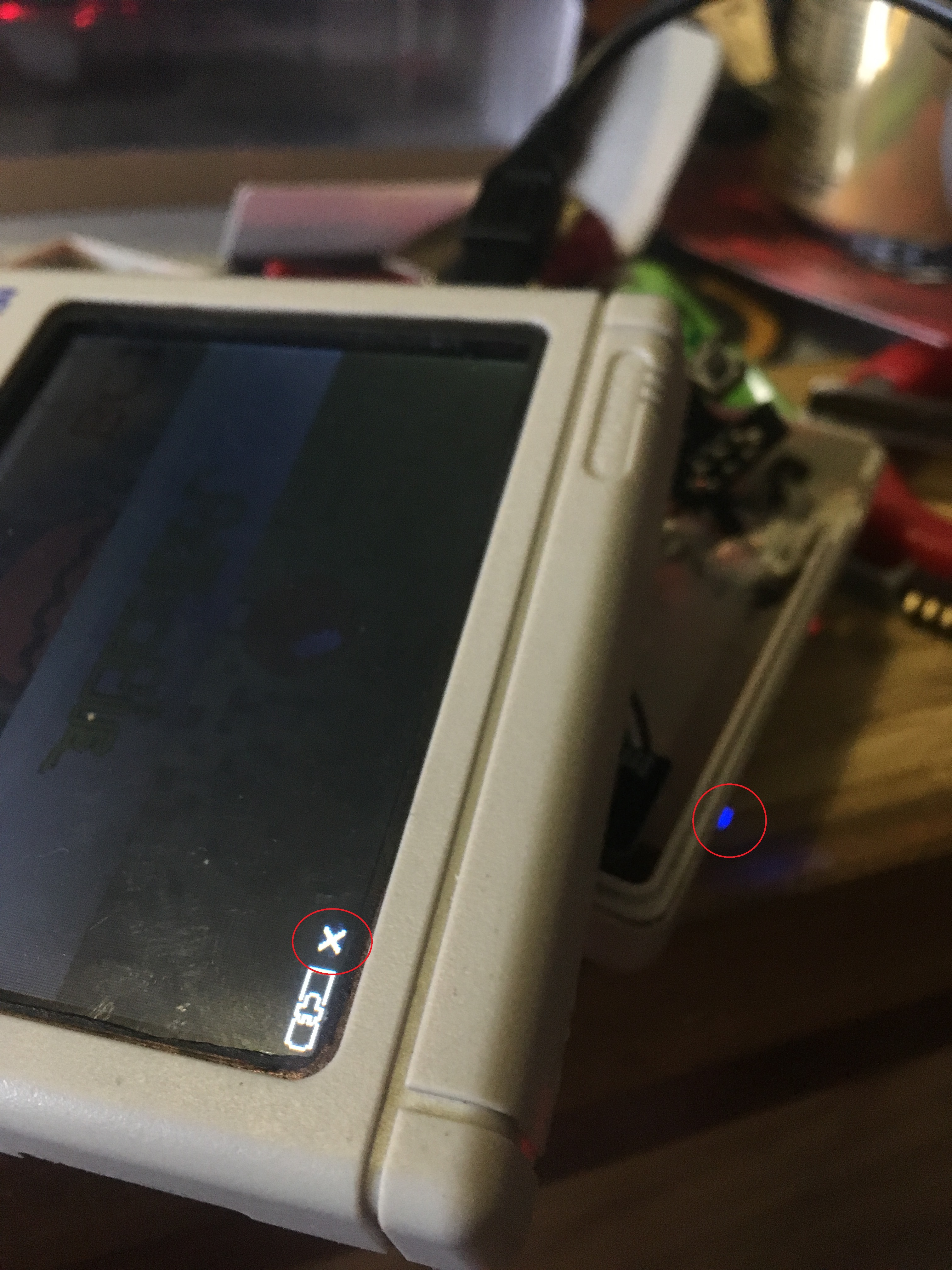

My WIFI LED's however are working in reverse, both on the board and my connected one. When I have WIFI off the LED's turns on and when I turn on WIFI the LED's turn off. Have I shorted something while soldering or have I mixed up something ? Any help would be appreciated.

Can you should a picture of your soldering for those LEDs? Do BOTH wifi leds come on in reverse? You most likely have soldered the new LED the wrong way round for wifi.. try flipping it

That's the strange thing I thought I had something wrong but the boards build in led is doing the same thing.
I have attached some pictures they aren't the best because i'm trying to get the WIFI icon on screen and the LED's at the same time.
WIFI ON
WIFI OFF
