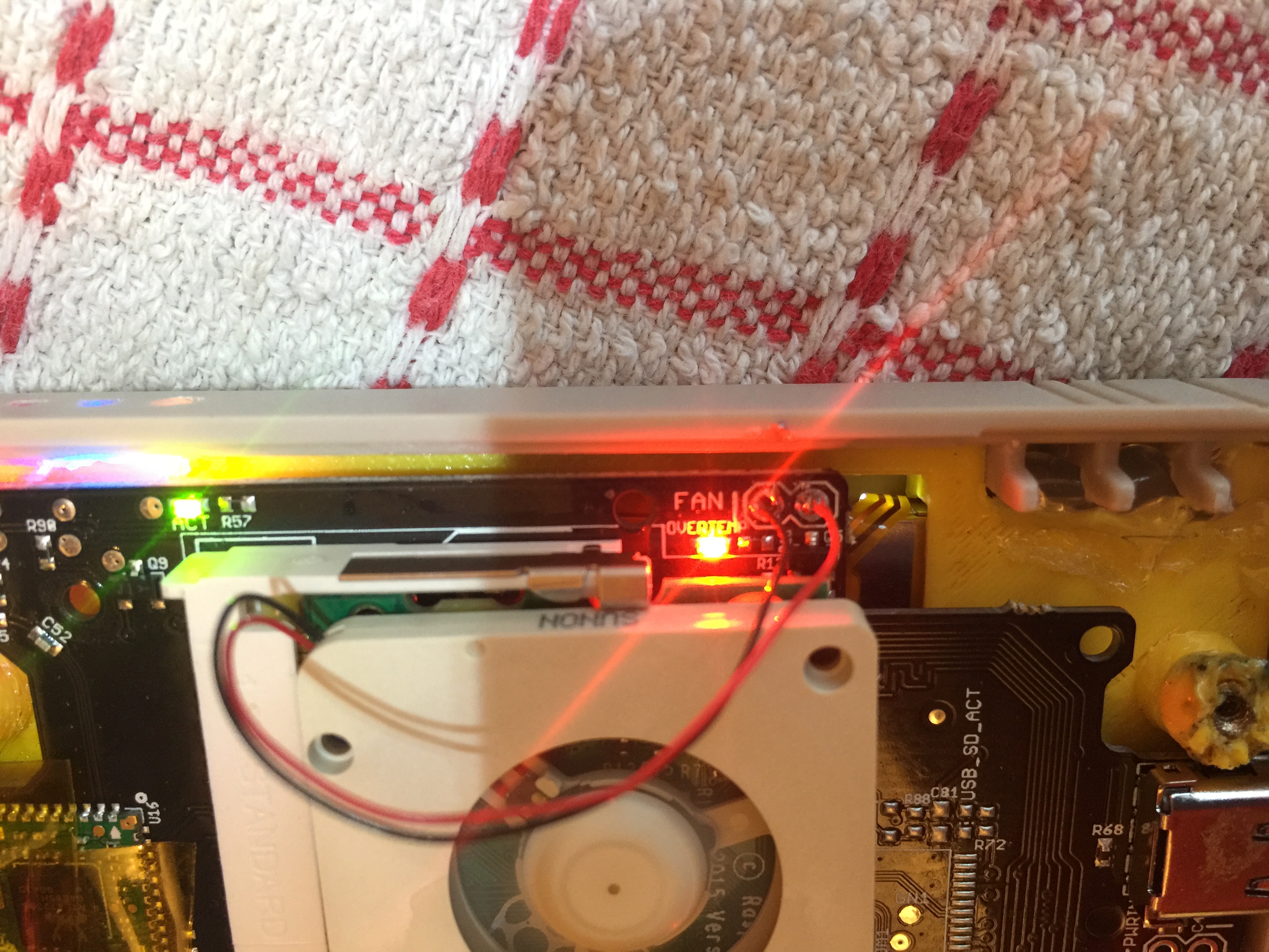

Does the little RED LED next to where you soldered also stay on?
DaveyD
Posts: 11
Joined: Fri Nov 03, 2017 12:56 pm
Re: Kites circuit Sword fan staying on
Post by DaveyD » Tue Feb 13, 2018 9:12 am
Yep that’s on

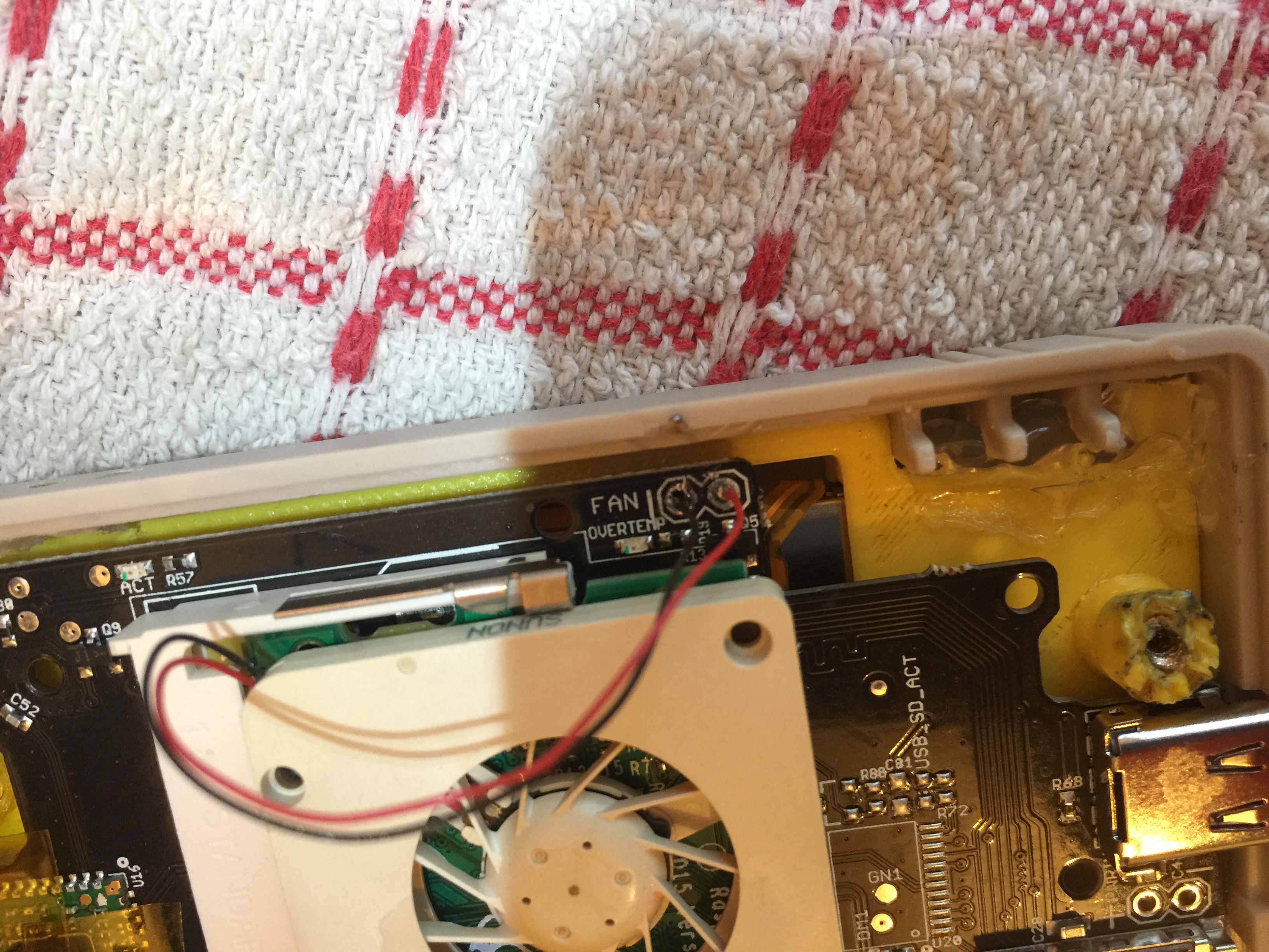

Ok let me take a look on some of my boards this evening and see if it's something silly that I have done.. could you please take a picture of that top corner of the board? Also can you remove the Compute Module and re-insert it?

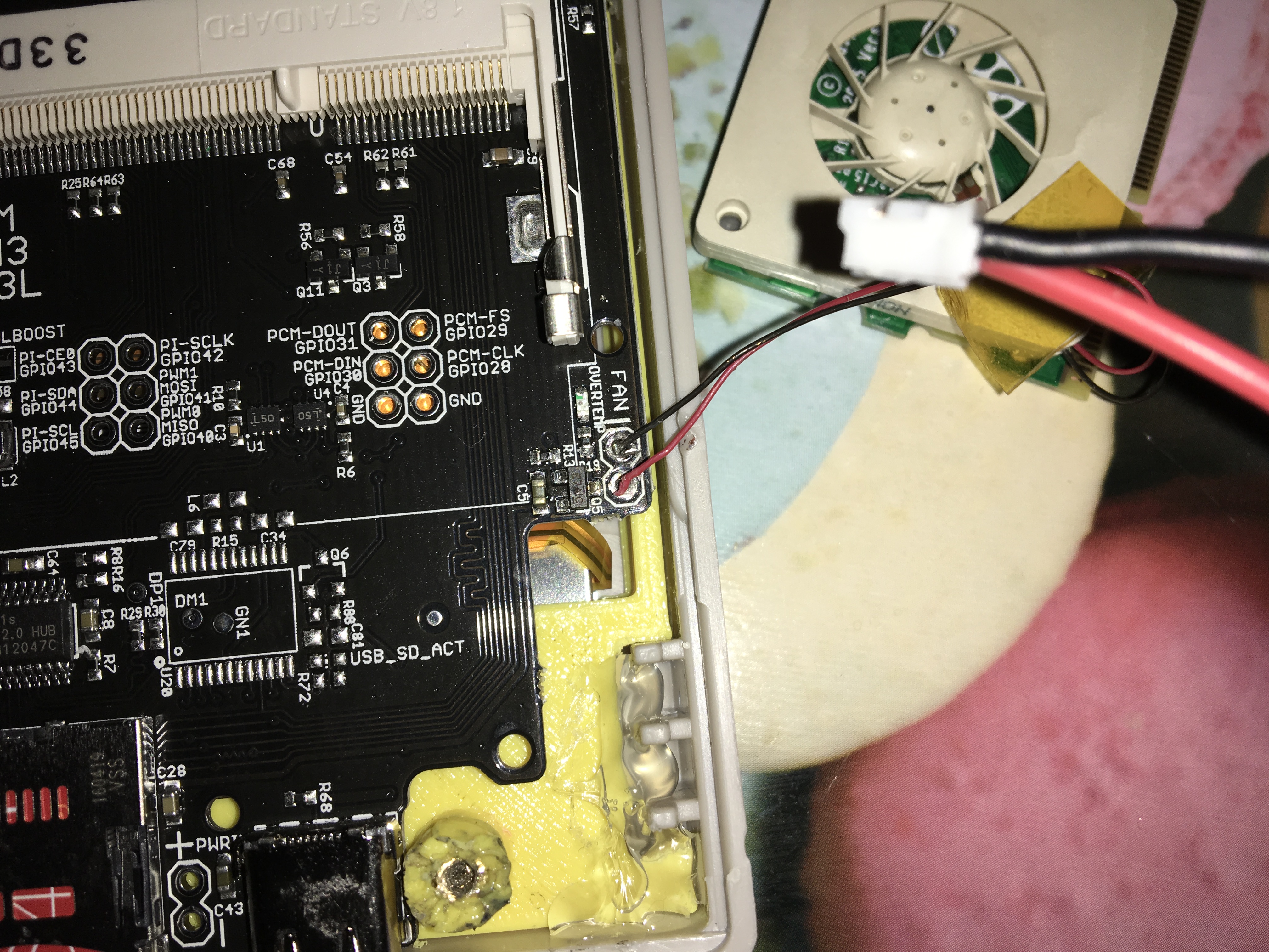

Could you remove the CM3 and take a picture of the area around that RED LED (with the board off), i'm interested in the black chip thing with 3 legs. Ideally if you can get the photo nice and bright and in focus :)

Post by DaveyD » Wed Feb 14, 2018 3:55 am
Hope this helps
kite
Posts: 972
Has thanked: 246 times
Been thanked: 361 times
Post by kite » Wed Feb 14, 2018 4:11 am
Great picture thanks.
In your picture, the resistor R13 ... the right hand side of it.. is is possible to get everything running (booted) and measure the voltage of the RIGHT HAND SIDE or R13? You may need some pointy probes and to scratch the surface a bit (as there is usually a film of sorts on the contacts).
R13 is the resistor on the left of that little cluster of components. R19 is the one right near the edge of the board (not interested in that one)
There is a slight mark on that black chip, does the chip get hot? Did you short the output at any point by accident? Like the solder on the other side of the board could it have touched anything metal?
