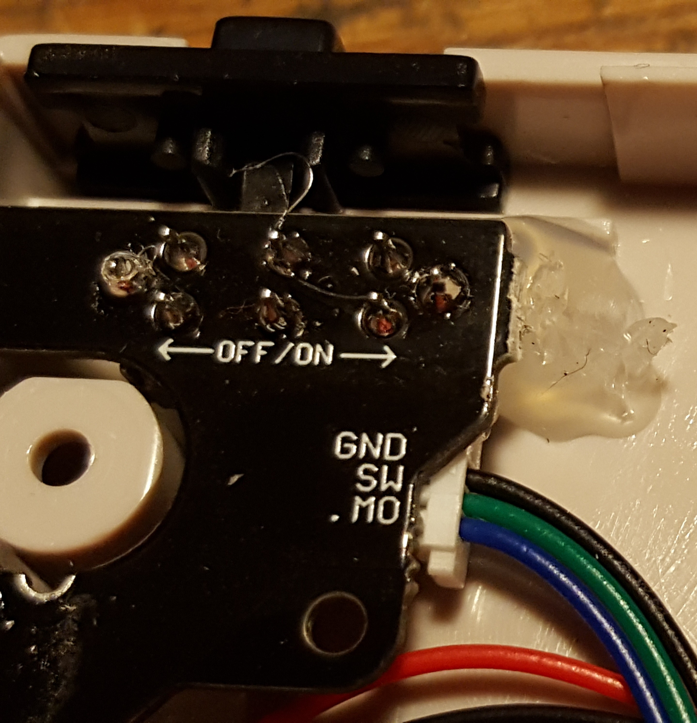

It turns out that the little screw post on the power and mode switch was pressing on the fan when the case was screwed closed, messing it up and making the motor not spin. I snipped it off with flush cutters and the problem was solved.
There used to be a screw hole above that glob of glue!Show
power and mode.jpg (1.11 MiB) Viewed 2825 times
