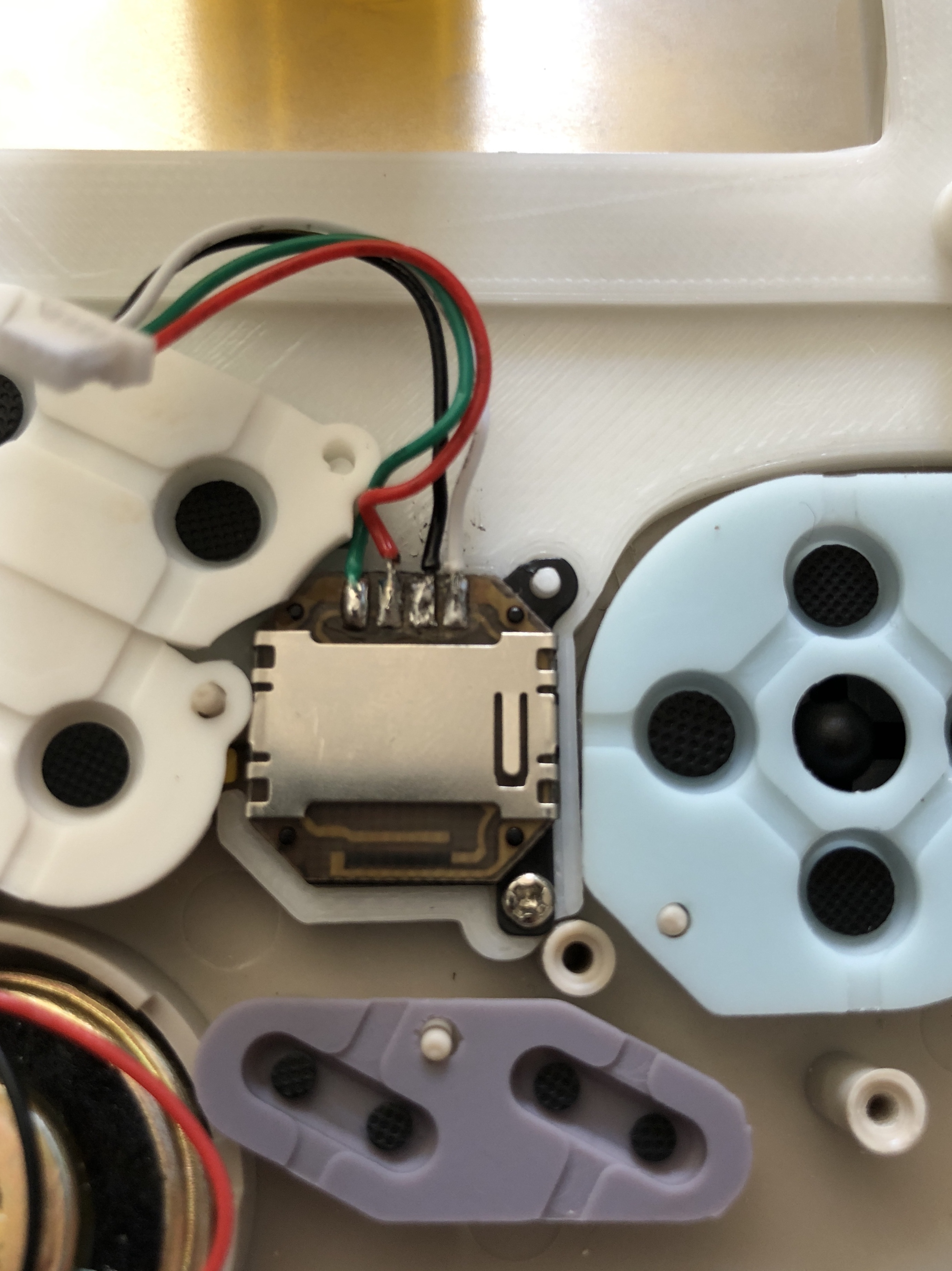

Hi everyone.
I have a problem when calibrating the joystick. I use a PSP 1000 joystick, and even though I recognize it correctly backwards, for some strange reason, the diagonal “down and right” does not work. I have calibrated the joystick 1000 times doing what the manual says, but the truth is that I work well all the directions except that indicated.
PS: I have tested with two joystick to rule out that it is defective. And I have also tried to calibrate it outside the case and I can not find any solution to the problem. This happens to me with Nintendo 64 games, I have not tested with any other platform.

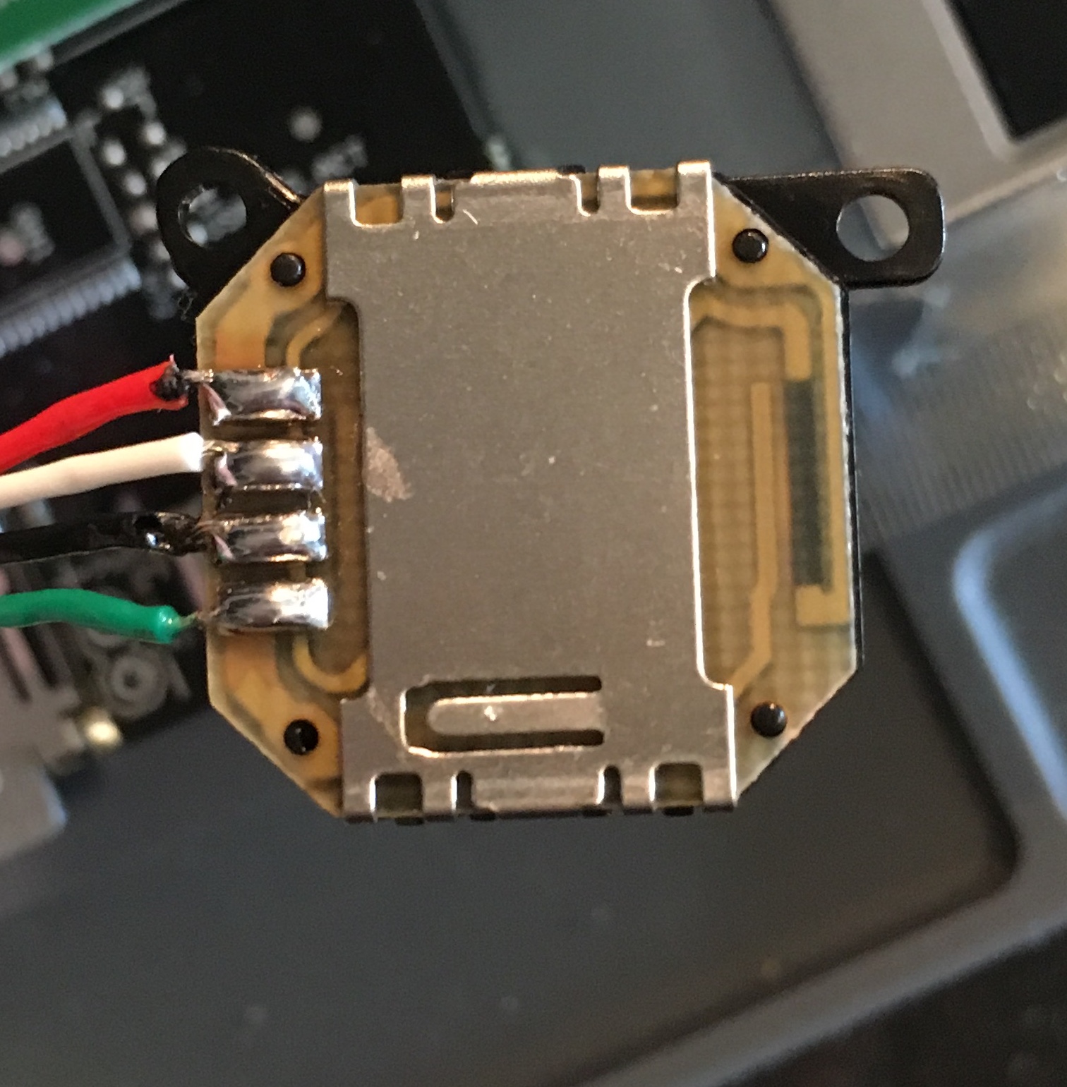

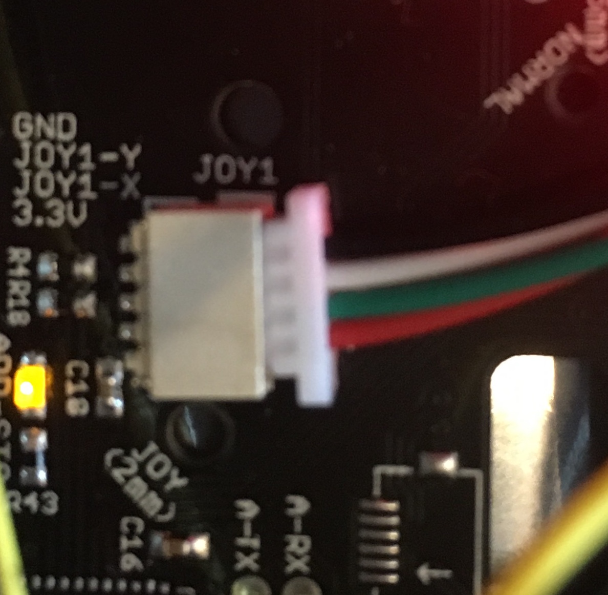

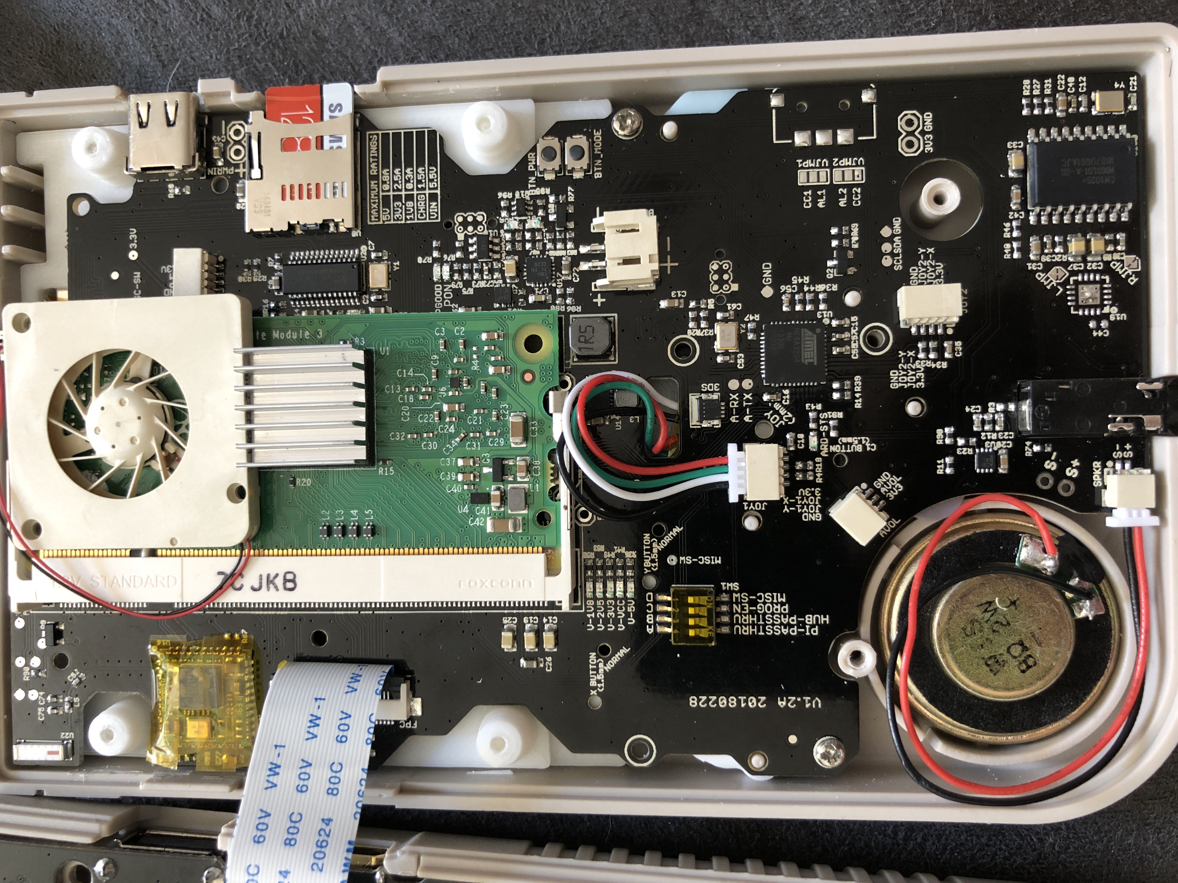

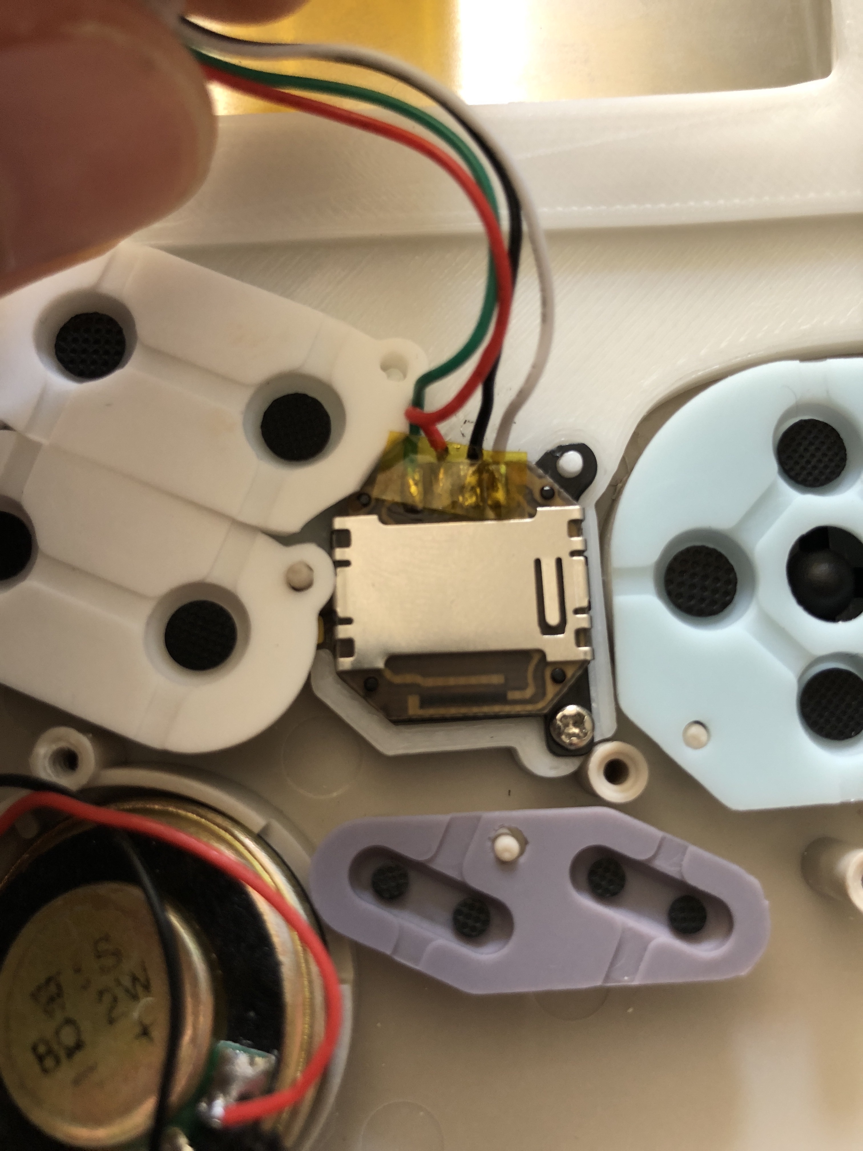

Lastly, a picture of how you have soldered it to the joystick and to the CSO
And what I'd like you to do is leave the joystick in 'idle' position, and run the configurator .. and each time you just press ENTER it will refresh all the data shown to you.. so i'd like to you move the stick in UP, DOWN, LEFT, RIGHT (pressing enter each time) and recording the value it outputs. And then also do the same for UP-RIGHT, DOWN-RIGHT, DOWN-LEFT, UP-LEFT. So to reiterate .. run configurator, record values, hold joystick UP, press ENTER, record values, hold joystick RIGHT, press ENTER, record values..... etc for all the 8 possible directions!
The information i'm interested in is the "JOY 1 enabled: 0 - (X: 901 Y:0)" and specifically the X and Y data.
With all that I should be able to tell you what is going on! Those values are the RAW values that the arduino see's, and not what it outputs to the pi.

Re: Circuit Sword Joystick calibrate.
Great that's exactly what I was after!
Your joystick is wired up incorrectly. See the labels on the connector, it says that
RED = 3v3 (vcc)
GREEN = X (left/right)
WHITE = Y (up/down)
BLACK = GND (ground)
Here is the correct pinout:
Wire them up to the corresponding pins
Also, your fan isn't pointing at the heatsink
there is a little arrow on the fan.. but basically where that gap is on the side of the fan, that's where air comes out from!
RED = 3v3 (vcc)
WHITE = Y (up/down)
Indeed, that was the problem. Now everything is solved.
Thank you very much Kite, excellent work!
