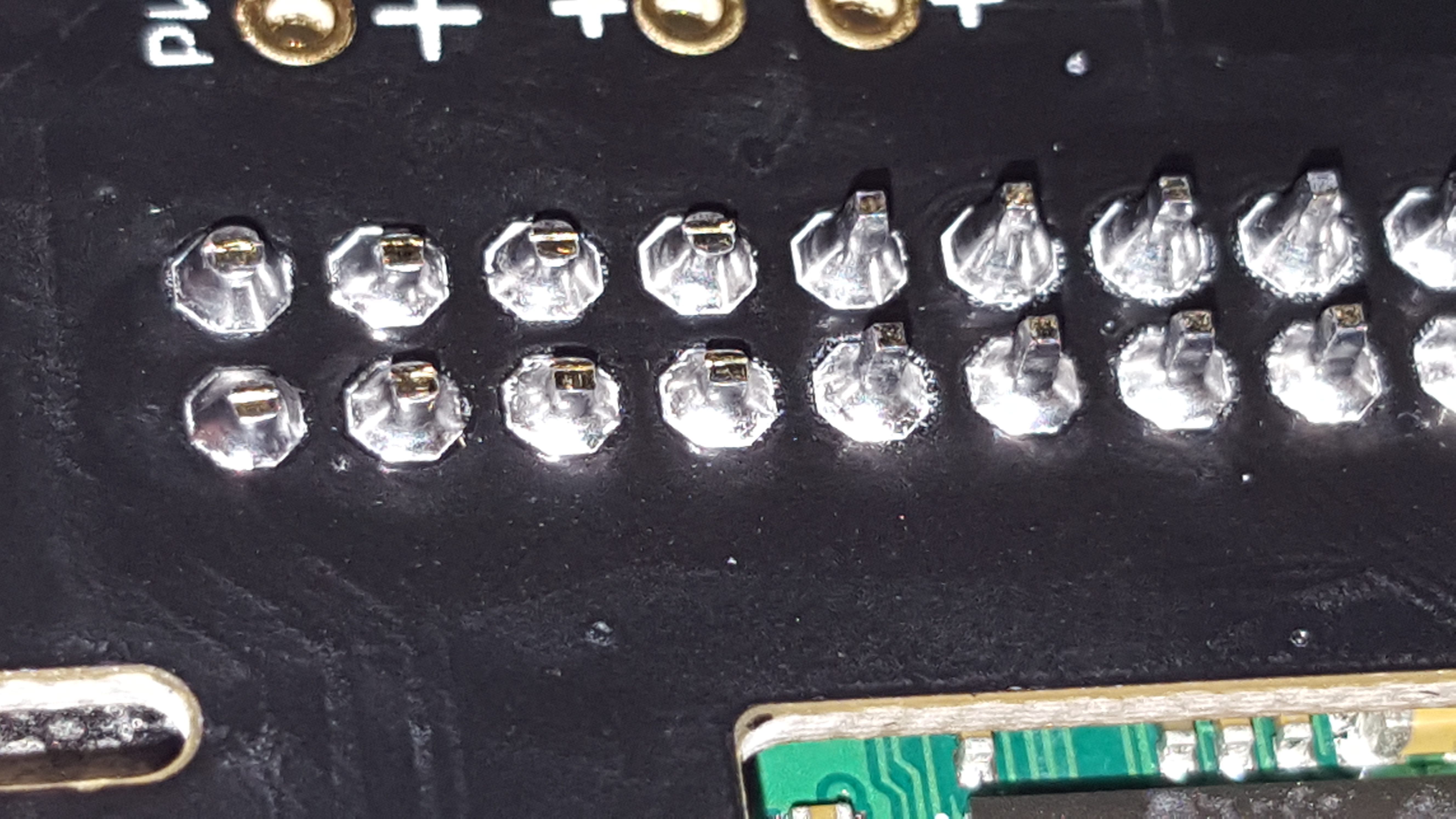

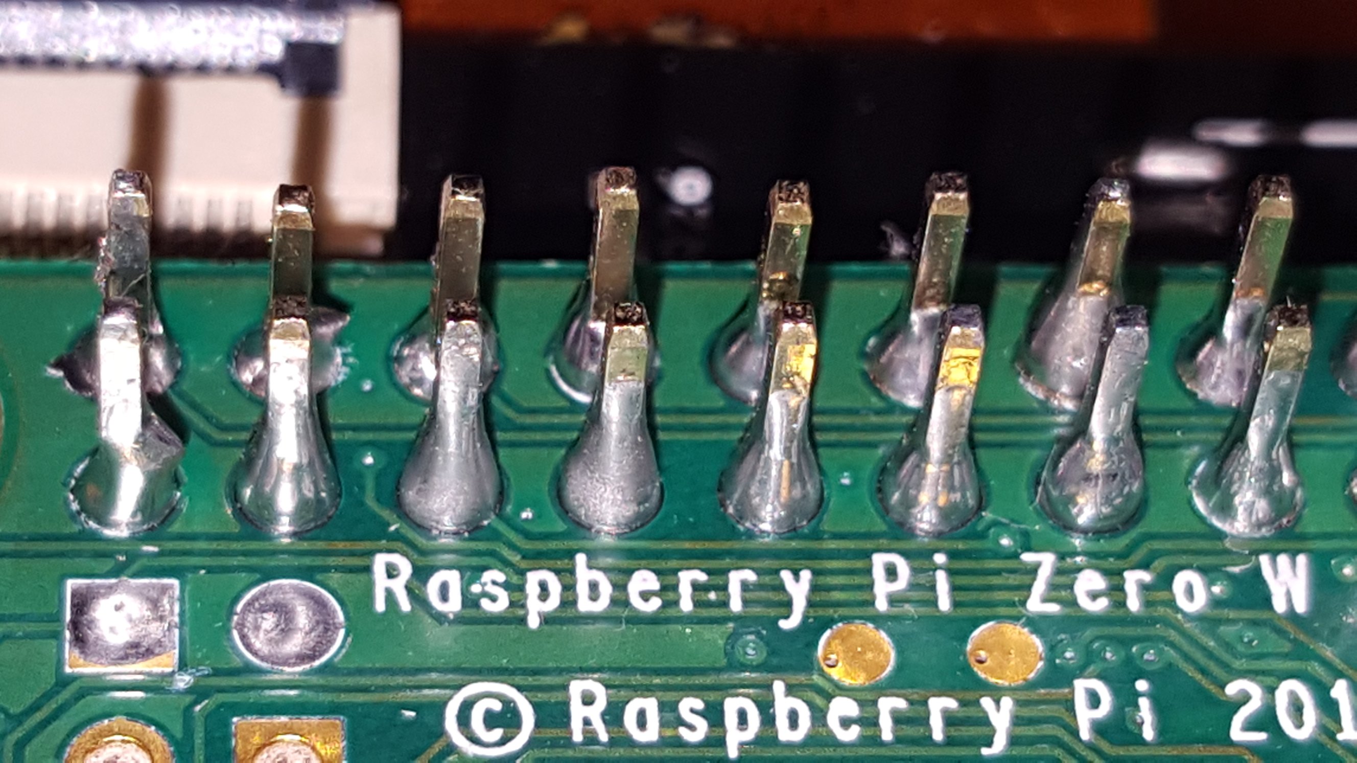

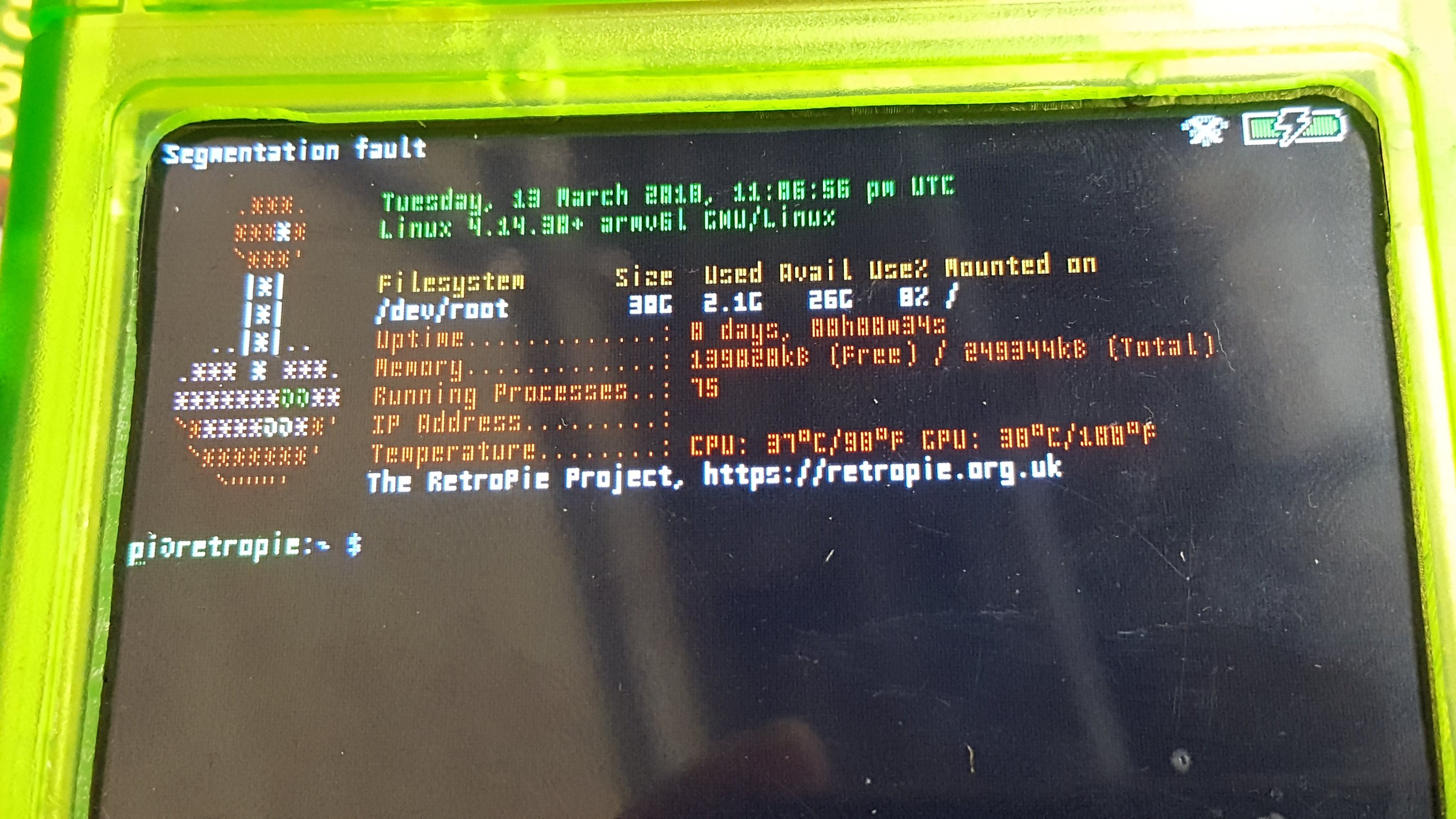

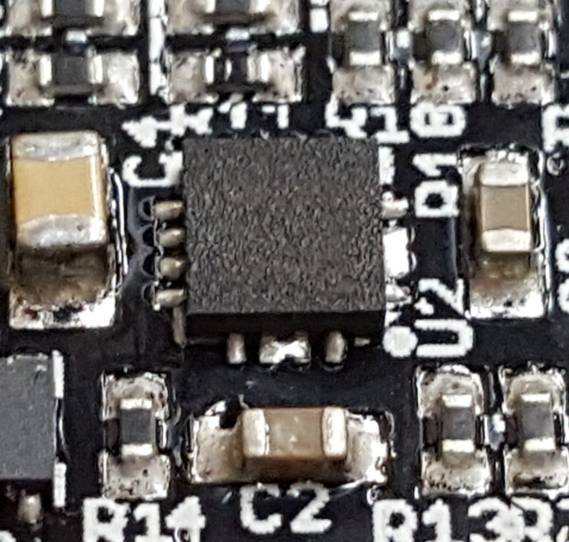

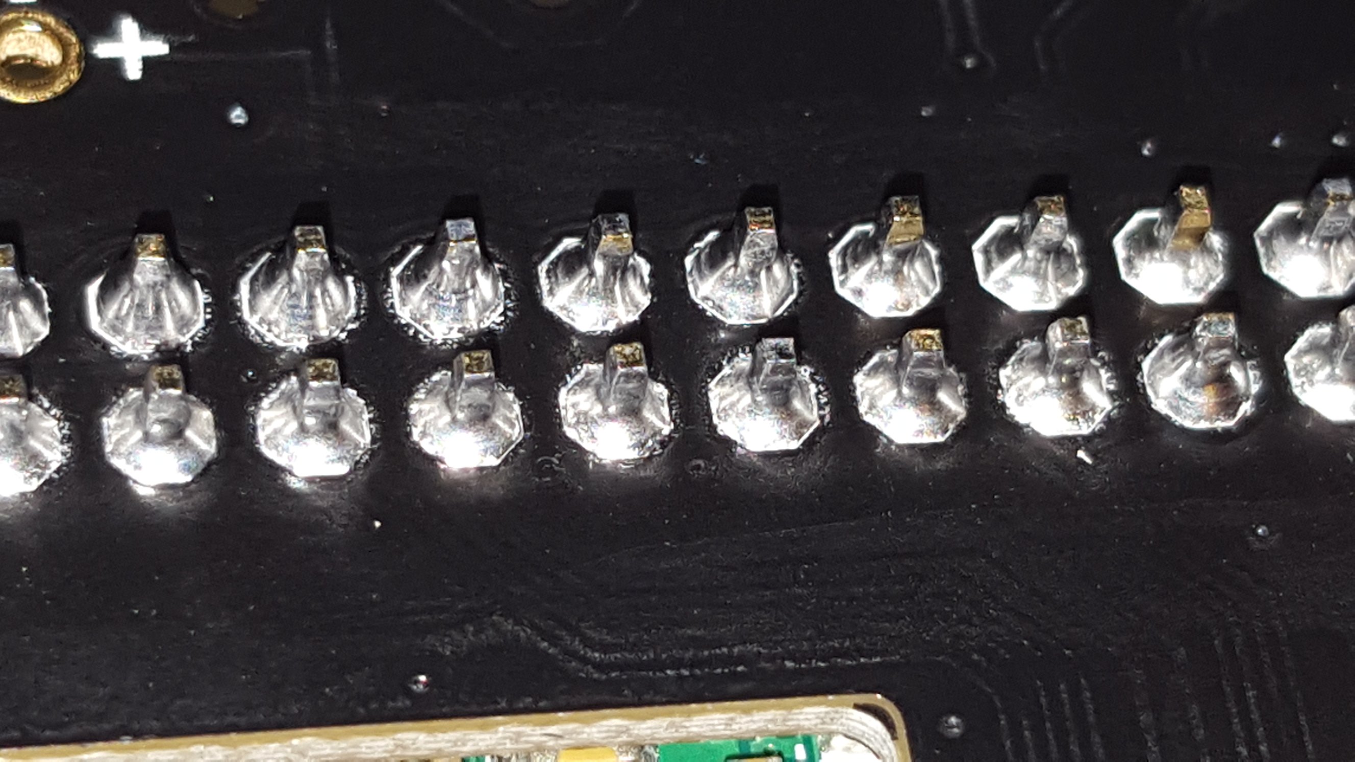

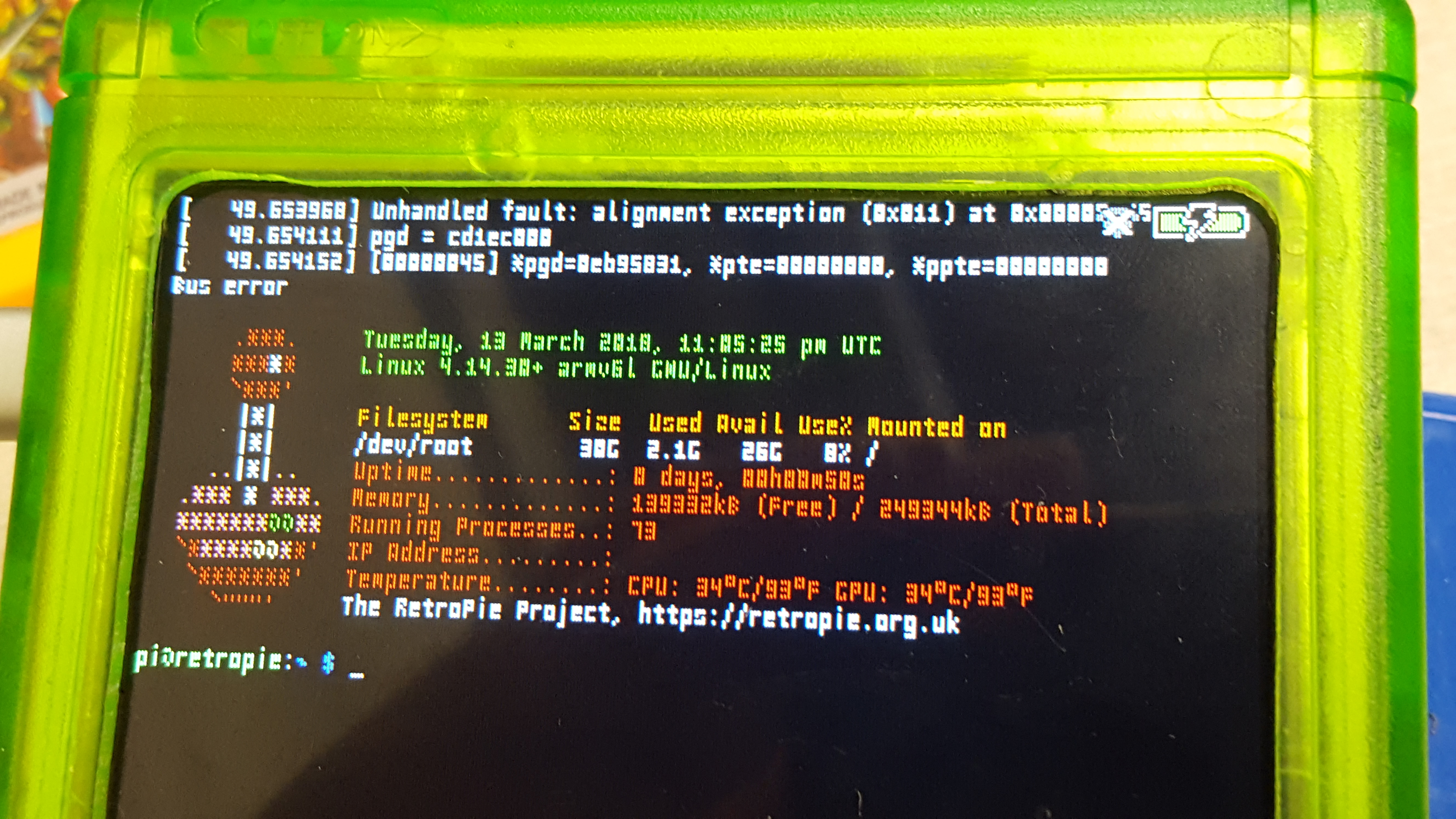

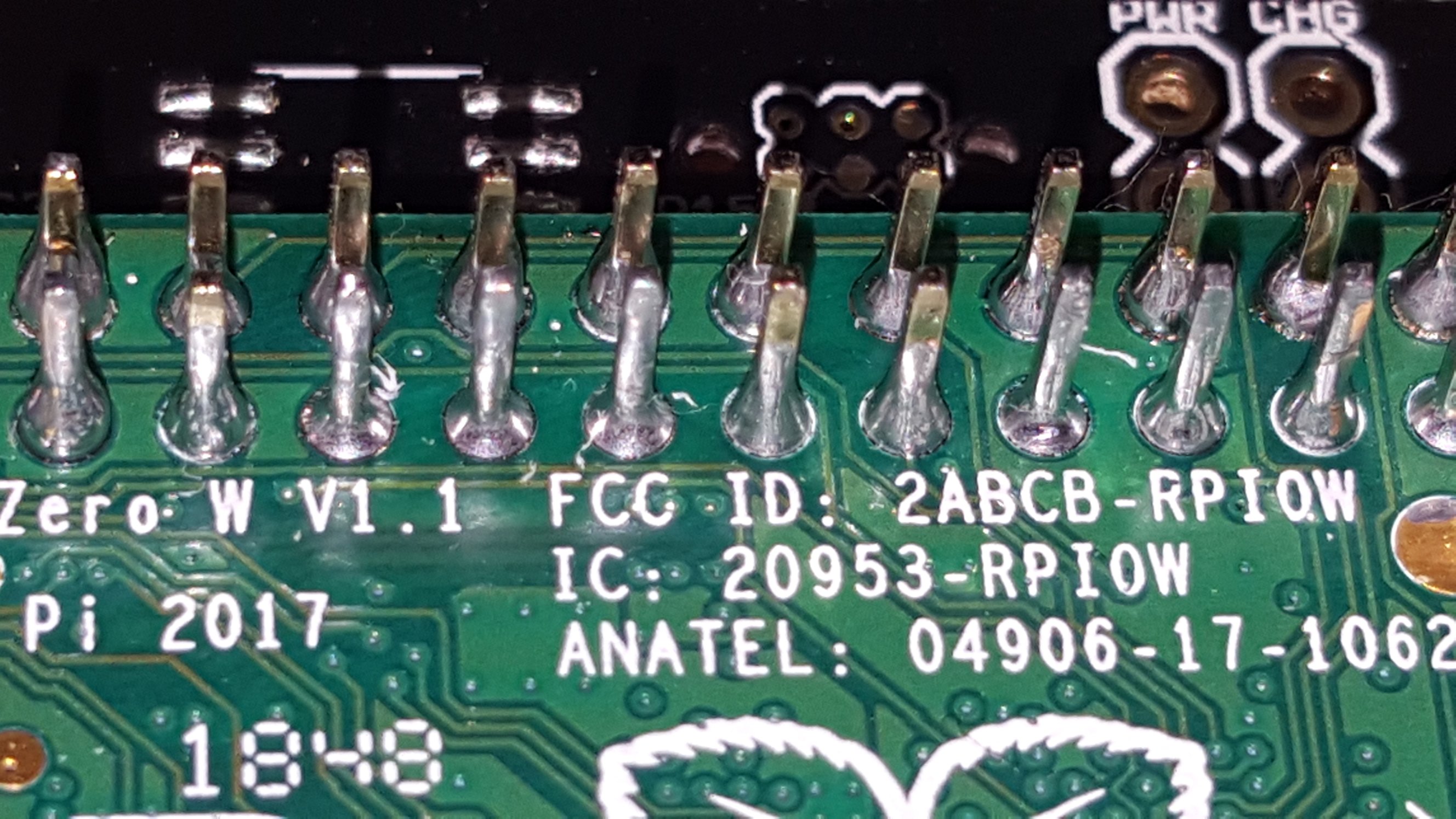

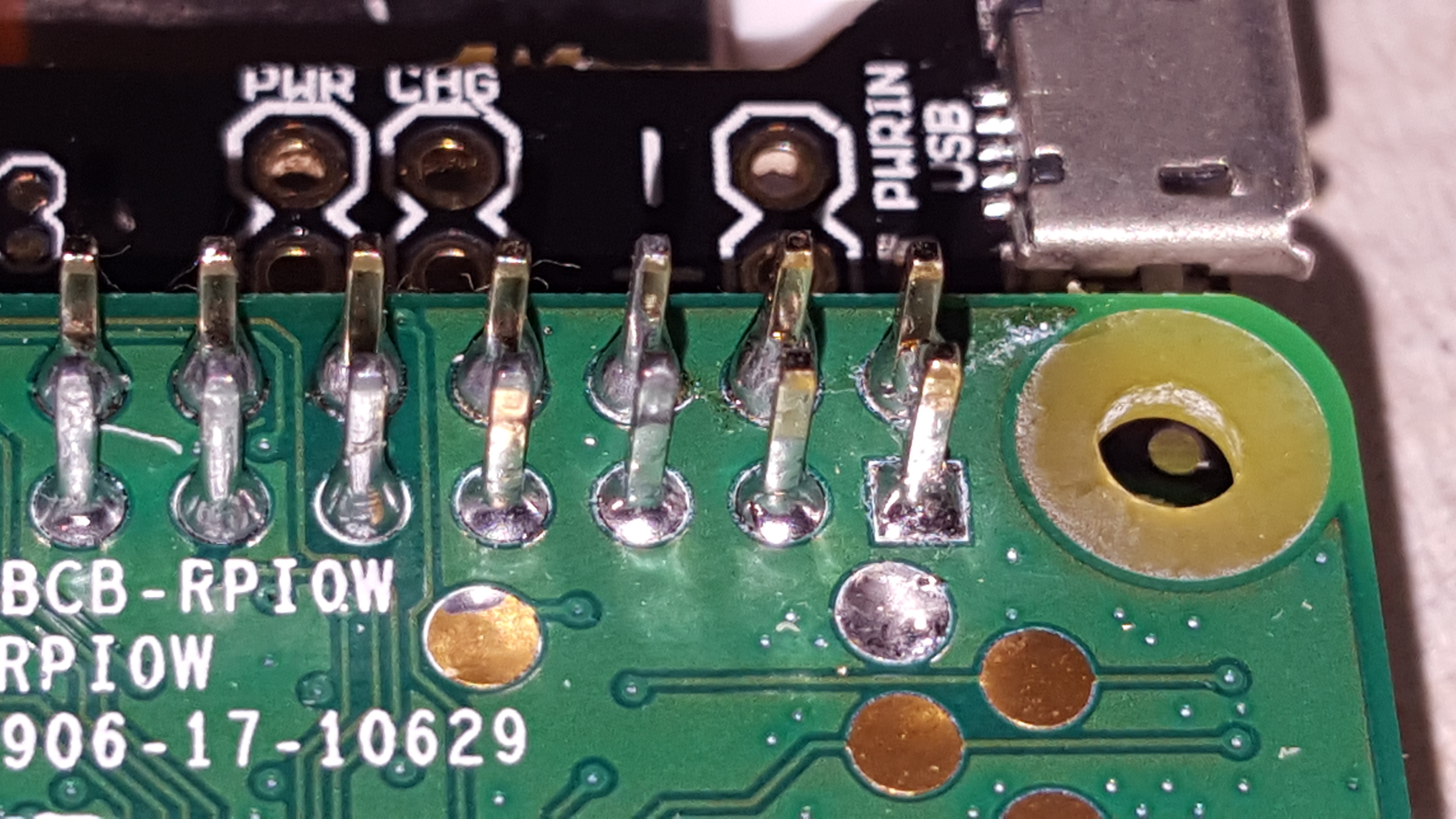

So I just got my circuit sword lite put together, but when I try to configure the buttons I get a segmentation fault or a bus error, or it just freezes. I pulled everything out of the case and I still get the same errors. I also found a tiny solder bridge on a chip. When I get home I'll try a different sd card. Here's some pictures of the errors, my soldering job, and the solder bridge.
Faults
fault 1.jpg (3.22 MiB) Viewed 8012 times
fault 2.jpg (618.26 KiB) Viewed 8012 times
fault 3.jpg (3.38 MiB) Viewed 8012 times
Soldering pics
Solder Bridge
solder bridge.jpg (241.51 KiB) Viewed 8012 times

All looks alright, can you get a NEW SD card, or a different one (but a brand new one ideally) and re-burn the image and try that please?

hm, did the pi work before you hooked it all up?
And to confirm, this is using the LITE image right? https://github.com/kiteretro/Circuit-Sw ... e/releases
What might be worth doing is getting the stock image, and then copying the 'config.txt' from the CSLite image onto the stock image, this will allow the internal screen to work. Not much else will (sound, input, menu, etc) however if it boots all the way up, then that's a good sign!

It's still the same. It boots up fine and starts emulation station and then asks to configure a controller. Once I start pushing the buttons I get the error. I also plugged in a usb controller and the same thing happens when I try to configure that.
